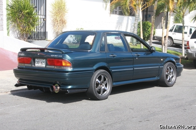

Wow...mods and general setup of your GVR4 is superb! /ubbthreads/images/graemlins/applause.gif

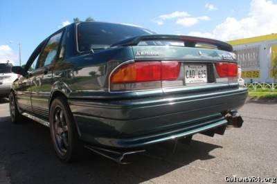

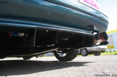

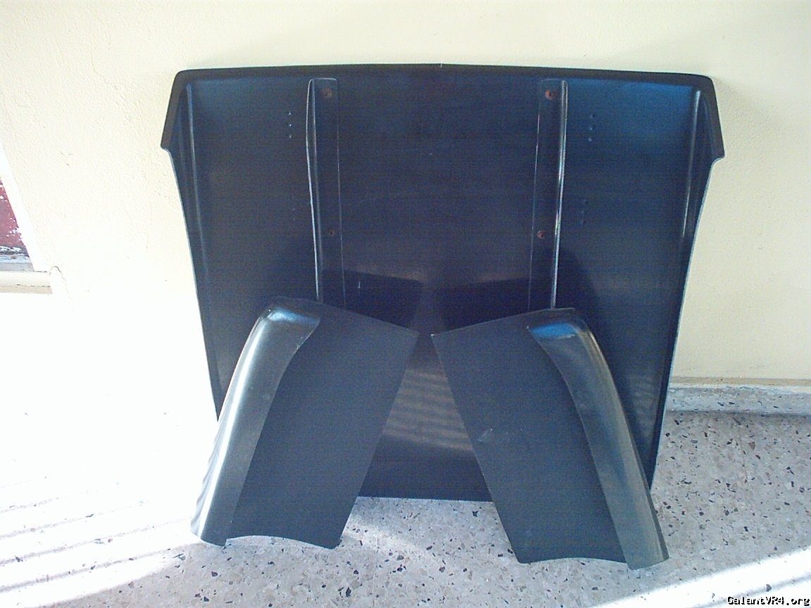

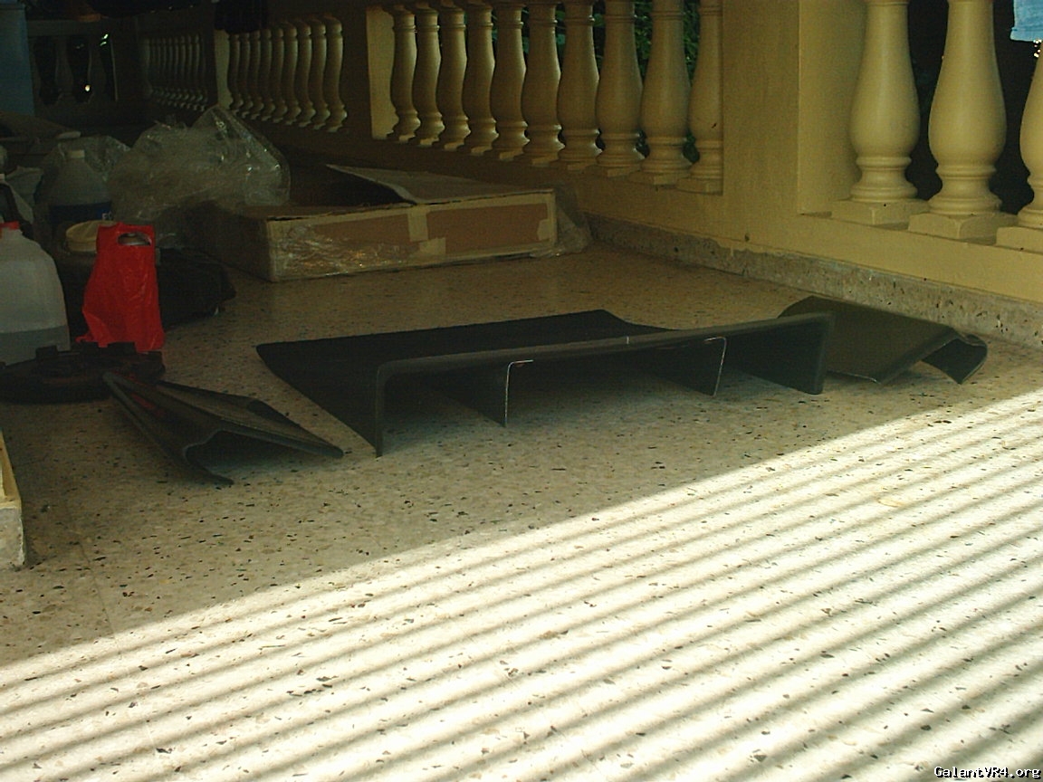

I am assuming you are going to install those rear diffuser pieces on the GVR4. I am curious to see the final install pics. The GVR4 looks great...its clean and sweet setup! /ubbthreads/images/graemlins/cool.gif

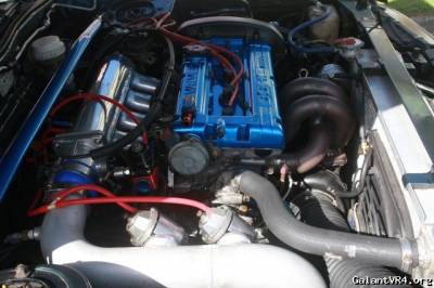

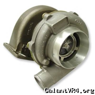

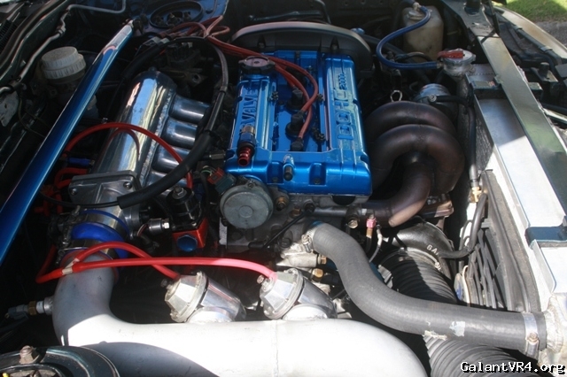

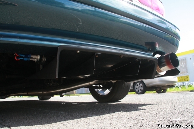

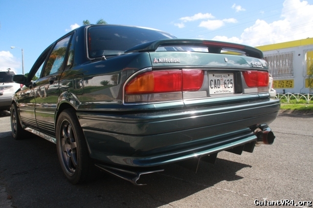

New updates gt30r /Varis rear diffuser
Dyno 440HP 435TQ 18.5 PSI 10.8 a/f on pump gas

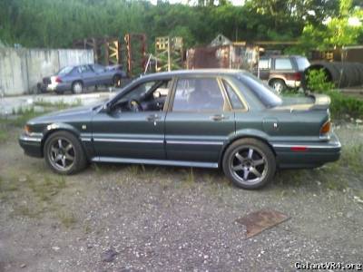

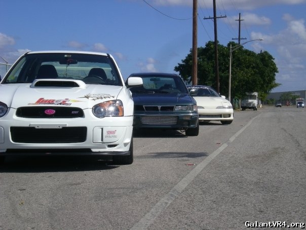

This is why PR is so badass, I love this picture.
In SC There was an article written by Al Friedman, of Dynoflash.
He was interviewing this PR tuner named Gadiel who built this STi that went 10.0's
Anyways, the car was built on a dirt-floored "Shack" of sorts.
Dirt floor + Sti = 10's in the 1/4mile /ubbthreads/images/graemlins/jawdrop.gif

What exactly is a GT30R? I would have thought it was a GT3082R (which I think it is in these parts) because GT35R = GT3582R but that shrouded compressor housing looks like a GT3071R or GT3076R.
Dialcaliper
Jun 22, 2007
1,303
Bay Area, CA
GT30, GT35, etc is the turbine design code - 71, 76, 82, etc is the compressor wheel diameter, and R is ball bearing center.

GT3076R .82 AND WORKS GREAT!!!!!!!!!!!! /ubbthreads/images/graemlins/worthy.gif /ubbthreads/images/graemlins/worthy.gif /ubbthreads/images/graemlins/worthy.gif /ubbthreads/images/graemlins/worthy.gif /ubbthreads/images/graemlins/worthy.gif
