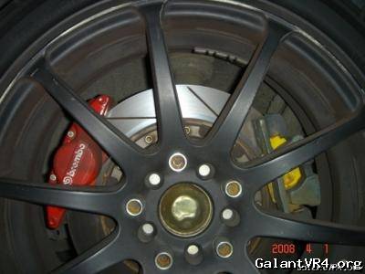

These are what I was wondering about..
Found some more info. its a bolt on affair for 2G dsm.
So now the question. How hard is it to make 2g rear calipers work on our cars, if possible at all
as far as bolting on goes, dust shield, break rotors, lines yes they will be different
I believe the reason they are bolt on for 2G DSM's is because the 2G's have the drum setup for the parking brake. Making these EVO calipers bolt to a GVR4/1G would be no big deal, it would be easy to fabricate a bracket to make them bolt up perfectly (if they don't bolt up already.) The problem is that you will no longer have a parking brake.

Quoting belize1334:
^^ He's got a secondary caliper on that which serves as the e-brake.
So they will work, accept no E brake then..? I want to just buy it and try, but dont want to be stuck with them
