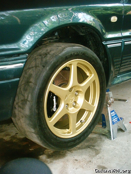

Has this been done yet with success? I would love to have EVO brakes and wheels on the Galant but would like to buy spacers and have it walked-through.
On 2g's the rears are bolt on, the front ones you just have to switch to a 00' JDM galant sterink knucke, and its a bolt on affair.
I have not seen anything on 1g's yet..
Definatly looking forward to seeing this wright up!

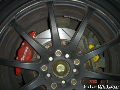

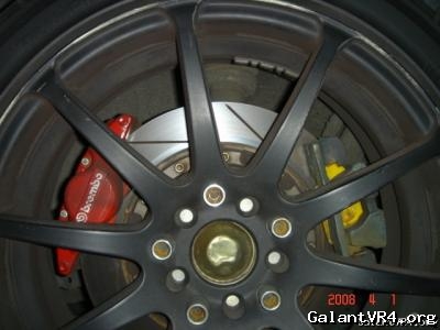

I HAVE EVO BRAKES ON MY VR4 AND WORKS REALLY GOOD MY BRACKETS ARE CUSTOM MADE
FOR THE REAR I PLAN TO USE MAYBE THIS SETUP
FCR. Ever thought of having somenoe make more replicas of the front brackets you have?
Also, How are the rears done?

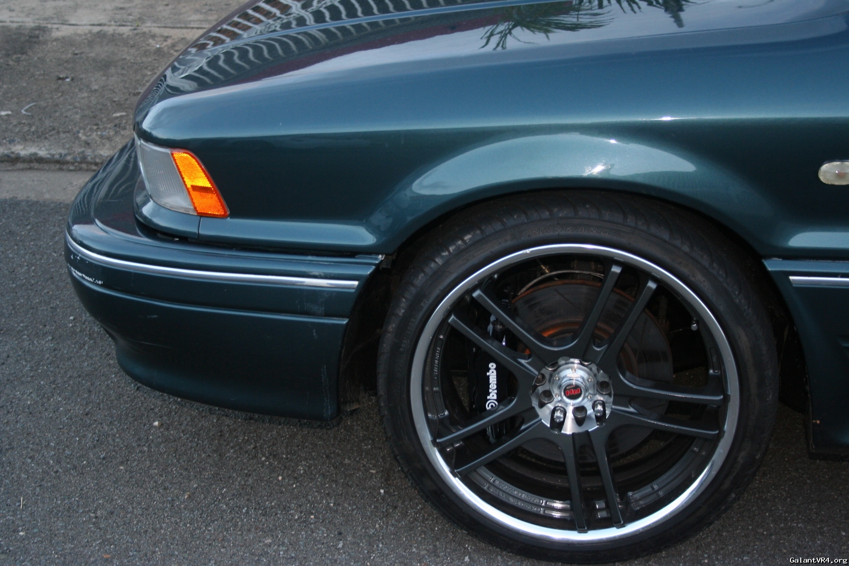

has anyone look at changing to a 3g eclipse ball joint and 3g knuckle thus making the brembos bolt on for the front. i know the ball joints will need to be turned down almost 2.5mm but other wise should be able to be installed into our control arms. my biggest worry in the splines for the axles and weather they are the same or if custom hybrid axles would be needed.
I agree with Erik on this. Doesn't make much sense to source a knuckle and modify ball joints when you can easily fabricate, or have somebody else fabricate, an adapter bracket for any caliper. Dealing with possibly multiple difference in knuckles (strut to knuckle alignment, tie rod fitment, ball joint fitment, axle shaft spline count, etc) just to make a caliper bolt on? Lots of people on this board are using 3000GT, Camaro, Corvette, and other calipers with custom brackets and I don't think anybody has had trouble with them. IIRC, Wilwood makes an adapter to mount their calipers on our cars. The car I'm building used to have Porsche 996 front calipers with a custom made bracket. Now those are some calipers! (Too bad I couldn't afford what the seller was asking for them.) You can put together a killer brake system without spending a ton, or having to modify things much at all. Look up the how to post Curtis made about using an Infinity master cylinder as an example.
*EDIT: I see now that brackets have been discussed in this thread, I think I confused this thread with another one somewhere...anyway...I vote for brackets over swapping knuckles.*
11,009
Changing knuckles is just a bad idea, especially from different generation vehicles. Unless you are a suspension geometry expert, you run the risk of completely throwing off your steering and handling using parts not designed to work with each other.
