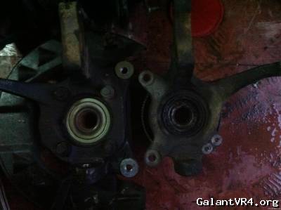

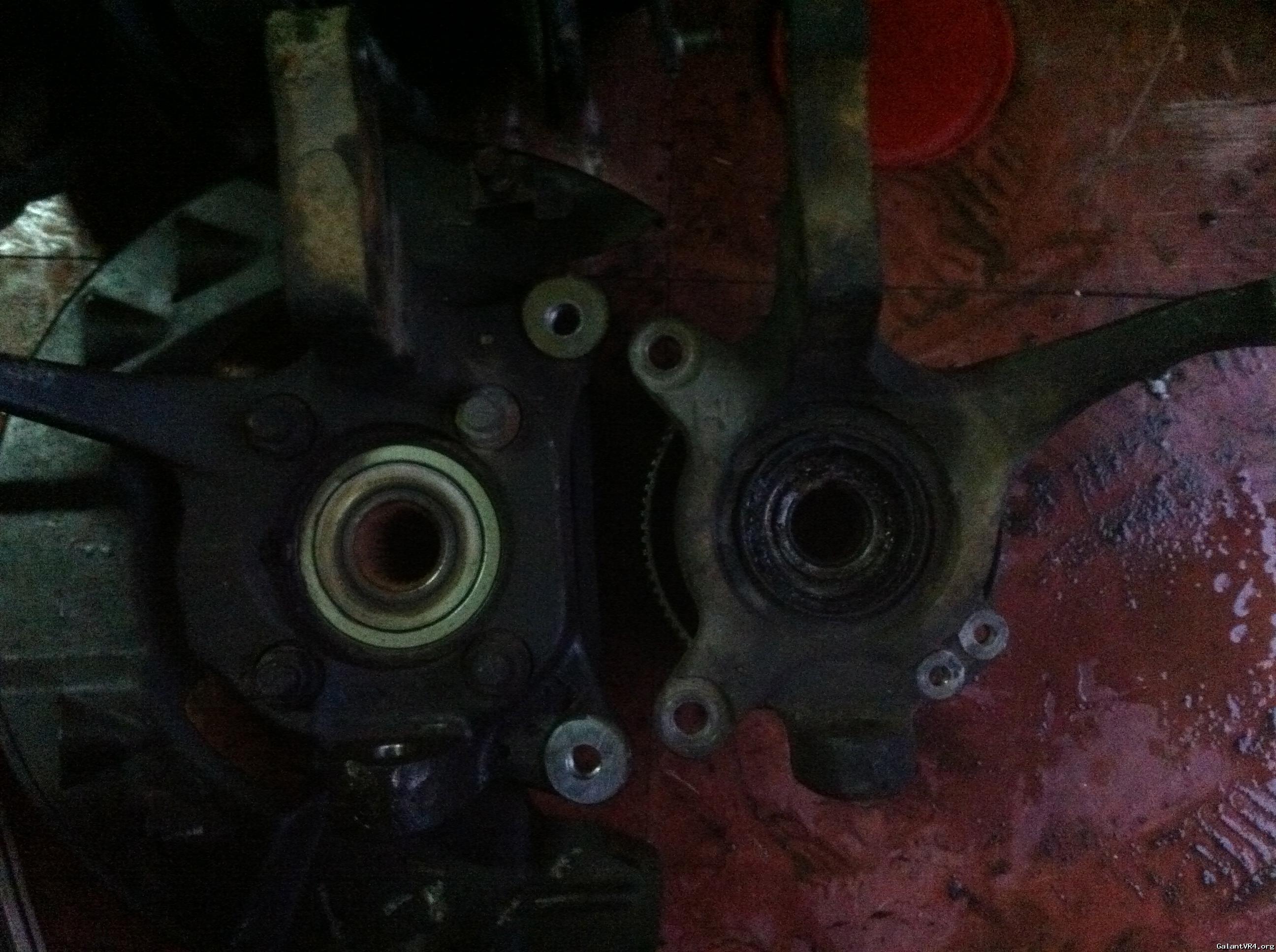

anyone know if the 3000gt/gto front knuckles fit?they look very similar execpt the axles are a lot bigger and the bearing are different
or if the 3000gt/gto has the same distance of mounting tabs as the evo brembo?
had them side by side and it looks like it will work if i get around the bearing problem.
