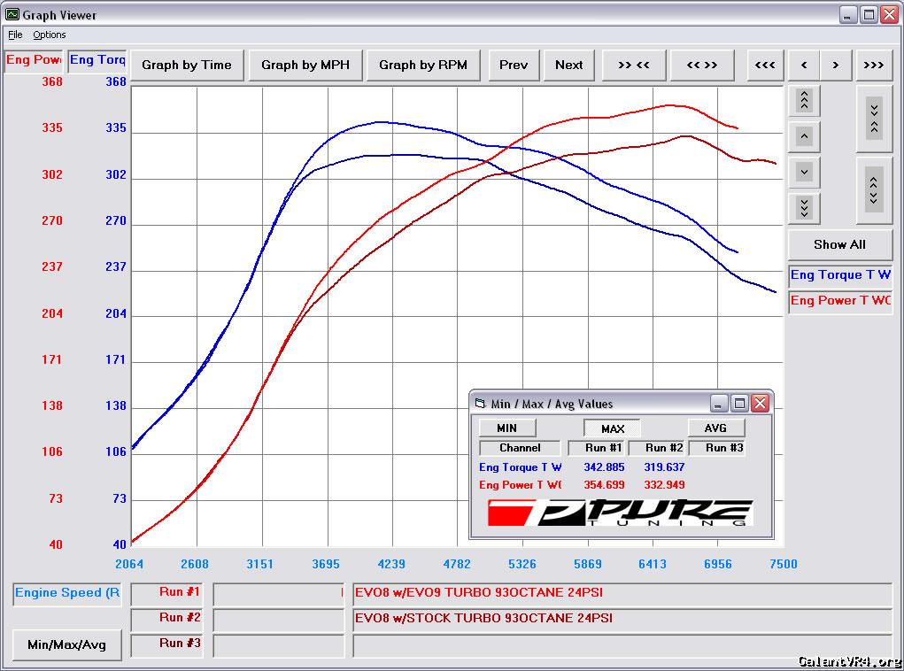

Here's an Evo 8 fitted with a factory 16G6 and then an Evo 9 16G6C turbo. I don't know if it's a GSR, MR or RS turbo so the nozzle area could be 9.8 or 10.5 for the 8.
Somewhere between 326 and 340 wheel HP is around 400 crank HP. So pretty decent numbers there either way.

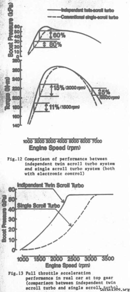

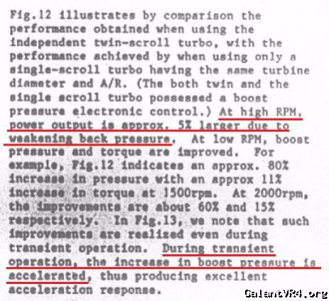

Apparently Mazda has been using twin scroll since the late 80's - the RX7 series 4 was single scroll and the series 5 twin scroll.
This is purportedly a Mazda test from around 1980 comparing a single vs twin scroll housing of the same turbo (unspecified) on the same engine (unspecified)
Figure 13, when it's actually road tested is pretty astounding.

Where the heck did you find that little piece of history? If that really is a test performed by Mazda, then who can argue? The theory makes sense, and apparently there are significant (and real) results. Thanks for the links /ubbthreads/images/graemlins/laugh.gif

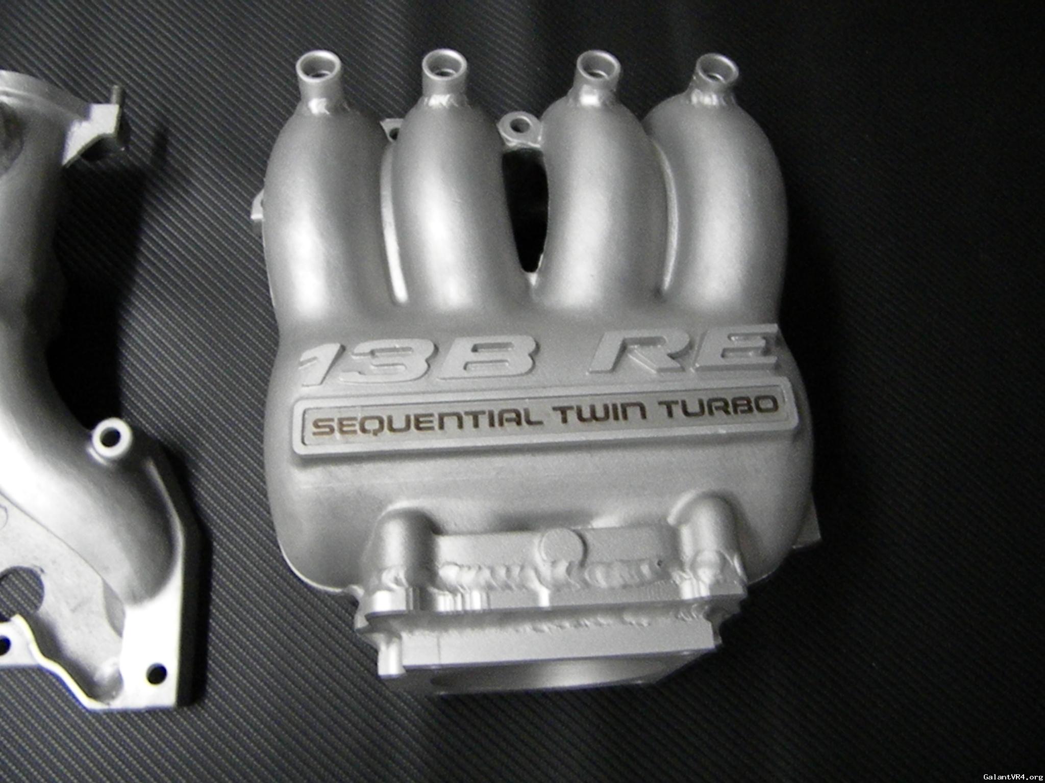

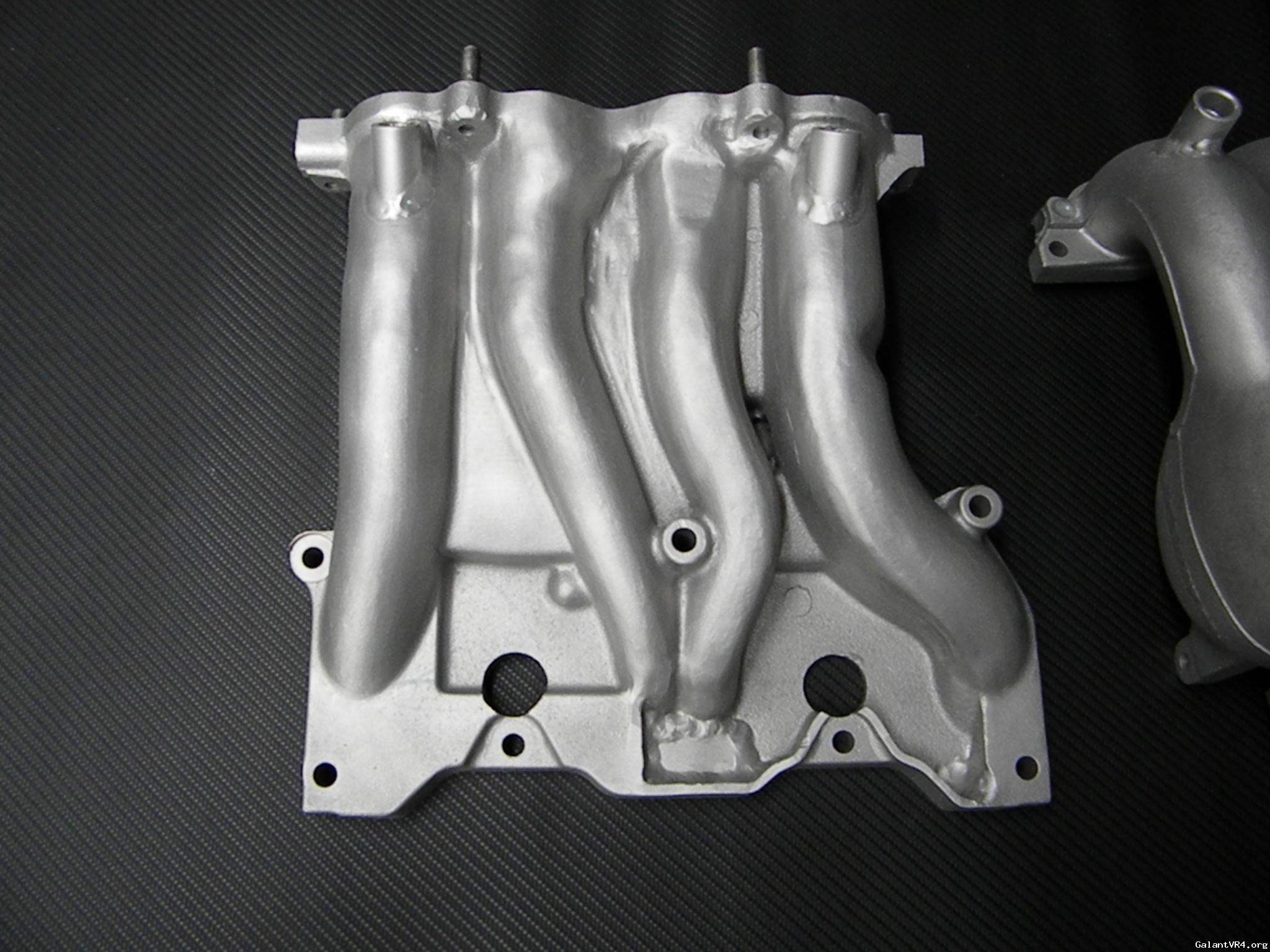

Take care when comparing data from rotaries to piston motors.
They do things totally different. I had a crash course in this a few weeks ago with a local buddy. I've known how they work for years but had no idea to the level these guys can take them. He's building a 71 corolla with a 13b, yes he's Puerto Rican its in there culture I guess maybe just in there genetic make up but he's on the way to having one of the fastest import within 1000 miles of here, his buddy set the track record back last summer with a .8 60ft.
video one
click me video 2
As you can see there's injector holes everywhere and there all going to be huge including the primaries on the engine itself. I think when all 10 are added together along with the large meth nozzles he'll be spraying around 16K cc/minute with a mechanical pump. I still have to weld on the peripheral port covers and the runners are already cut open for them but not in the pictures below.
My buddies did his 25.2 chassis if this crazy stuff interests you
click on the orange 71 in the 2nd picture
Oh and he's a GI so this is what your tax dollars can do when properly applied. /ubbthreads/images/graemlins/grin.gif
