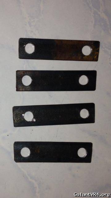

I had some free couple of hours so i visited my friend and worked on a pair of evo 8 front struts.

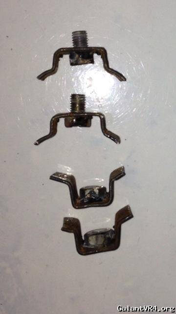

I've read some stuff here regarding the brackets that hold the brake lines, didn't really want to follow the route that was shown in the guide so I did these..
I'll be welding these on the strut body.
I also did the spacer thingies..
Will be finishing these off and install the evo 8 struts by next week. Days off work, like pay days, don't come soon enough. /ubbthreads/images/graemlins/grin.gif

Your going to weld these to the strut body? /ubbthreads/images/graemlins/uhh.gif
That is very risky as struts really don't that kind of heat. That's why no one has done that before.

don't forget to post pics of your missing fingers after you are finished. this is very dangerous.

I made almost identical brackets, then cut slots in each of the tabs to feed a hose clo through to secure them to each shock.

Quoting prove_it:
I just drilled a hole in a hose clamp, slide a bolt through, then clamped it on. Worked fine.
Thanks for the info, i didn't know that. /ubbthreads/images/graemlins/banghead.gif

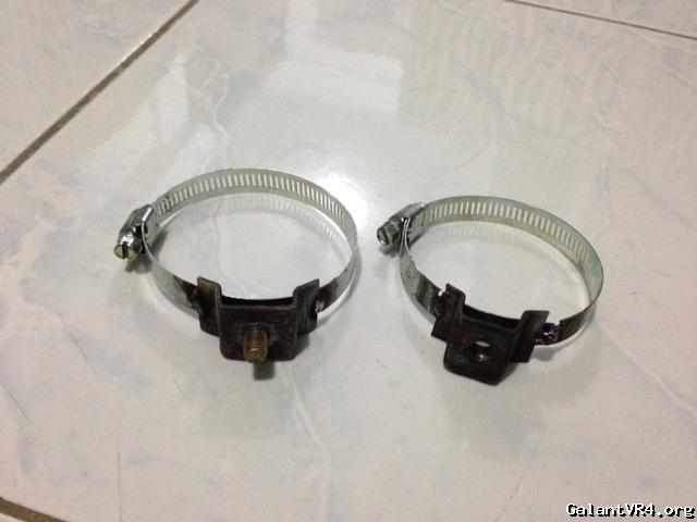

I originally got some clamps to do this:
But had 2nd thoughts about it. Maybe I can just have these welded on a hose clamp instead of sliding a bolt through.

Yes, much much better idea. Even when welding the bushings to the lower ears is considered risky. I had mine TIG welded, but even then my welder actually put the strut in a bucket of water with only the ears in the air. This prevented any heat reaching the strut.
