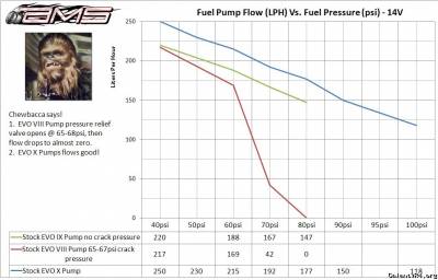

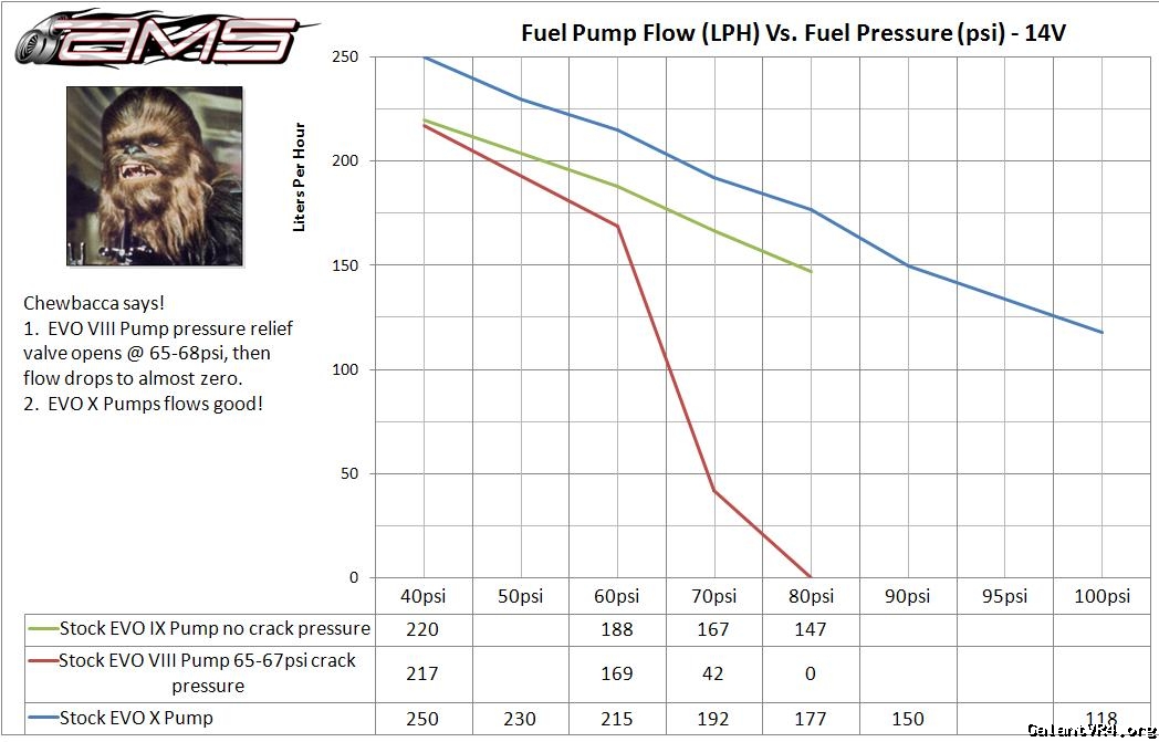

The EVO 8 fuelpumps have an issue with the pressure relief valve opening early, according to AMS testing:
Rewired, it can do 169 liters/hour, which means it *can* support 650's with no problem. BUT, once you exceed 60psi total fuel pressure (37psi base + 23 psi boost) the fuel pressure drops very quickly, so be careful.
The EVO 9 or 10 fuelpumps are a better choice, as you can see from the above graph.

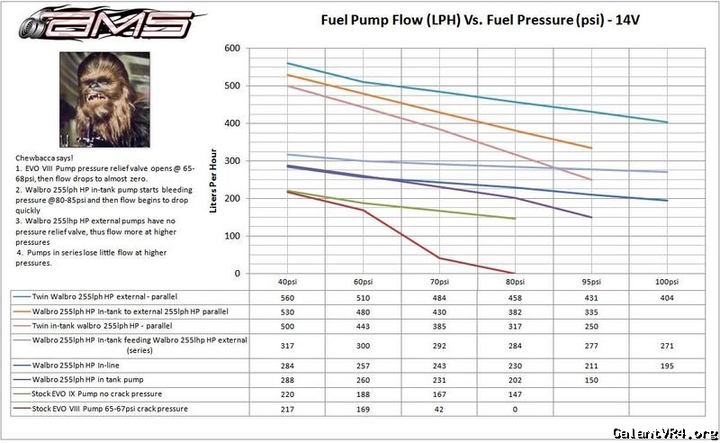

This graph also compare the EVO pumps to some Walbro combos:
Hey man thanx. I guess I'm going wally or EVO 9 Pump.. An it was free out of my old car, Had two of them.
OK looked at the graph and looks like the EVO 9 pump will be good for me I will not be pushing more that 23psi. But with the pump do I need a AFPR? Thanx for all the help guys.
