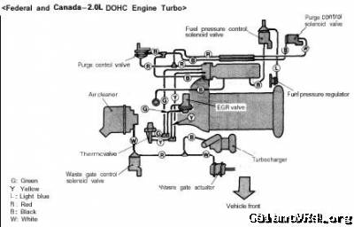

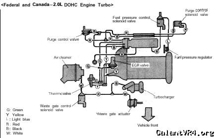

These diagrams are used for the 1g t/e/l however the layout is practically the same less a few solenoids which are in a different location. You can refer to your underhood diagram located under your hood or pick yourself up a cheap Haynes manual or search on google for further info. G/L
