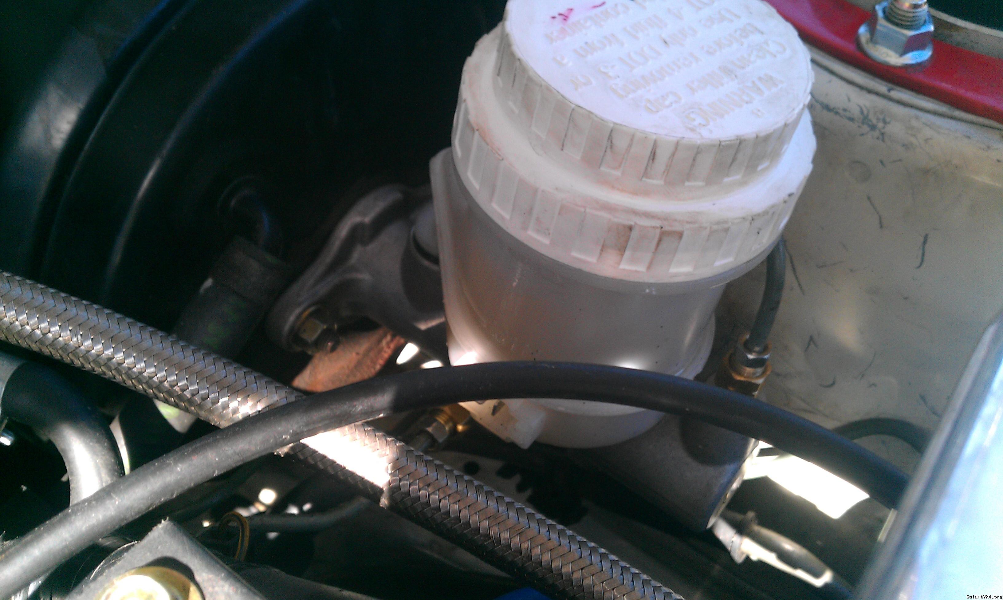

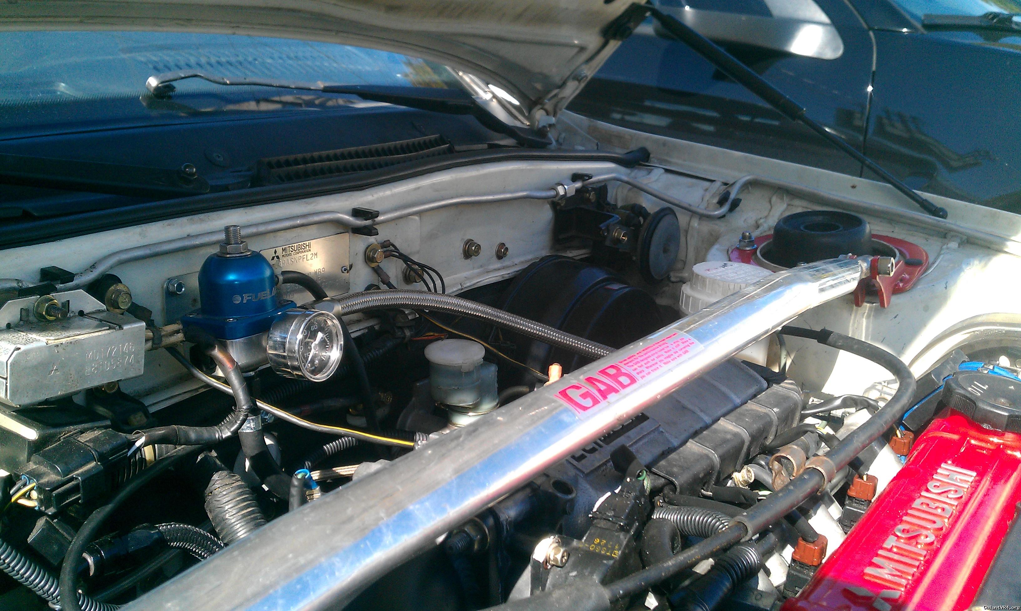

Just replaced the master cylinder from a 3g eclipse, didnt need to change the booster as you guys said. looks pretty good, lots more cleaner look aswell, Most important i have my brakes back. Also removed my ABS, Here are a few pics of the new master installed. Thanks for all the advice guys /ubbthreads/images/graemlins/worthy.gif
strokin4dr
Aug 30, 2005
2,773
Savannah, GA
How close is the reservoir to the strut tower? Is anything touching or is the clearance all around? Looks good to me from what I can see.
