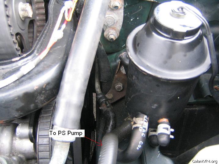

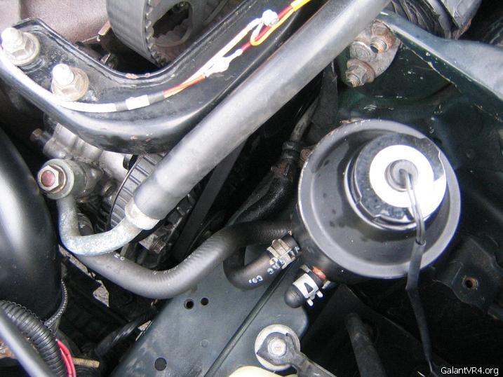

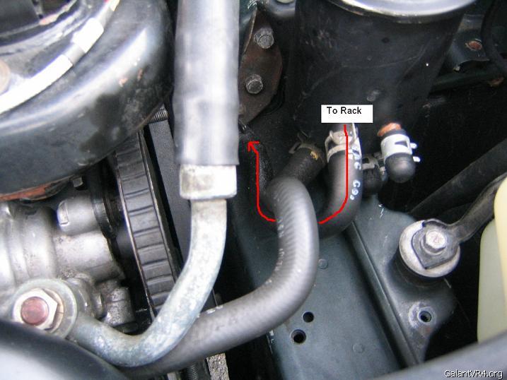

or those that wish to retain their factory power steering fluid level sensor.
If you use a TEL PS resevoir, you cant use the cap from the VR4 with the sensor in place. By blockign that line you retain the use of your "4WS" dummy light (which would in this case simply be used as a 'low fluid level' sensor.

just use a non 4ws resevior? then no lines to blank off.
Rich
I just picked one up a couple week ago for my swap, but the ports are opposite the Galant, i.e. top and bottom are different sizes than the Galant. So I'm going with the plugs on the stock reservoir. Picks to come.
So you just have to cap off those two lines that are highlighted? One of my rear PS lines is leaking and it is freezing out right now so as a temp fix i'd like to cap it off
