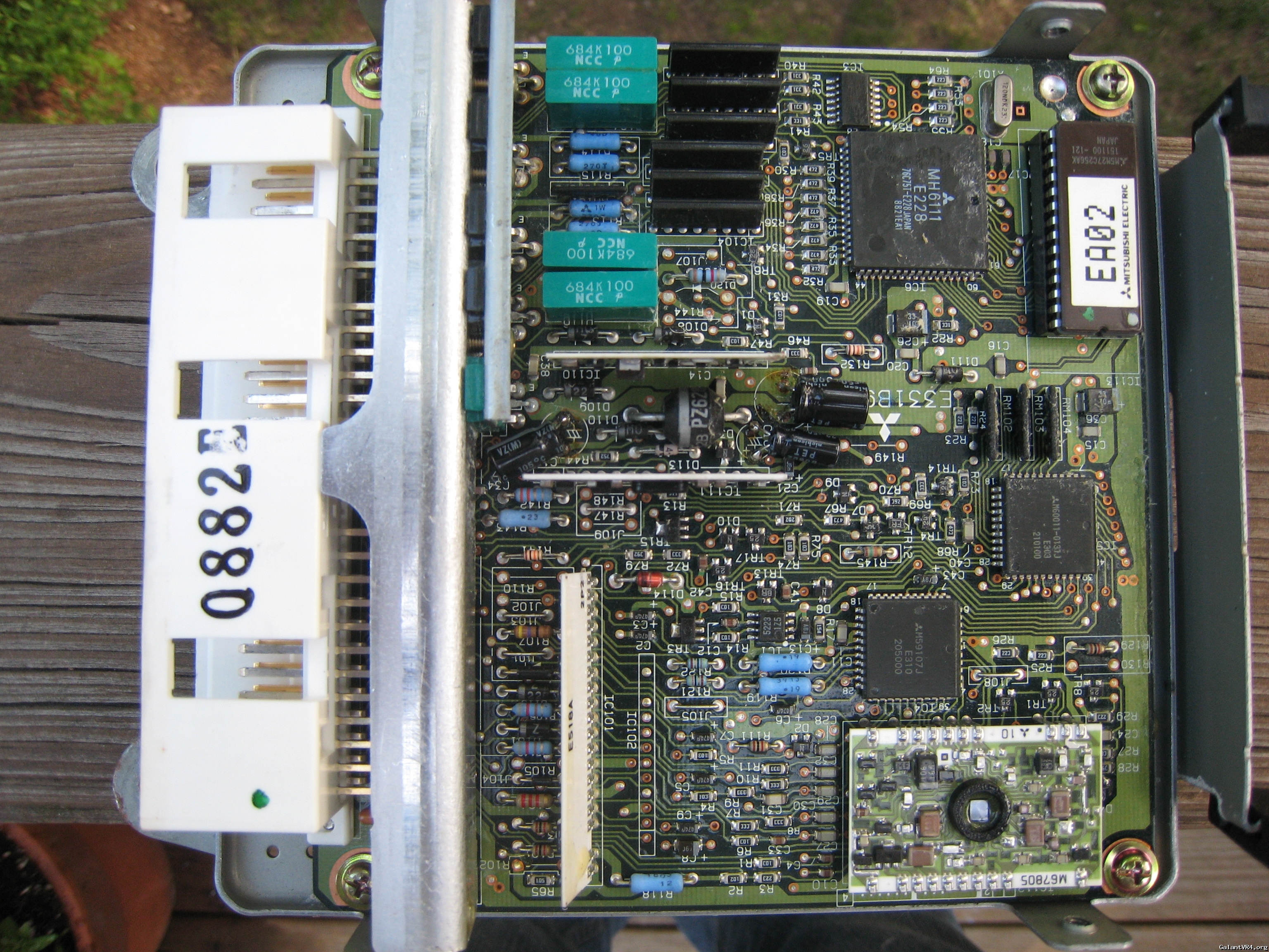

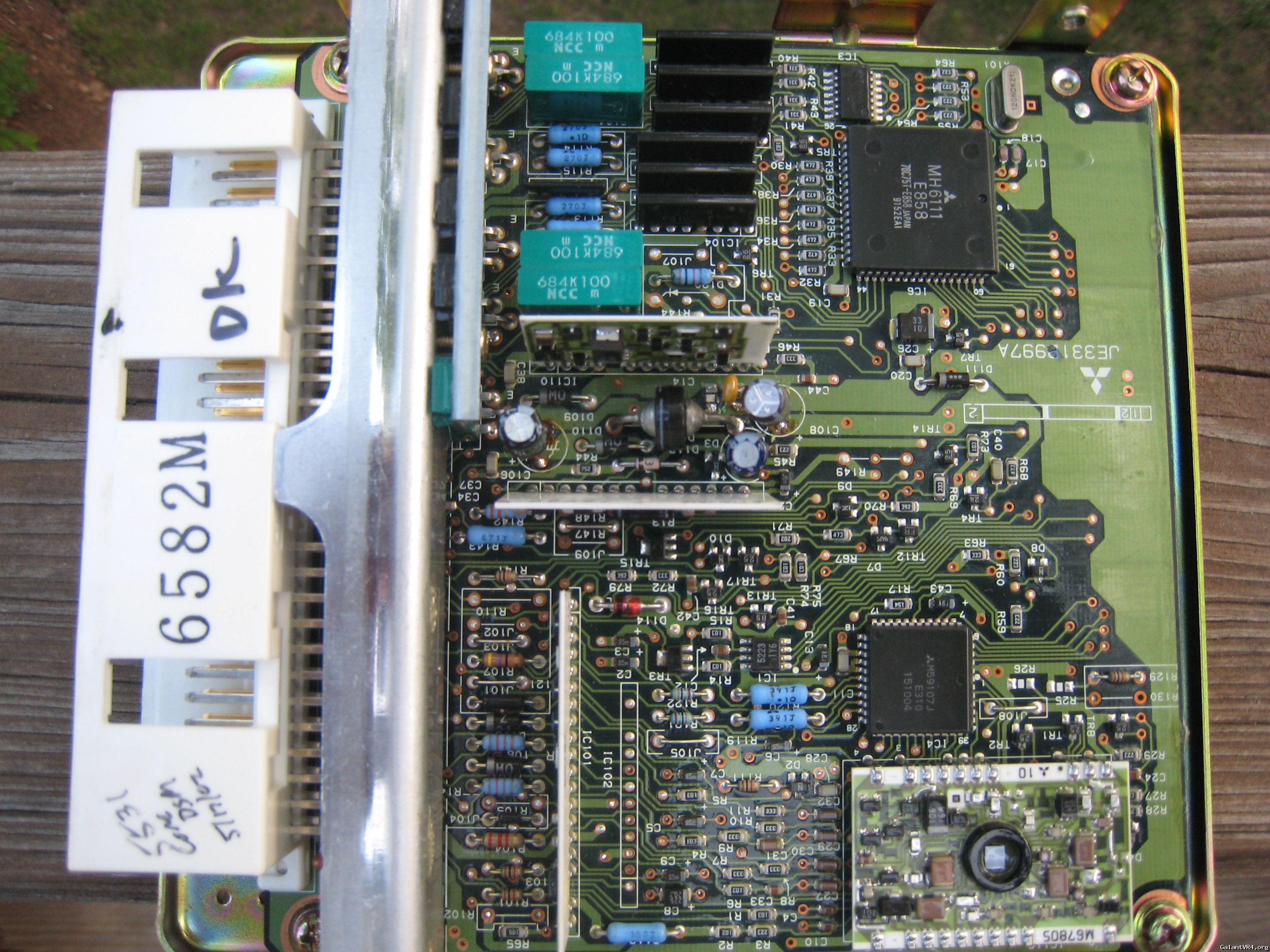

Can you take a close up picture of the board?
Terry, Steve, or Jeff might be able to tell the tale if they can get a pic of the board in that area.
They deal with ecu's all day long, and they are pretty sharp when it comes to these kinds of issues.

Click on the pictures for full resolution:
Stock GVR4 ECU
1G Turbo FWD ECU

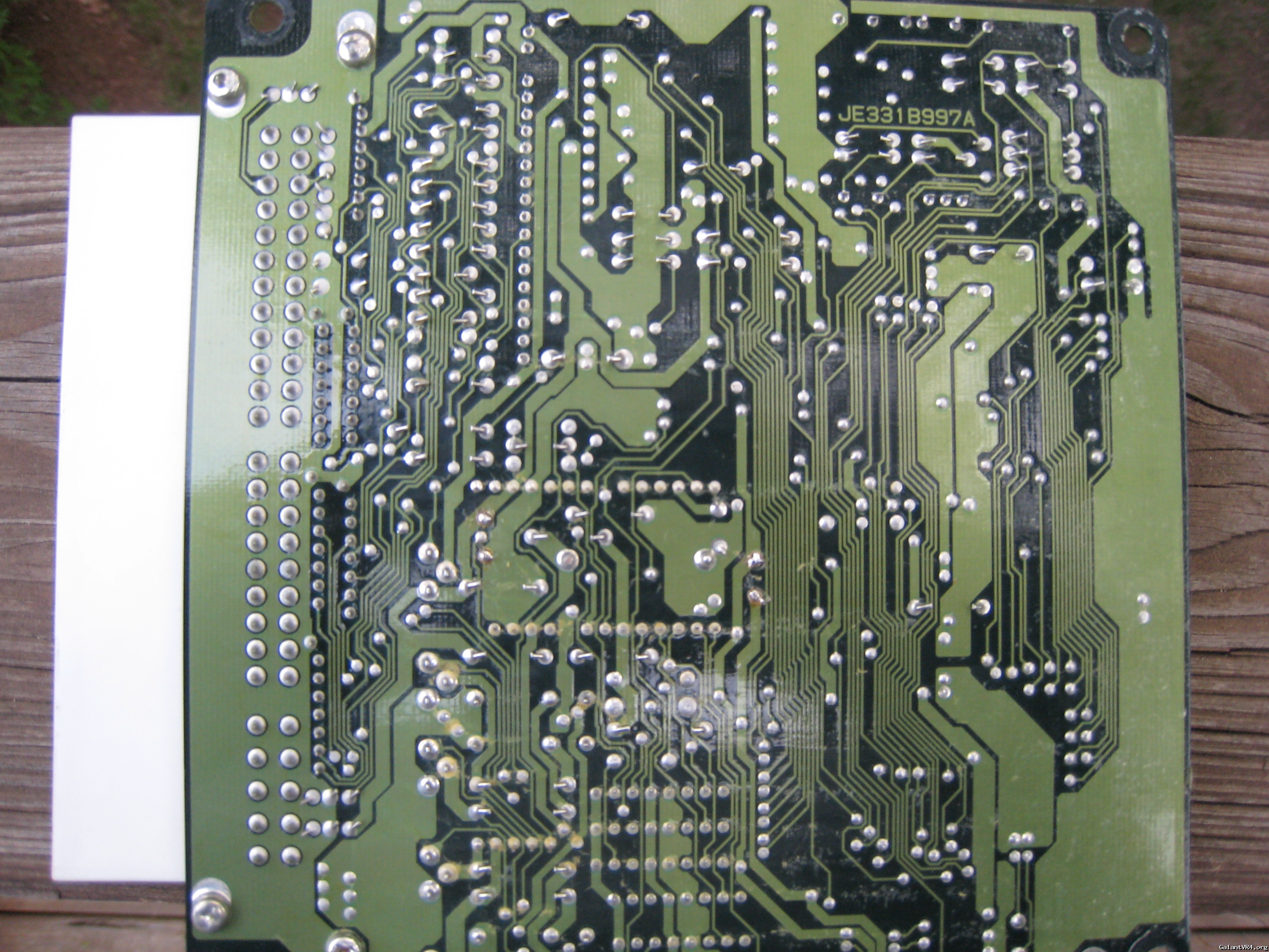

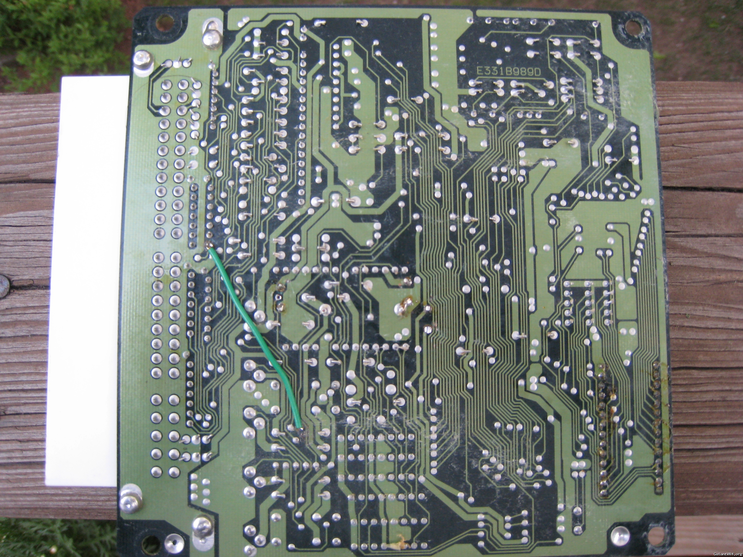

There is a "feed-through" hole directly under the 47uf cap (closest to the heat sink).
Remove the board from the case, use a ohm meter (set to continuity) and place the probes at both ends of the runs that the feed through "feeds".
It is a little hard to find the run to the SIP so take a pic of the underside of the board (just like the one you just took) and post it up, Iwill circle the two spots and resubmit.

Stock GVR4
1G FWD Turbo
I think I see where you mean (The repaired trace on the galant board). And if that's the case both boards have continuity between those pins.
