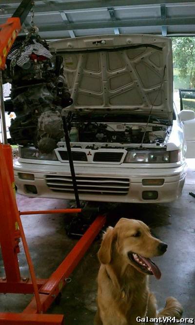

You mean like this?
I can't believe that's almost 9 years ago now, and my buddy there has a wife and kid /ubbthreads/images/graemlins/uhh.gif /ubbthreads/images/graemlins/rofl.gif

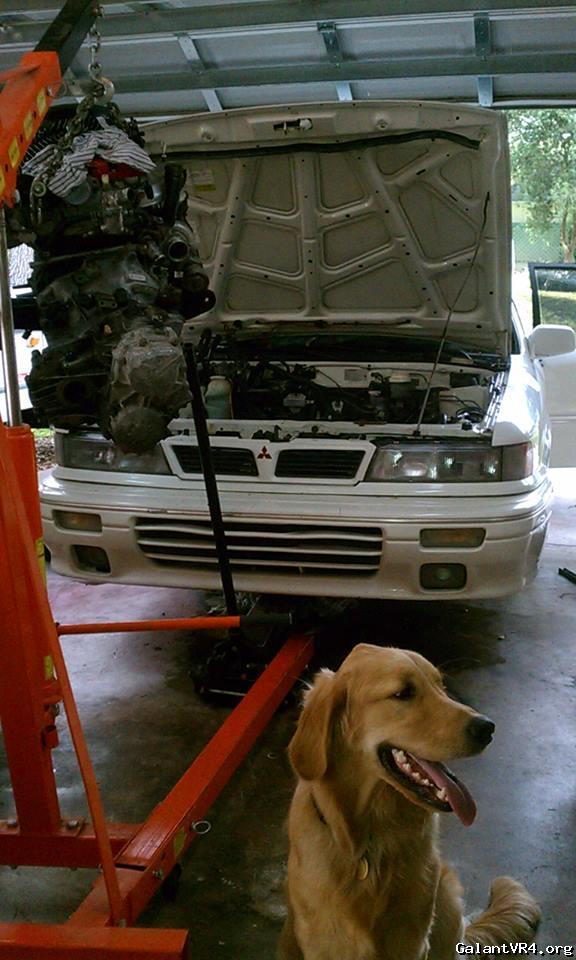

I've pulled the combo out of the top of mine twice now (unfortunately). Compared to the 3S it's cake. I don't even take the hood off. My dog tried helped as much as he could but he doesn't have thumbs.

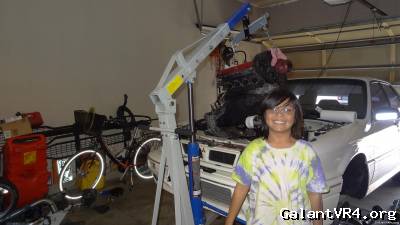

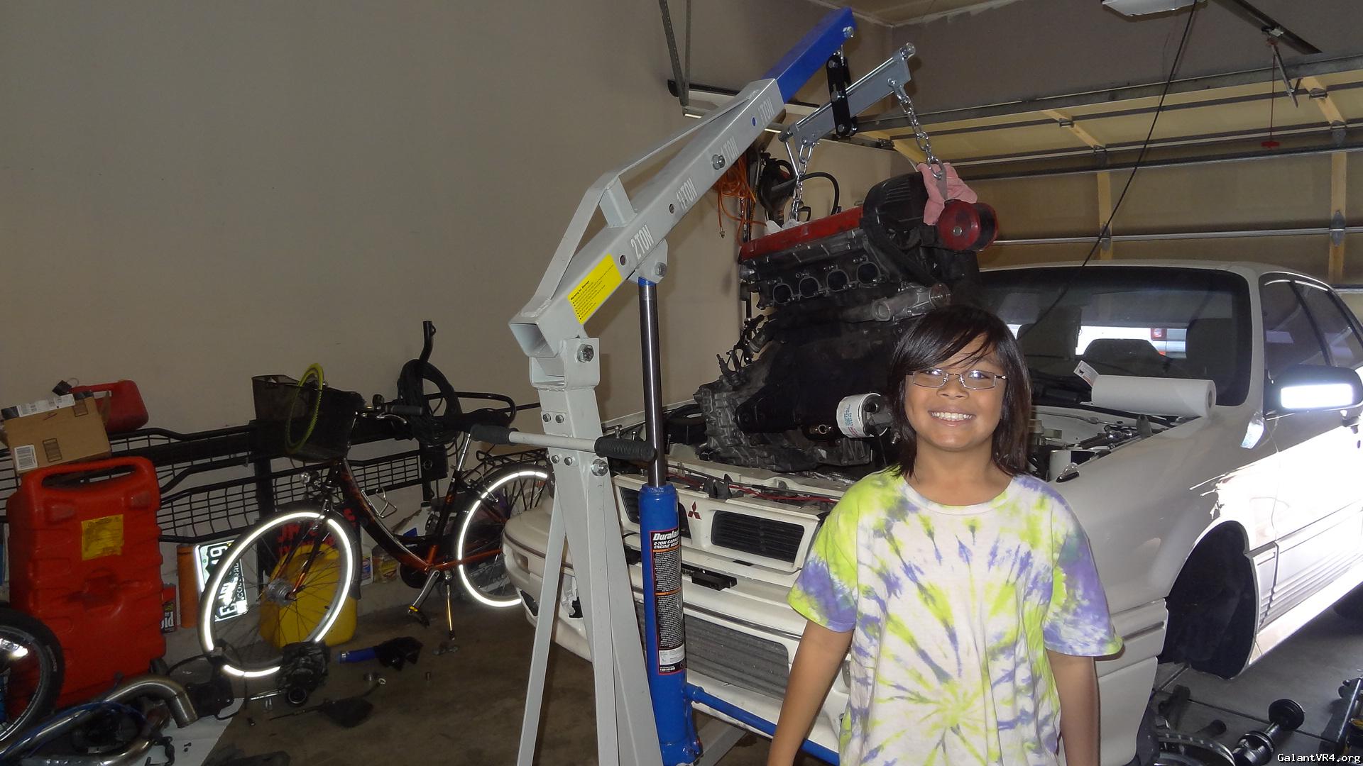

props to you guys without the engine leveler! I couldn't of done this with my 10yr old with out it.
