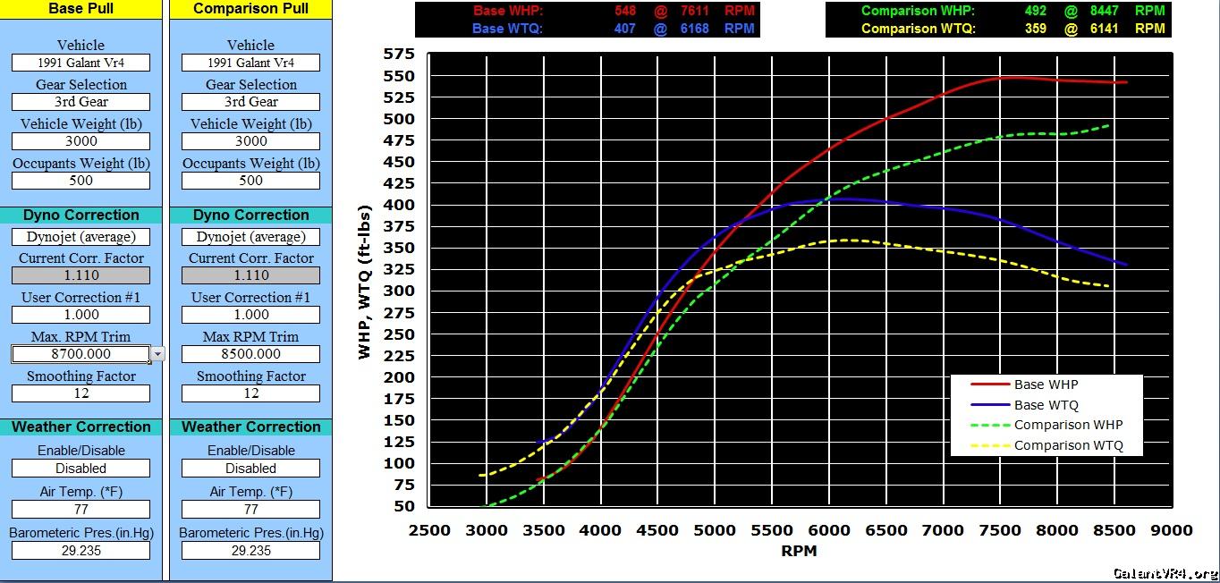

So on to the tuning. I dial in the 0psi part of my map and get the AFR's inline. After that we switch to 10psi, which is as low as my wastegate will go. I dail the AFR's in on that. Then we start cranking up the boost. We get to 19psi, and without making any timing changes from my Q16 map the car is making 492/359 on VDR Dynojet Avg.
The knock on the car is really good, the car has yet to pull anytiming. I do still need to add some more timing. I think that I can get almost 400ft of torque at 20psi. I just need to get a little more agressive with the timing. The car pulls awesome at 19psi, and I am at 65% duty cycle on my 1350cc injectors.

Car is making awesome power. I like it more than q16.
Here is a little VDR action. This is 22psi vs. 19psi on E85.
