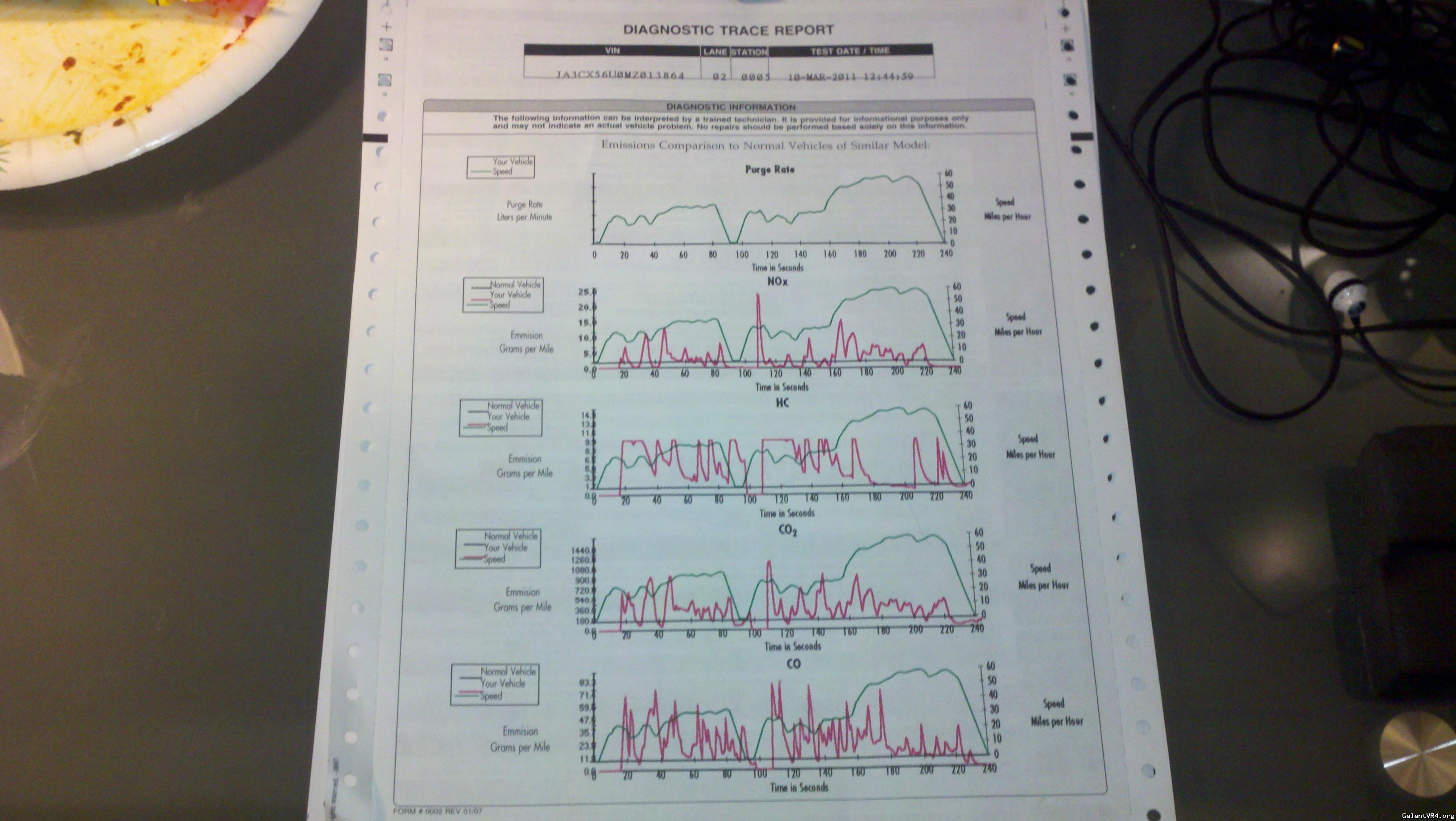

Was this car tested on the dyno?
The im240 test is a loaded test, and simulates a full drive cycle, and it tests for three polutants.
Carbon Monoxide (co)
Hydrocarbons (hc)
Nitrogen oxide (nox)
It's worth noting that taking the egr out of the loop will result in a major increase in nox readings, and the vehicle will probably fail that particulate under cruise conditions.
If you can, please scan or take a good picture of the emissions trace they gave you when you failed and post it up. (the page with all the colored lines).
Knowing the co and nox levels will help determine the nature and cause of the high hc readings.
It will also help show if it's small issue everywhere problem, or a massive issue with one particular area of operation.
If it spikes under load, you;re might want to look for a problem in the ignition secondary. (Plugs and wires) Make sure the ignition coil terminals are clean and corrosion free, and fire in a set of fresh ngk spark plugs, (Heat range and gap adjusted for your particular set-up.)
One of the best places to start working this situation is a logger.
High hc can be caused by a lean running condition. If the low trims show fuel being added, you;re looking for vacuum leaks
