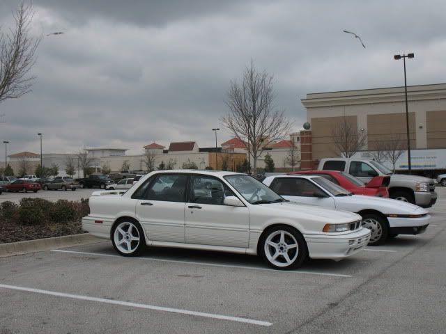

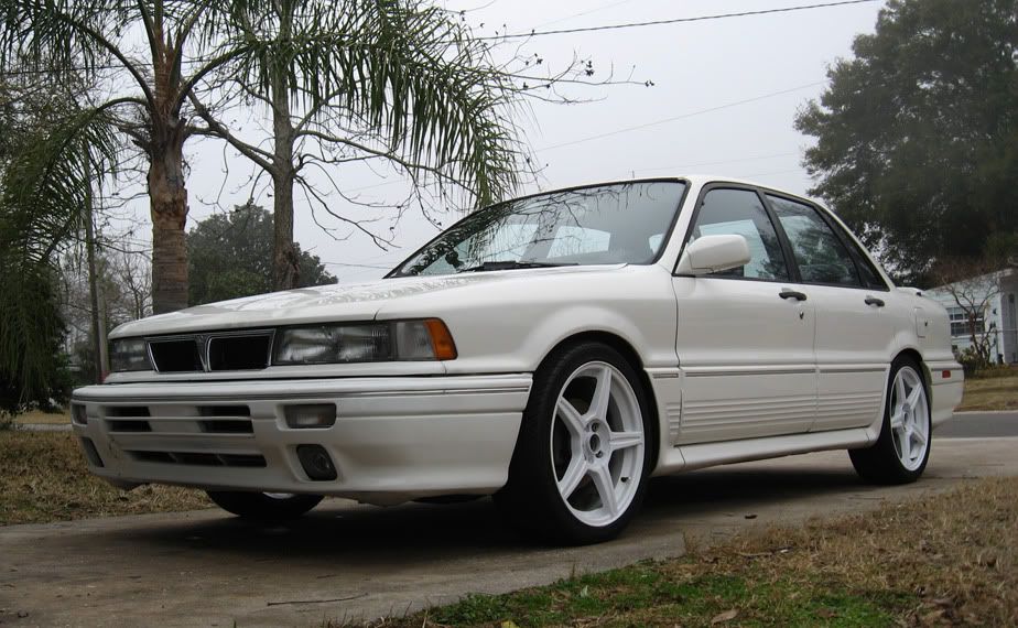

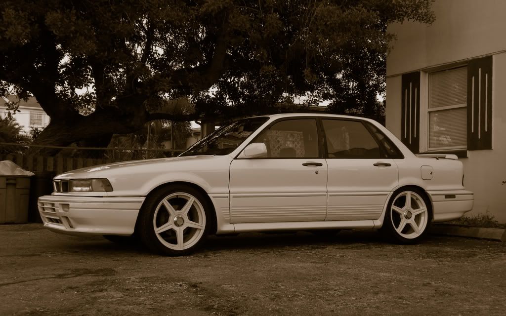

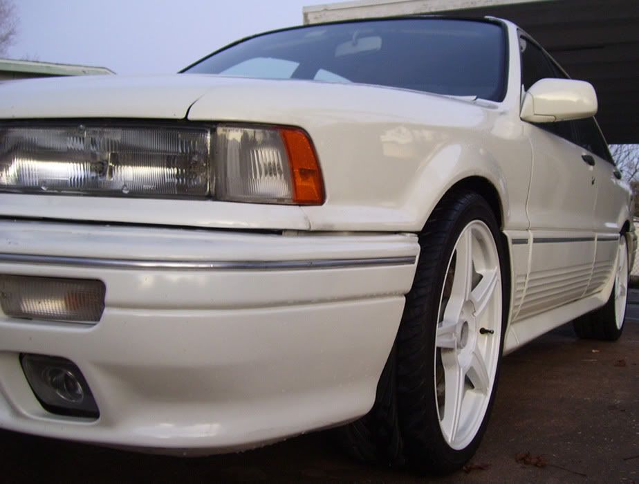

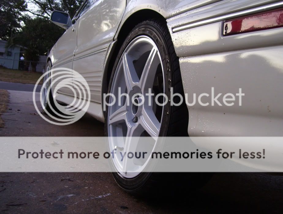

7 days later I installed a set of 18" White Powdercoated wheels on Kuhmo AST 225 series tires, with more to come shortly. For lack of a better word, it looked ghetto with the stock ride height and 18's.
The same night I installed the rims, we were pulled over for no reason, profiling. LOL.
A few days after that when the springs and shocks came in, she was JSB for the day.
And this was the result.
Eibach Pro-Kit with 1-inch spacer in the rear later added on KYB GR-2's.

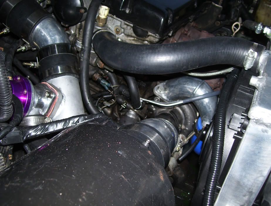

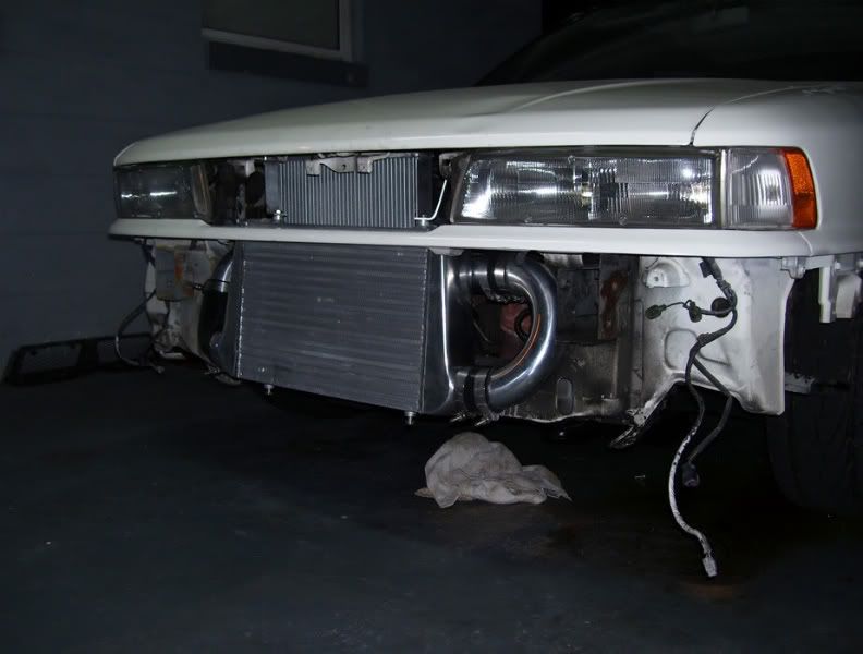

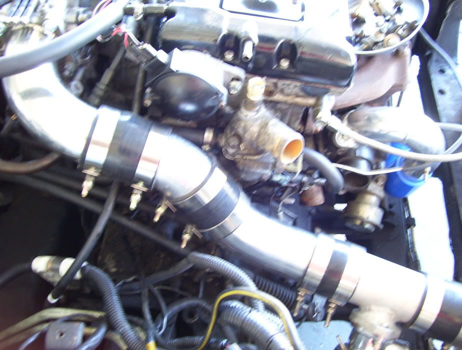

It started off with a new FMIC, custom routed and short routed.
The hot side remains as is, although I plan to change it up a bit soon.
The bumper support is unmodified and fits nicely in front of the FMIC. I may cut some extra out for better flow through the core, but for now I am all about the sleeper look.

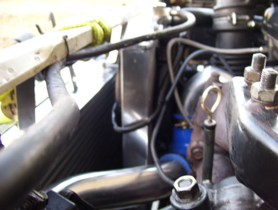

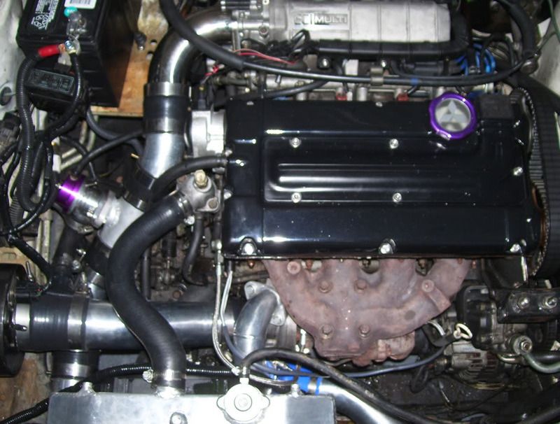

Of course, as can be seen above, short-routing the cold pipes called for a Honda style half radiator. Even in Florida I have yet to see temps over 195 and it cools nicely. The position of the radiator called for a 2g style upper radiator hose, the S curve helped it to line up right. The lower hose was trimmed a bit. At the time, I also constructed a 3" cold air intake from the stock MAF to turbo. The MAF occupies the space the battery would be, I relocated it to the lower cross member behind the tranny.

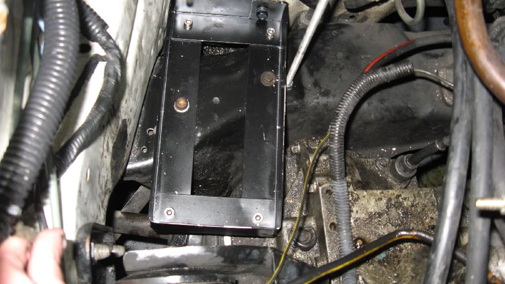

It's a smaller Die-hard battery and fits well. I custom constructed the tray with Aluminum Angle Iron, secured to the cross-member. Not seen is the j-hook on the pass. side and the threaded rod on the opposite side through the cross-member for the tie-down. I opted to not re-locate it to the trunk for the sake of extra expense to comply with NHRA rules, and it is still nicely out of the way.

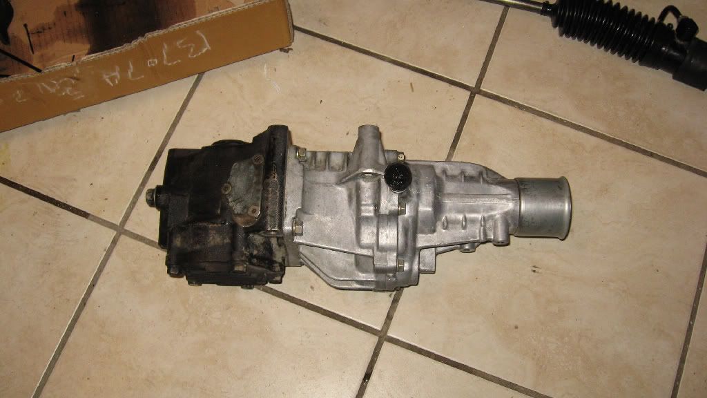

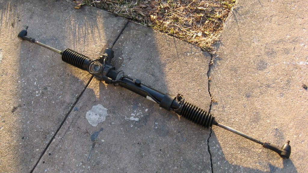

A couple weekends after that I decided to tackle the leaky 4ws line from the rack and eliminated the 4ws in the process by using a 1g DSM rack. I removed all lines back to above the rear dif. A 4-bolt rear will come soon.
While I had the transfer case out for the rack swap, I decided to perform the recall maintenance on the transfer case that was supposedly already done before. There was about half the fluid there should have been and signs of leakage, so I installed a new output seal and used JBWeld around the outside of the driveshaft yoke. 400 miles later and so far no signs of leakage.

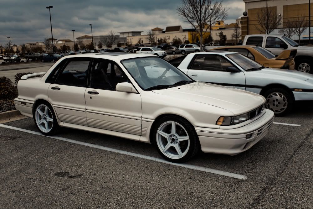

Recent pics.
And some of my favorites from last year.
