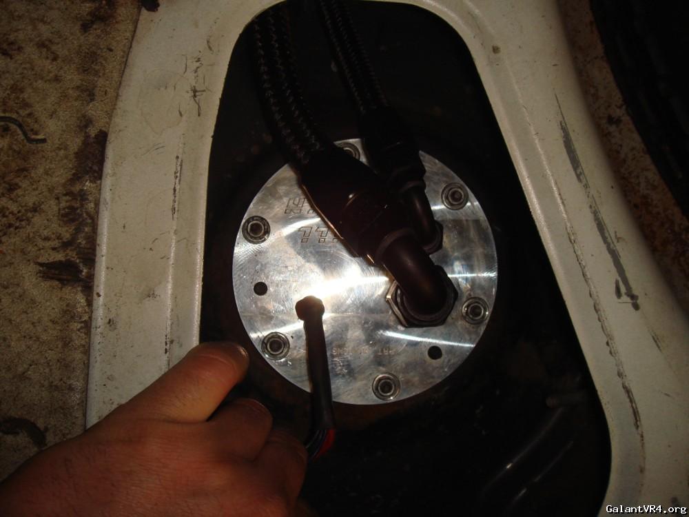

Its a pain in the ass to get both pumps to fit. You have to dent the bottom of the gas tank to make it work the way I was trying it. I did not want to do that so I just ran a 255hp intank feeding a O44 inline with -8 to the rail. There is a company that makes a nice machined aluminum holder for dual pumps. Forgot who it was. But someone here should know
Edit Found it

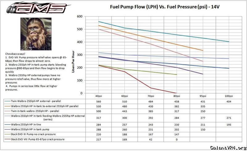

According to AMS's tests, for pretty much anything over 290 liters/hour of flow you need parallel pumps:
290 liters/hour would be equivalent to 1450cc injectors @ 37psi and 90% Duty Cycle.
Also according to that graph, a single intank Walbro 255HP (rewired) is only good to ~210 liters/hour, which would be 1050cc injectors @ 37psi and 90% Duty Cycle, or 950cc (980cc/1000cc) injectors @ 37psi and 100% DC.

Full Blown kit does fit
Thats news to me, I stand corrected. Are the sending units the same length as the GVR4's?
No they are actually shorter in the GVR4's by about a 1/2" to 1".
