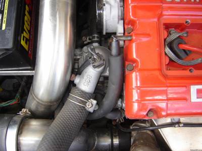

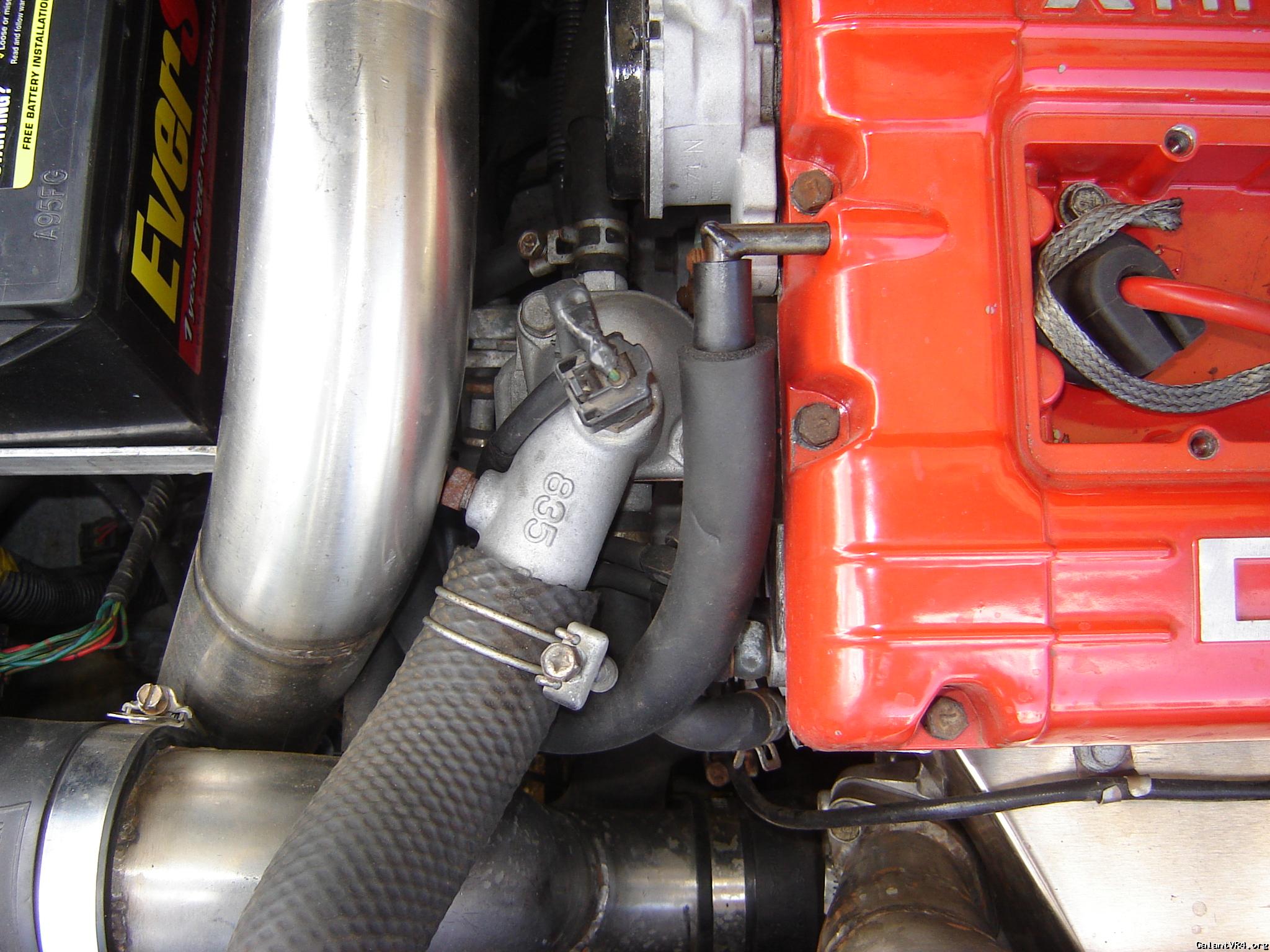

The first picture is of my setup with a SOHC 2.0 from a base galant. Im not sure if the 1.8 from a DSM is the same or not but I could find out.

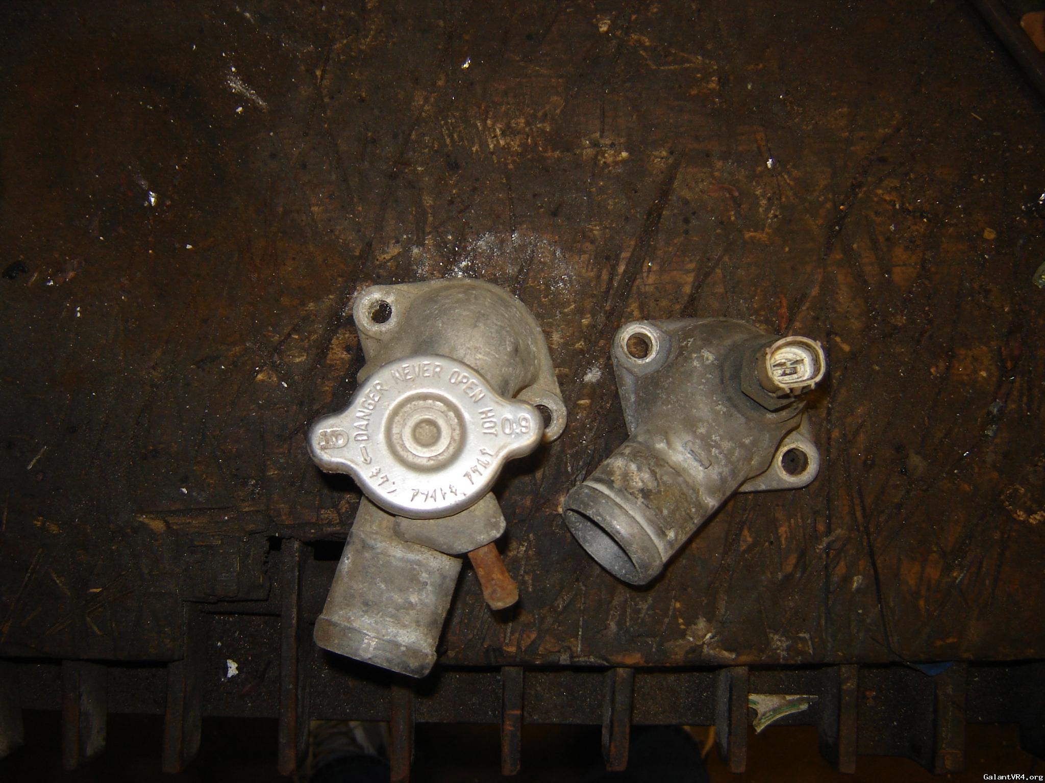

This is a picture of a DOHC 2.0 neck that came on all the turbo and non turbo DSM's on the left, and on the right is the Galant 2.0 neck from both the turbo and n/a DOHC.
You can see in the pictures that the angle of the necks vary, the SOHC neck is about the same angle as the DSM's, but it angles down just a little bit also. This didn't cause me any issue tho. But, I think, I used the SOHC radiator hose which I had to cut to the right length.
As for filling the hole with J.B. weld, I would advise against it. Heat is pretty much the only thing that will release the bond of J.B. weld.
