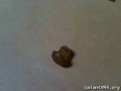

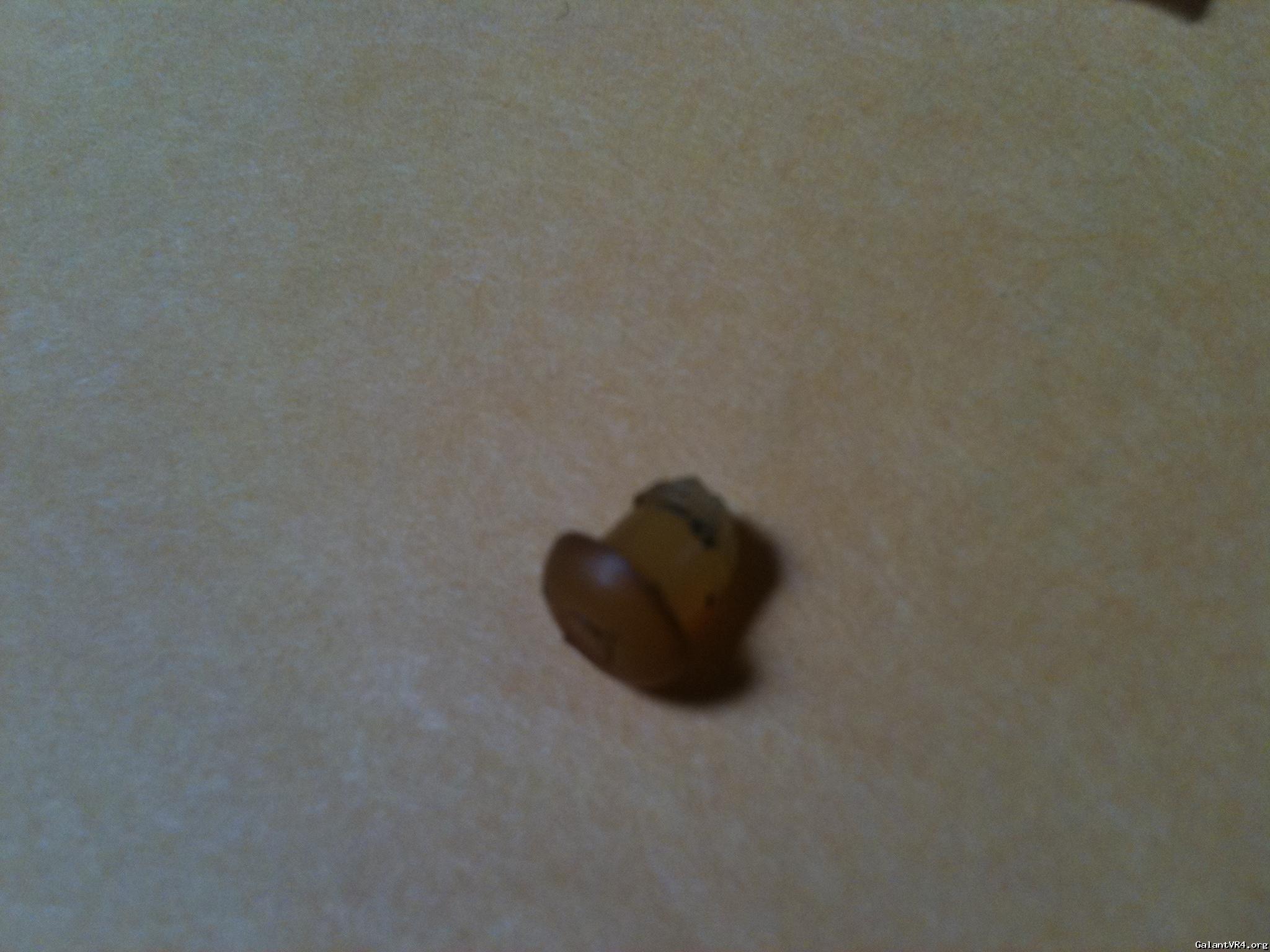

Guys...it was WAY easier than a clutch rebuild...
I traced the clutch pedal up to the clutch switch...and found that attatched to the top portion of the clutch pedal was a plastic piece that contacts the switch...thus letting the car know that 'clutch is in, lets start this bia up' ...that plastic piece was worn down...as shown below...
I went ahead and replaced this piece with a bolt with the same diameter and width, and capped it off with a piece of plastic to hold it in...
NOW..no issues! Dont have to hammer down on the clutch to start the car...
my questions is.. do they sell just THIS piece? Instead of doing the rebuild and spending $100, we can just spend $3-8 and replace this piece.
