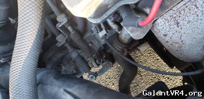

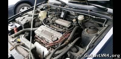

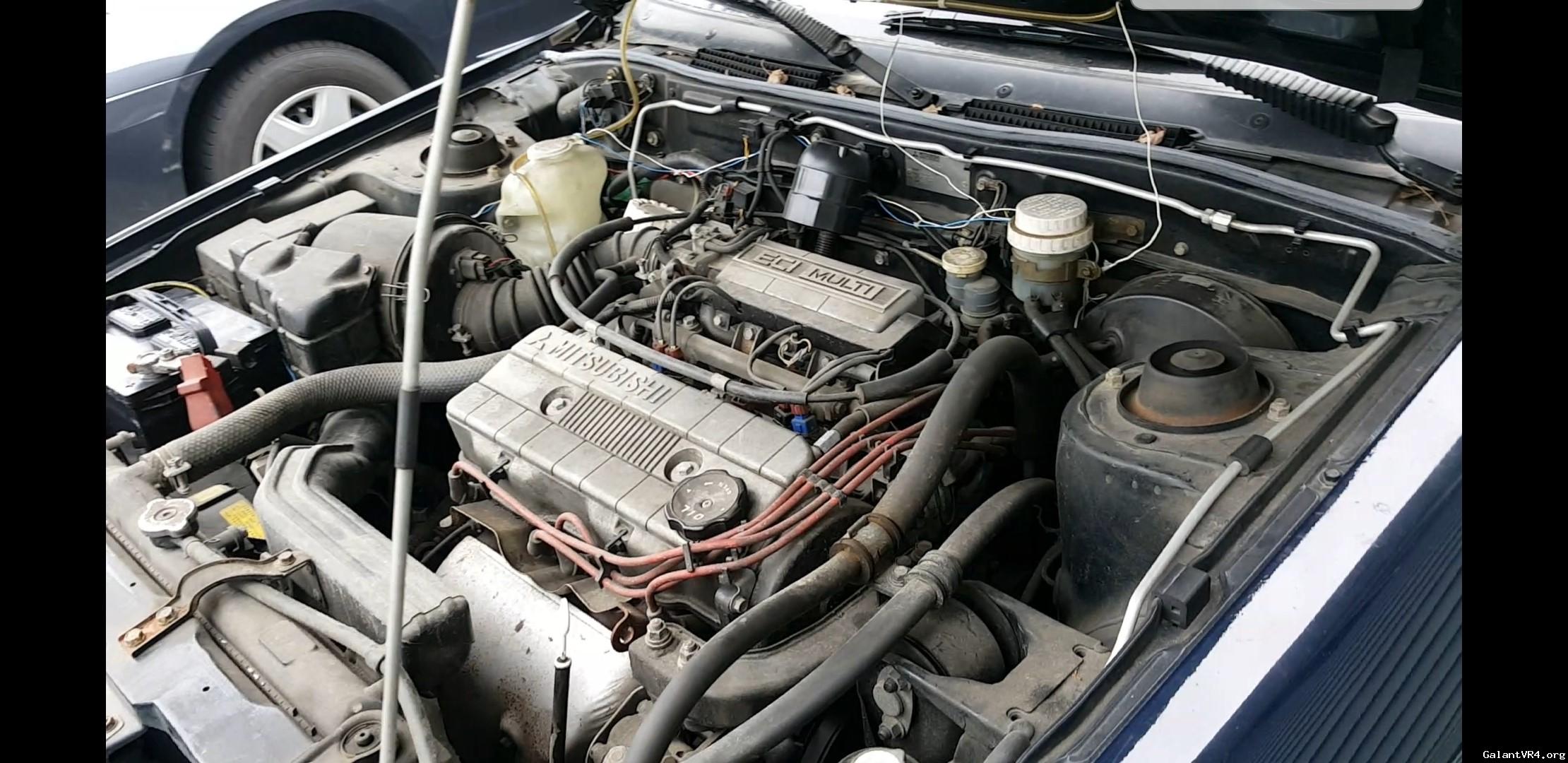

So i have a 1990 galant and the clutch cable is no good. Anyone know if there are other trims of clutch cable that can fit into this? It is a SOHC(yeah i know it sucks) no autoparts have them.
gvr4ever
Aug 6, 2002
6,250
central Indiana
I just went out of my way to search Rock auto for a 1090 SOHC Galant, cause I was in shock that it would have a clutch cable. Rockauto doesn't show the car having a clutch cable system.
Can you post pictures?

I could be wrong tbh havent been much under the hood. So my issue is when I was driving last night for some reason I couldn't shift gear and also my clutch pedal went down to the floor. So could be that my clutch is no good? I figure these galants would be clutch cable?

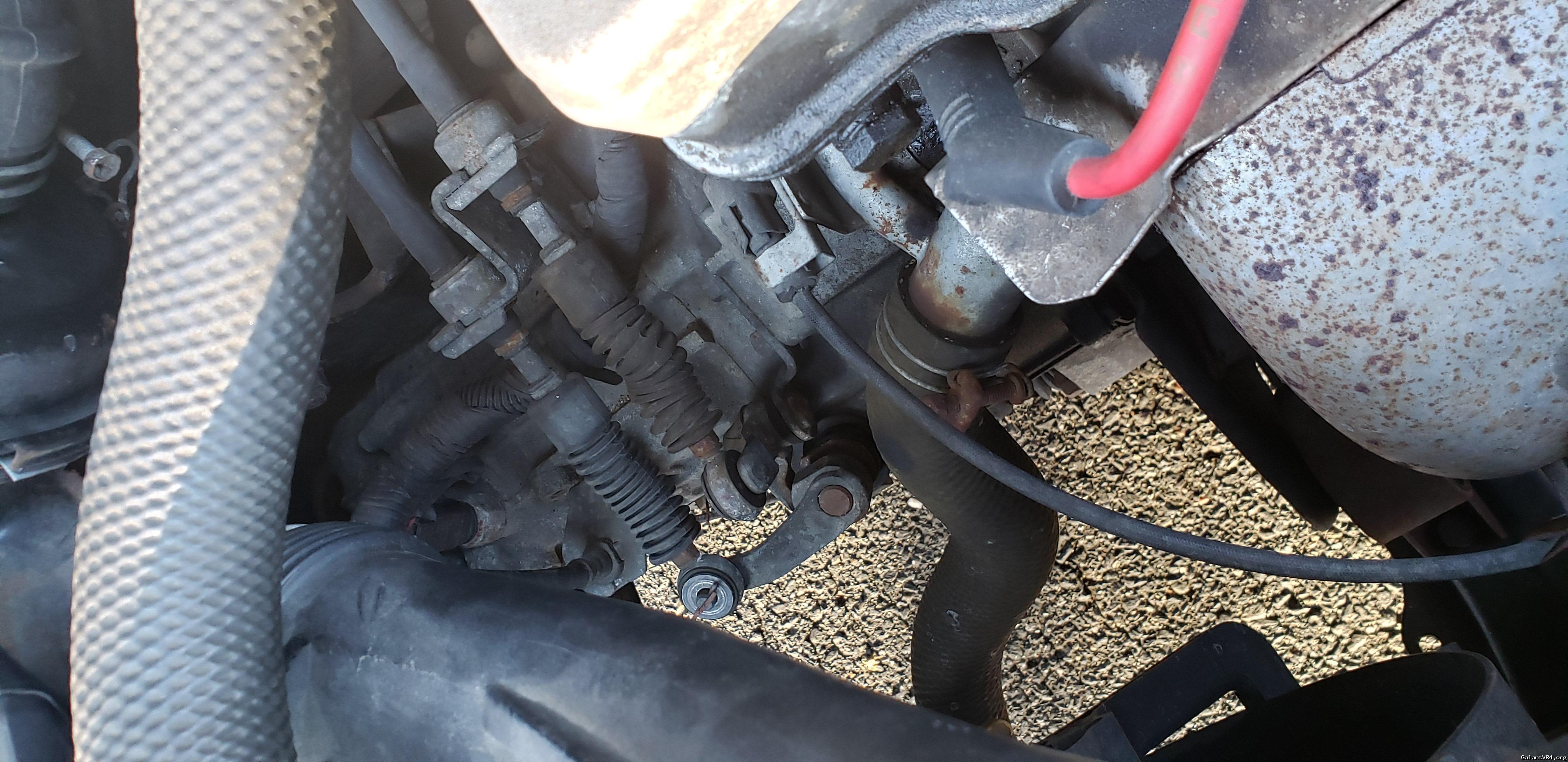

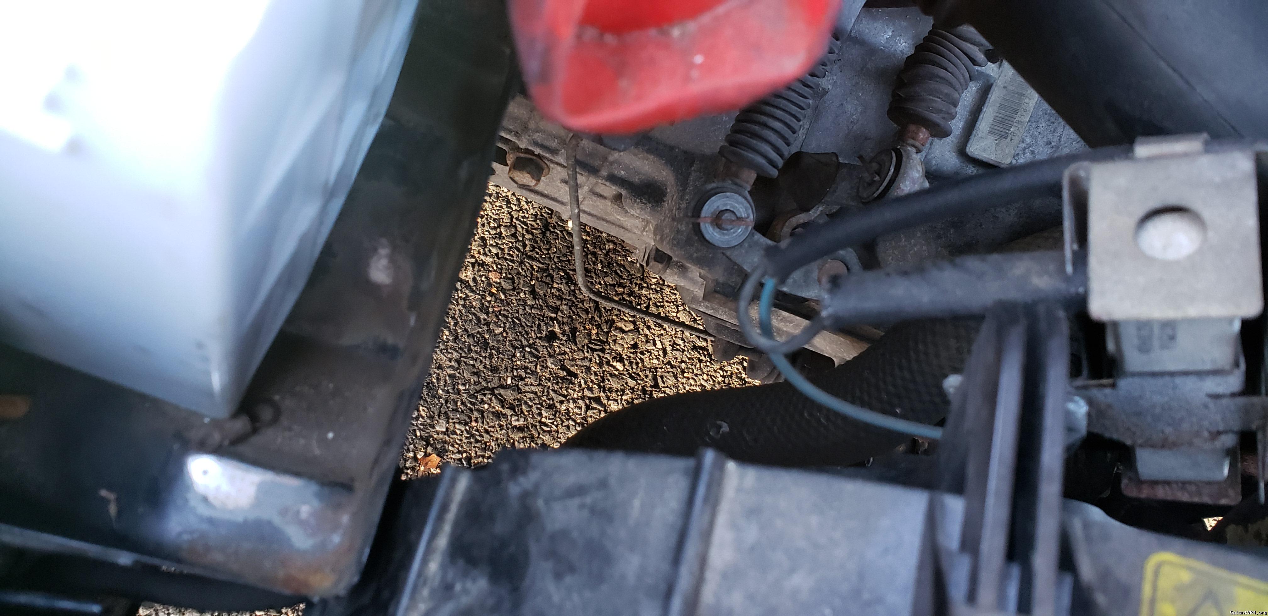

Yeah this car has been garaged all its life in warm temperature only has 48k on it as of now. But 2 years ago I took it out and starting doing tune ups here and there. I did check the fluid ans there was barely any and also was dirty. I cleaned and put some fluid in it. And started to operate but not fully since I have to bleed it. Though my issue is i cannot find the bleeder on this car. Any clues to where I can find it? I checked everything you mentioned and everything is moving properly.

Thank you! I will check this out and see. It must be under seeing that it is not visible from up top.
