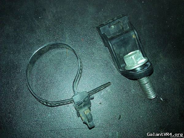

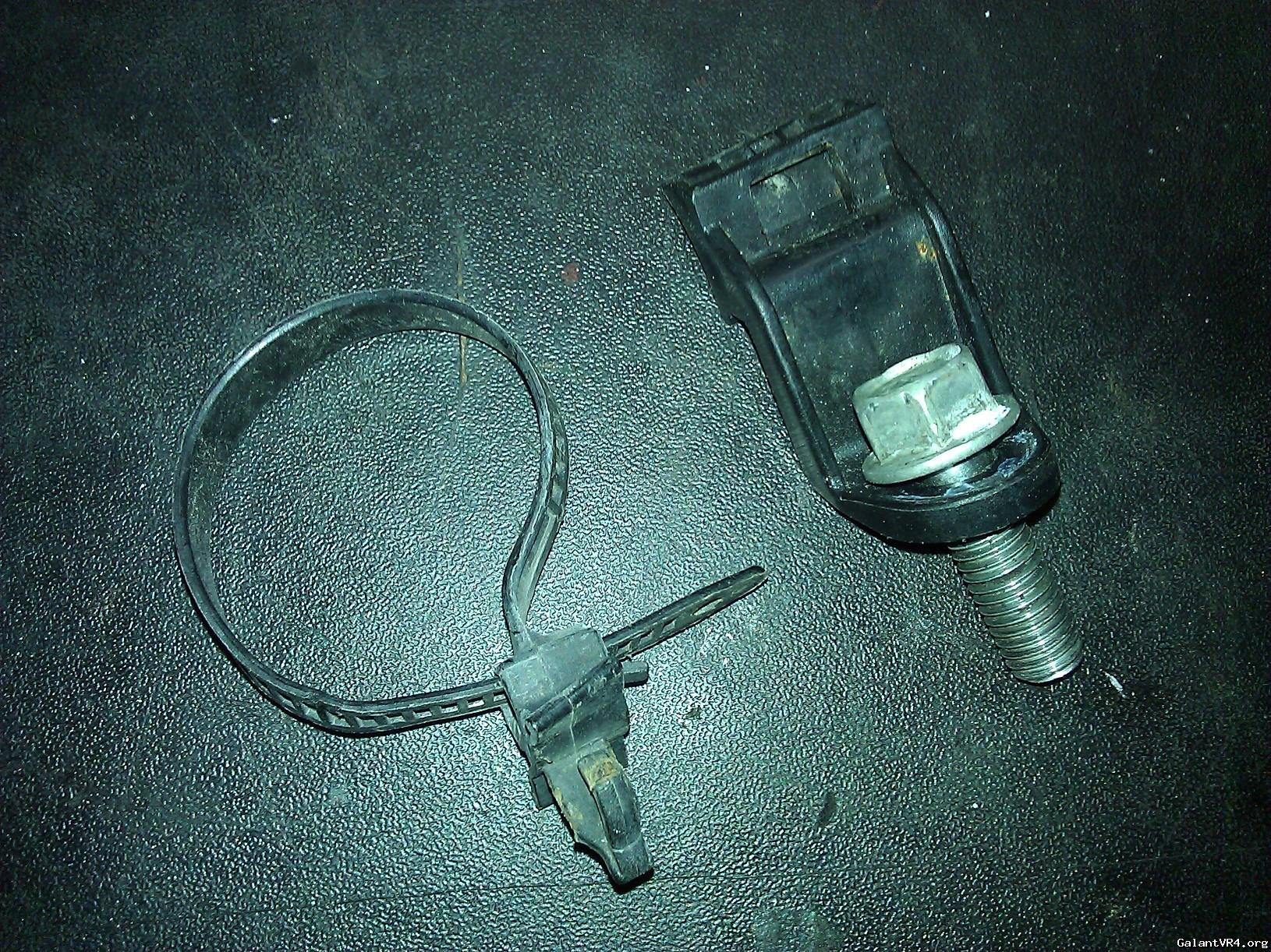

I'll be attaching it to the car using a variety of methods. I have some plastic harness brackets that bolt on in various places. I'll also utilize some snap in harness ties (thanks Pot!), and regular zip ties where needed. I'll try to post some more pics after it's all routed.
