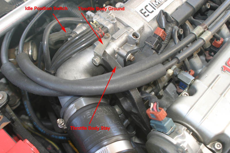

I dont recall any other wires coming off the Throttle body other than the Idle Position switch. If someone would please take a pic of this, to show how many wires are where, that would be nice.

The throttle body has the IPS, TPS and ISC attached that are wired. It may also have a ground strap running between one of the bolts attaching the throttle body to the IM and the top of the throttle body. The IPS needs a good TB ground to function.
I don't have any pictures of a stock GVR4 TB/Intake to confirm. On a 91+ DSM it looks like this.
