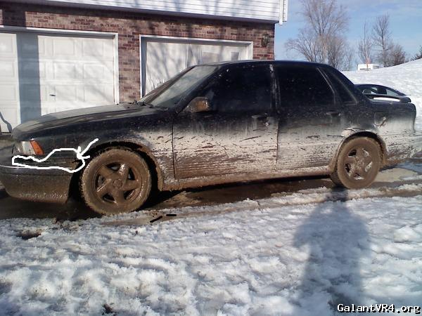

Hey guys well a long winter both sides of my bumper are falling off. the only way it is held on is by the front where the gril is located. I was just wondering how you guys would remount this?

On the sides where the fenders are the brackets are broken. I was wondering how you could remount the sides since the brackets are broke.

Does this help at all? Maybe some pics would help us to help you?
