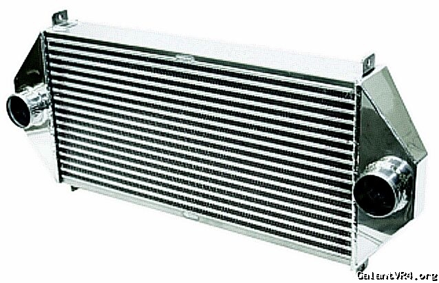

The intercooler I bought used off a friend. I know he ran about 24psi through with no problems.
It is 24x12x3 core.
Configured like this:

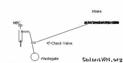

If your MBC doesn't have a bleed or a checkvalve it won't hold boost as RPMS climb. The reason for this is that in many situations you need the wastegate to close slightly as the RPMs climb in order to hold boost. W/o a checkvalve or bleeder the pressure can't escape from the wg actuator so the wastegate doesn't "know" that boost is falling off and it just stays open. Replace your mbc or install a checkvalve and see if that helps.
belize1334
Nov 18, 2003
3,317
Bozeman, MT
The checkvalve allows pressure to bleed from the wg back to the source if the pressure at the source starts to fall off. It only goes one way though so it won't allow pressure to bypass the mbc. Many people do this with a bleed valve that just vents to atmosphere. It's basically a small leak in the mbc and accomplishes the same task, though the checkvalve works better IMHO. Either way, you need a way for the wg to get rid of that excess pressure (trapped between the wg and the one-way mbc) if the source pressure starts to fall.
