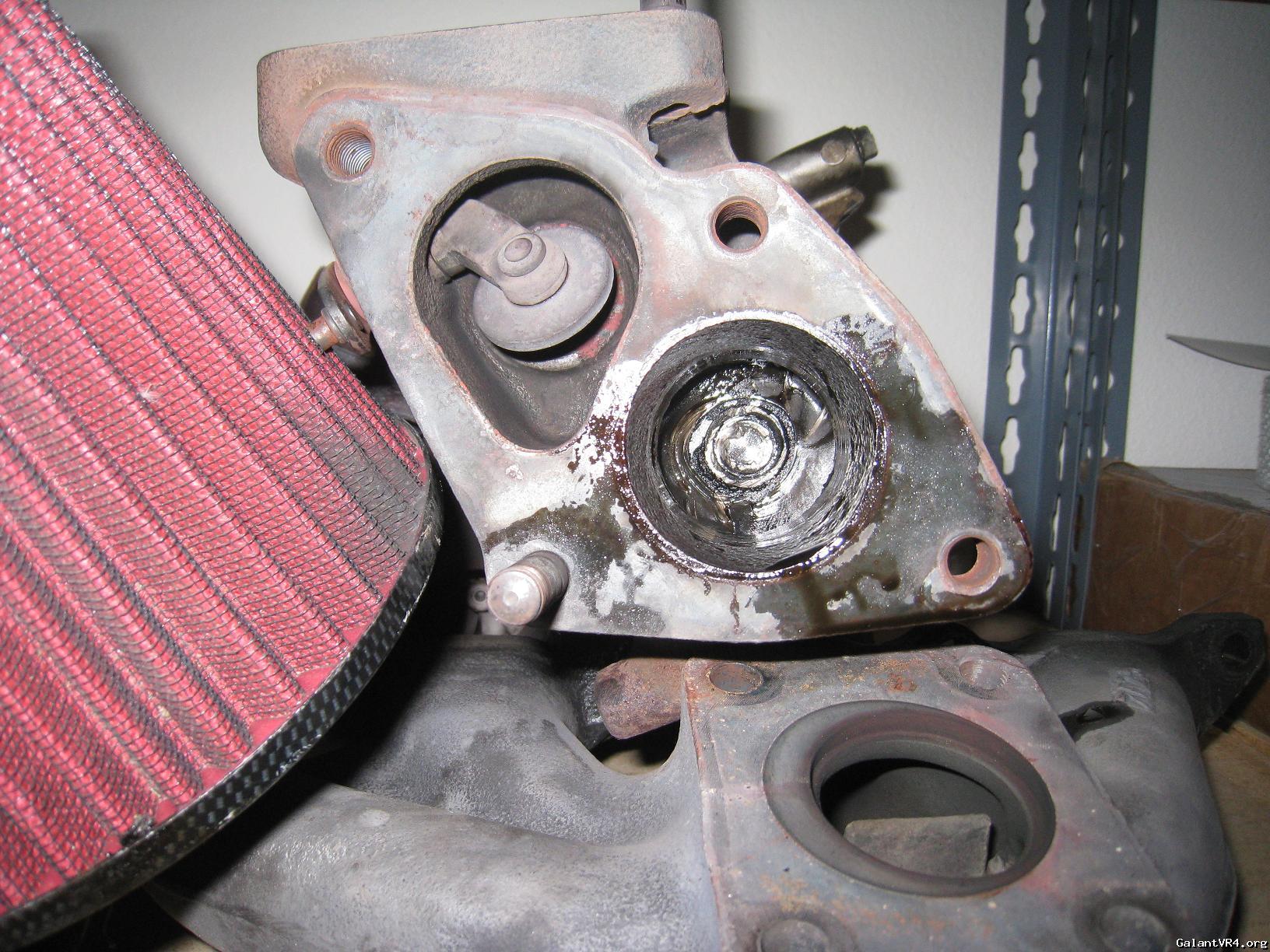

I think someone here had posted a picture once of their 14b and how the exhaust wheel had sheared off the shaft, effectively blocking the exhaust passage. That's a possibility too.
you mean like this lol.... /ubbthreads/images/graemlins/shocked.gif This was when my 11b on my colt saw 20 psi. i went from full boost to all motor in the blink of an eye.

Wow! There are a lot more of us than I thought. Mine just sounded like a fan tapping its metal shrouding every few seconds until [see picture above].
