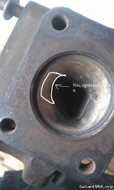

Port that wastegate flapper hole and get a bigger flapper to cover the larger hole. Or go external gate.
Or it may be possible you have some build up on the exhaust manifold flange mating surface to head, and you need to lay it on a sanding belt or have it milled so the surface is true again. Of course if you had creep that bad due to a exhaust leak you would hear it.
Its hard to explain in text, but thats not all you do. You have to grind down the upper portion of the hole from the inside of the turbine housing, so that the exhaust hits the bottom portion of the hole and exits the flapper. It would be much easier to show.
A exhaust leak on the manifold would not cause creep, it would have the opposite effect.

External gate is a little extreme on a 16g, IMO. I would start with porting the path to the wastegate hole on the turbine housing, which is practically free. Or port out the hole and do the 34mm flapper while you're at it.
I understand what you are saying, I have seen the inside of the housing. Maybe op will post his progress if he decides to go that route.

Till you expose more of the lower portion of the wastegate hole. There is quite a bit of meat there to cut from I wouldn't worry too much. I pretty much outlined what you need to remove.
