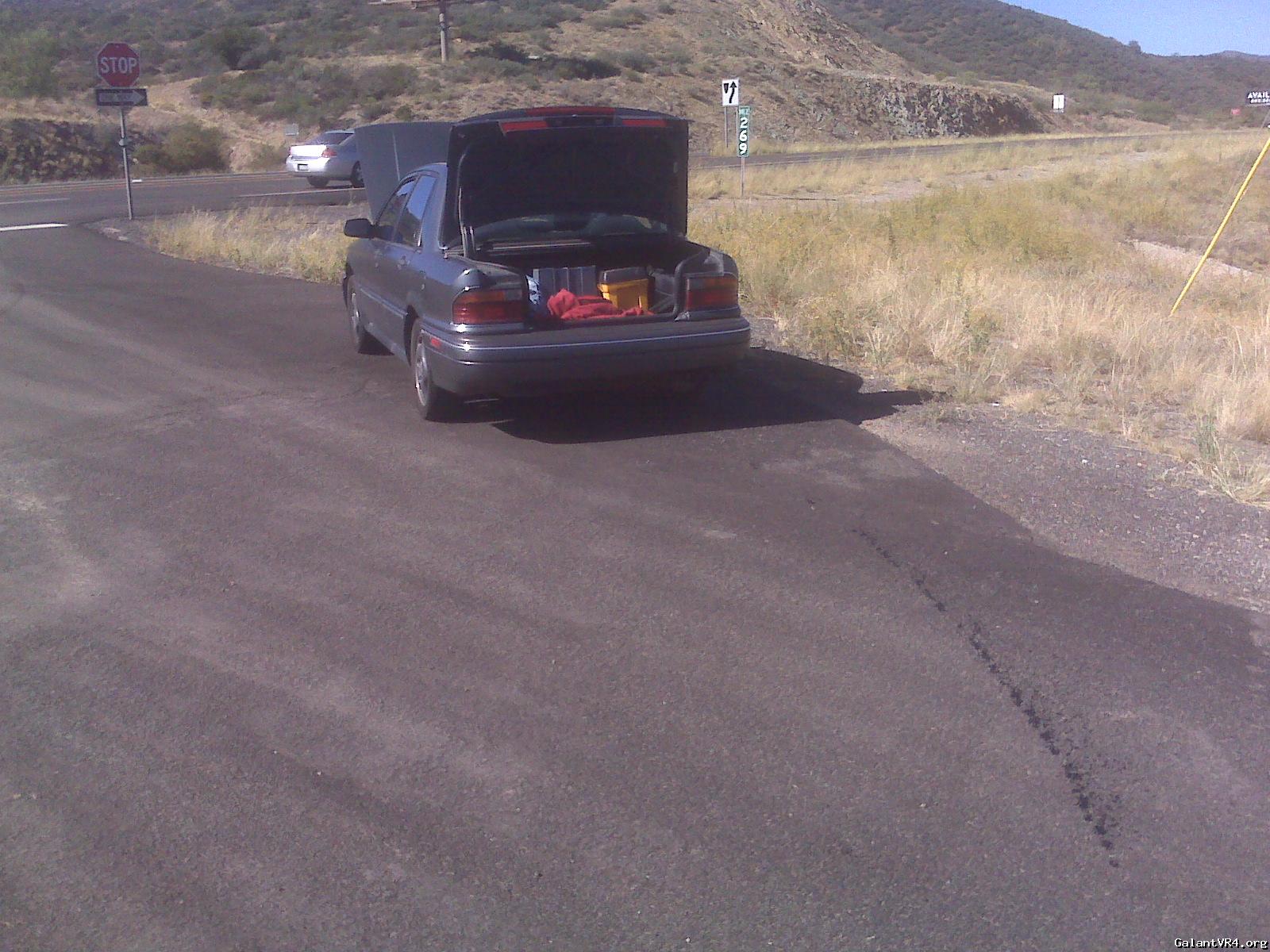

Symptoms: Groaning noise, similar to being low on power steering fluid, when the car is moving. It's tied to vehicle speed, not engine speed. Sounds like a dry gearbox, but the noise gets louder when the car is going around a corner. (As in when turning the car around to line it up for the flatbed on the side of the highway.) Smells like Synchroshift.
Here's the leak when I pulled off the road.

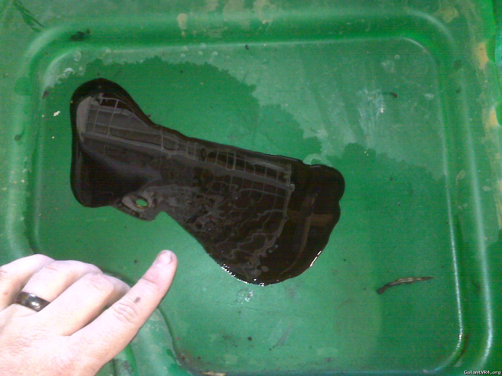

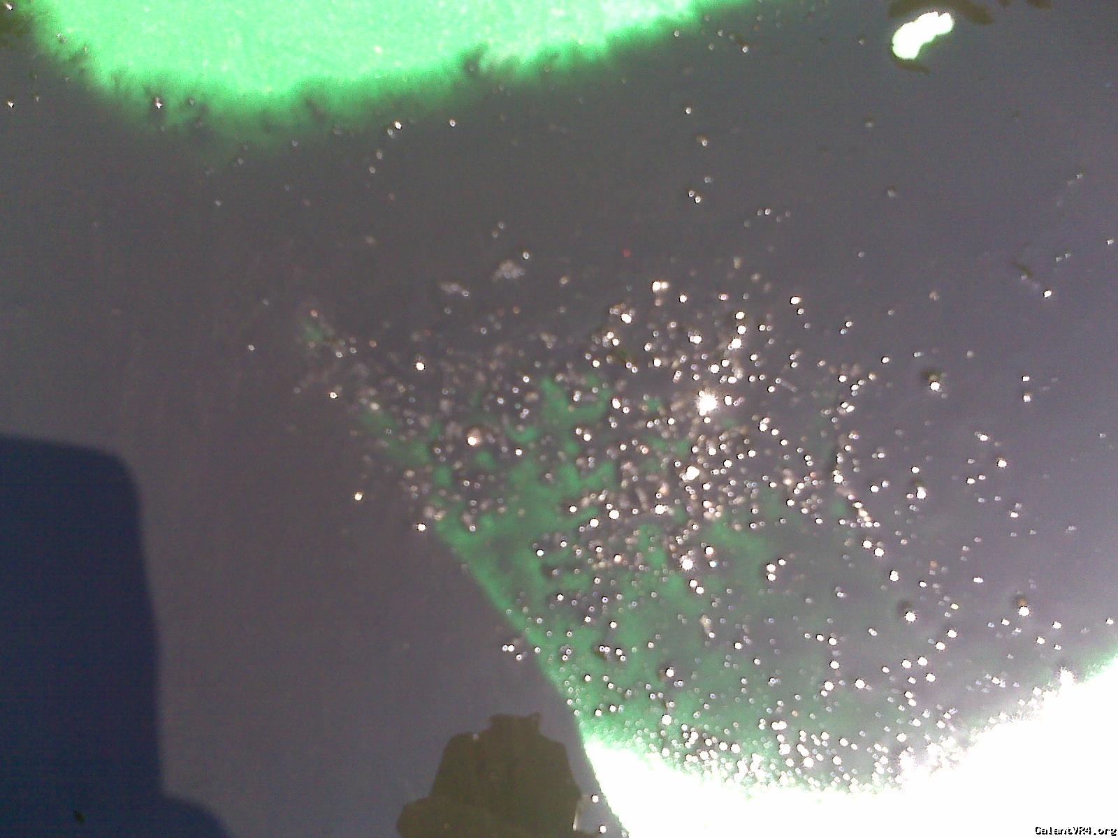

Just got the tcase down. This is all the fluid that came out.

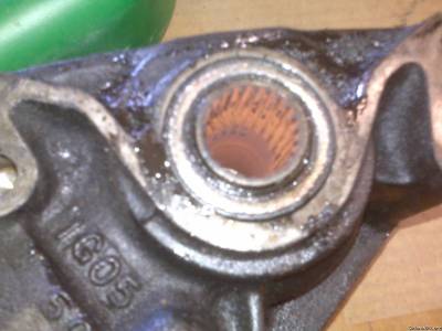

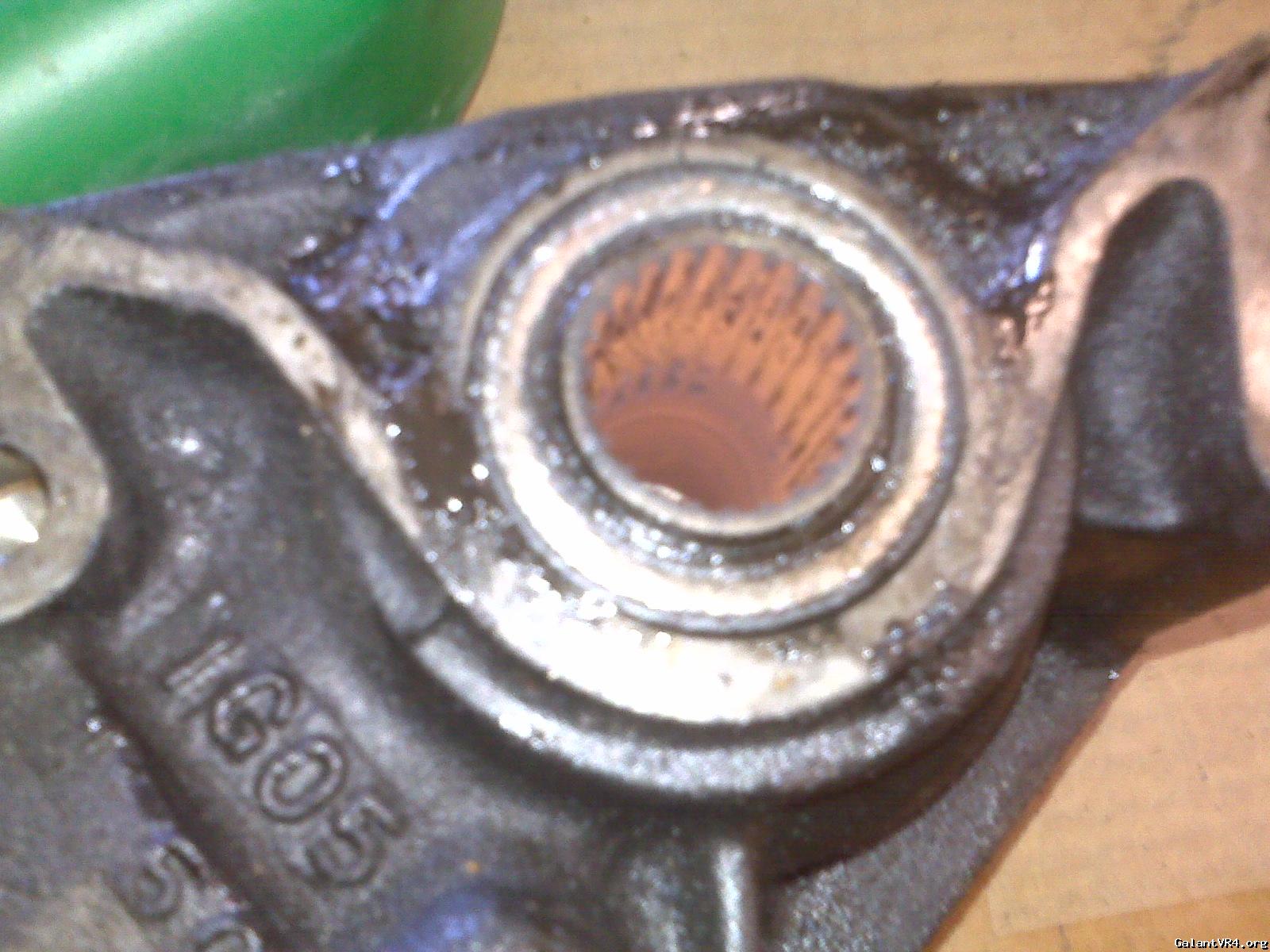

The output shaft on the trans is bone dry with that typical patina of oxidation on the splines. The SEAL on the tcase, however...
Is that seal supposed to have the shiny, been spinning free against the engine block, look to it? Picture's not that great, but it's got arough texture to the shiny area indicative of rubbing on something. It's not smooth, like I would expect if it were supposed to be bare metal there. Also, it was coming out and it took minimal finger pressure to slip it back into place. I'm thinking NOT GOOD.
