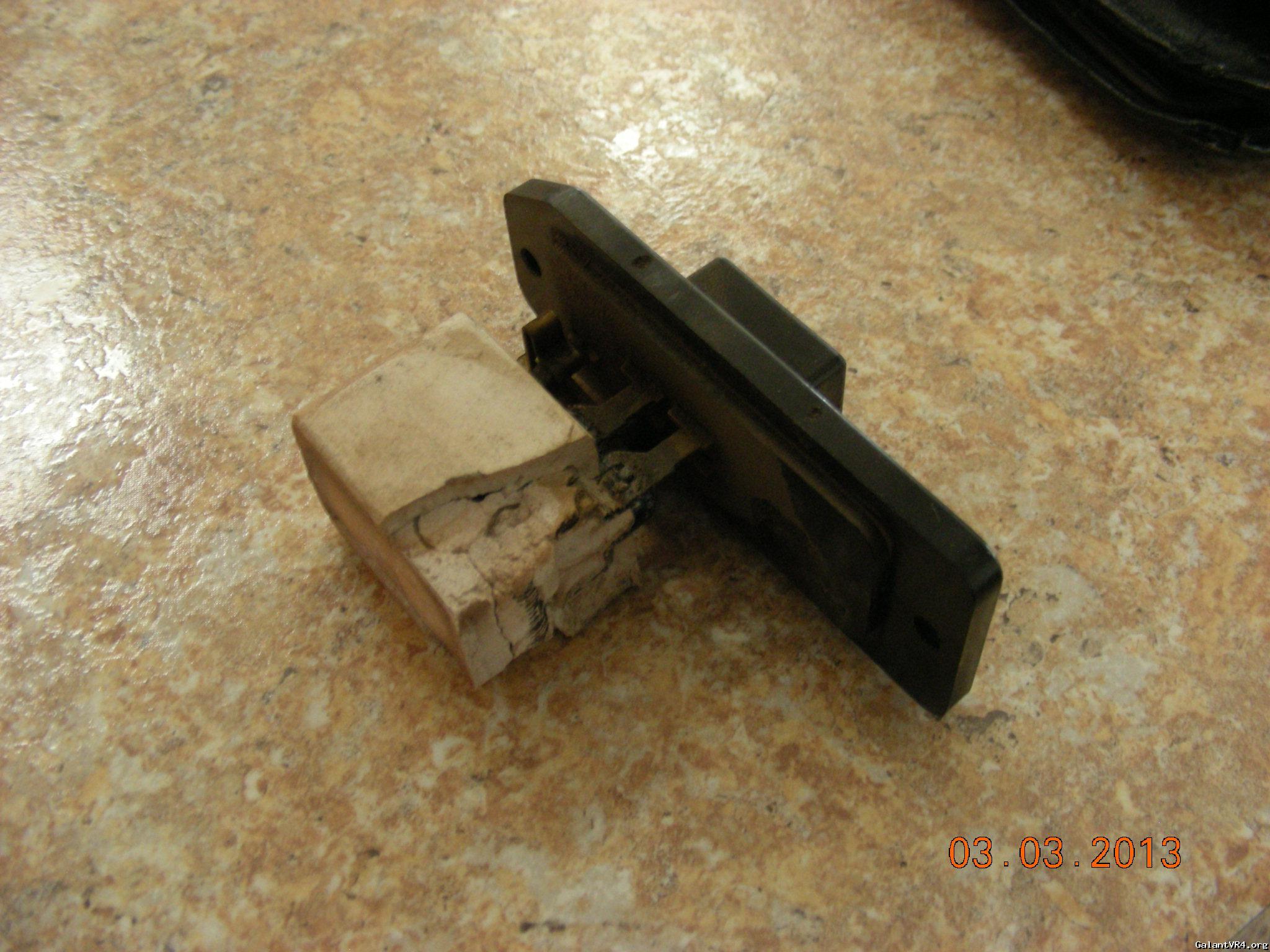

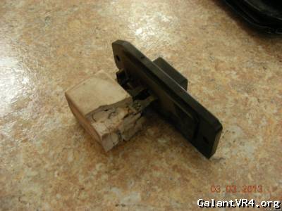

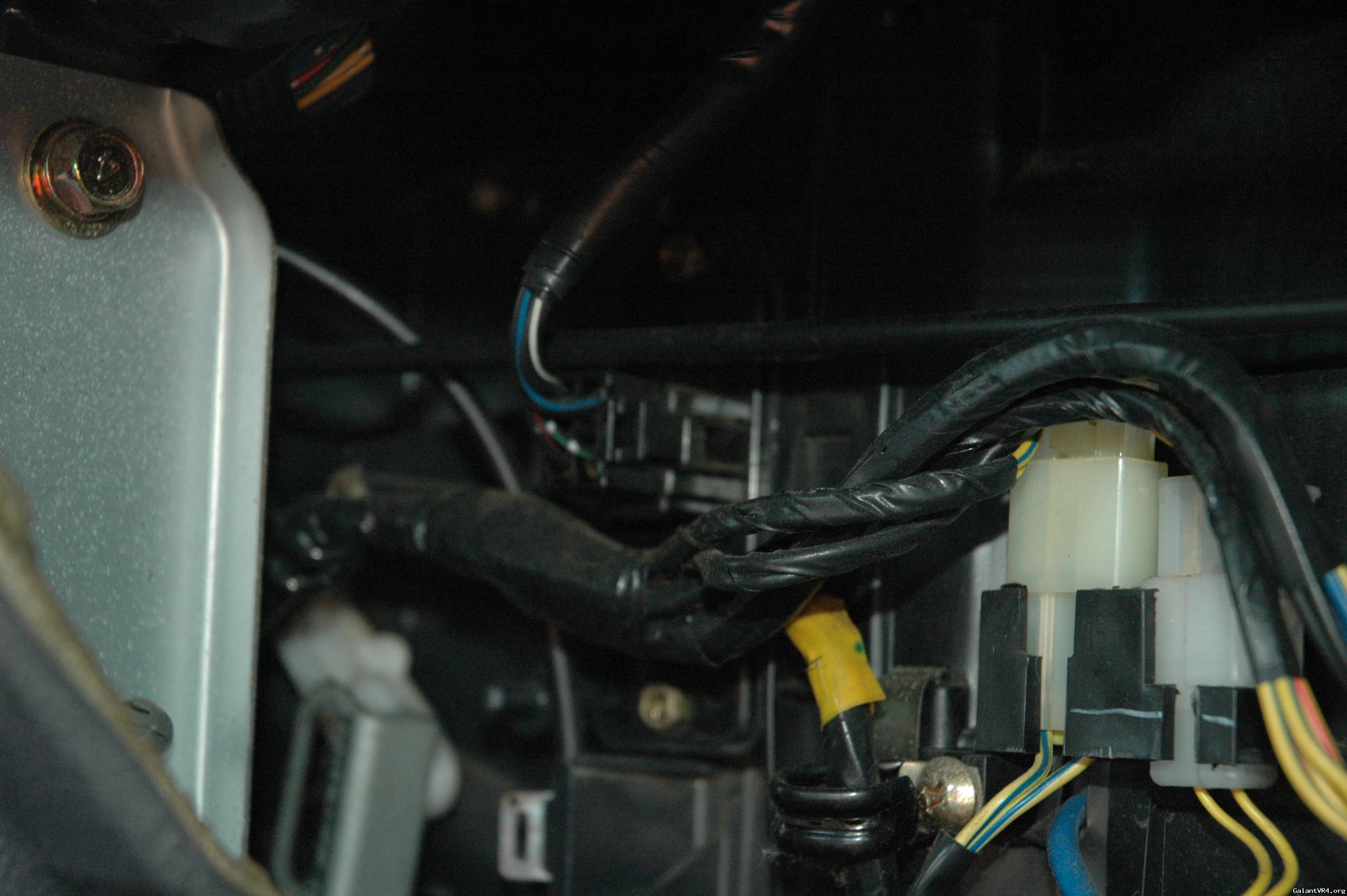

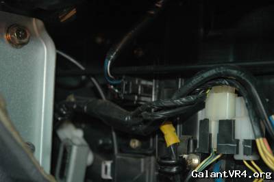

Yes it is the module black/blue wires going into it. It is held in with two 7mm bolts. It controls the fan speeds. I would just replace the whole module because it is cheap at around 10 dollars and took me 5 minutes to change out once I found where it was.
