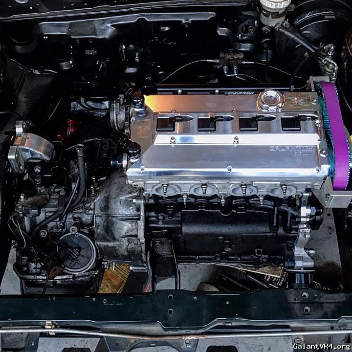

Motor and Trans are in. Gonna have to replace motor mounts with regular one. I have avid billet solid mounts. They are such a bitch to get lined up. Seems like the ATI balancer won't clear the frame. The trans mount won't line up. I'm hopping the less aggressive mount will free up some movement. Just got to order some and find out.

if you have the front and rear, and the drives mount on & snug in that picture, I kind of feel like one of the mounts you have is DSM and not galant (I can't remember if it's front or rear that's the issue).
I accidentally threw a 1g mount in my car once and the motor was just cockeyed enough that it made trying to bolt all the mounts absolutely miserable, until I took it apart and put the correct one in. If not... maybe it is just the billet mounts, but I'd check it.

The mounts from my auto gsx galant were different than the manual vr4 and the auto gsx eclipse. They had their own part numbers. I documented that elsewhere on this site.

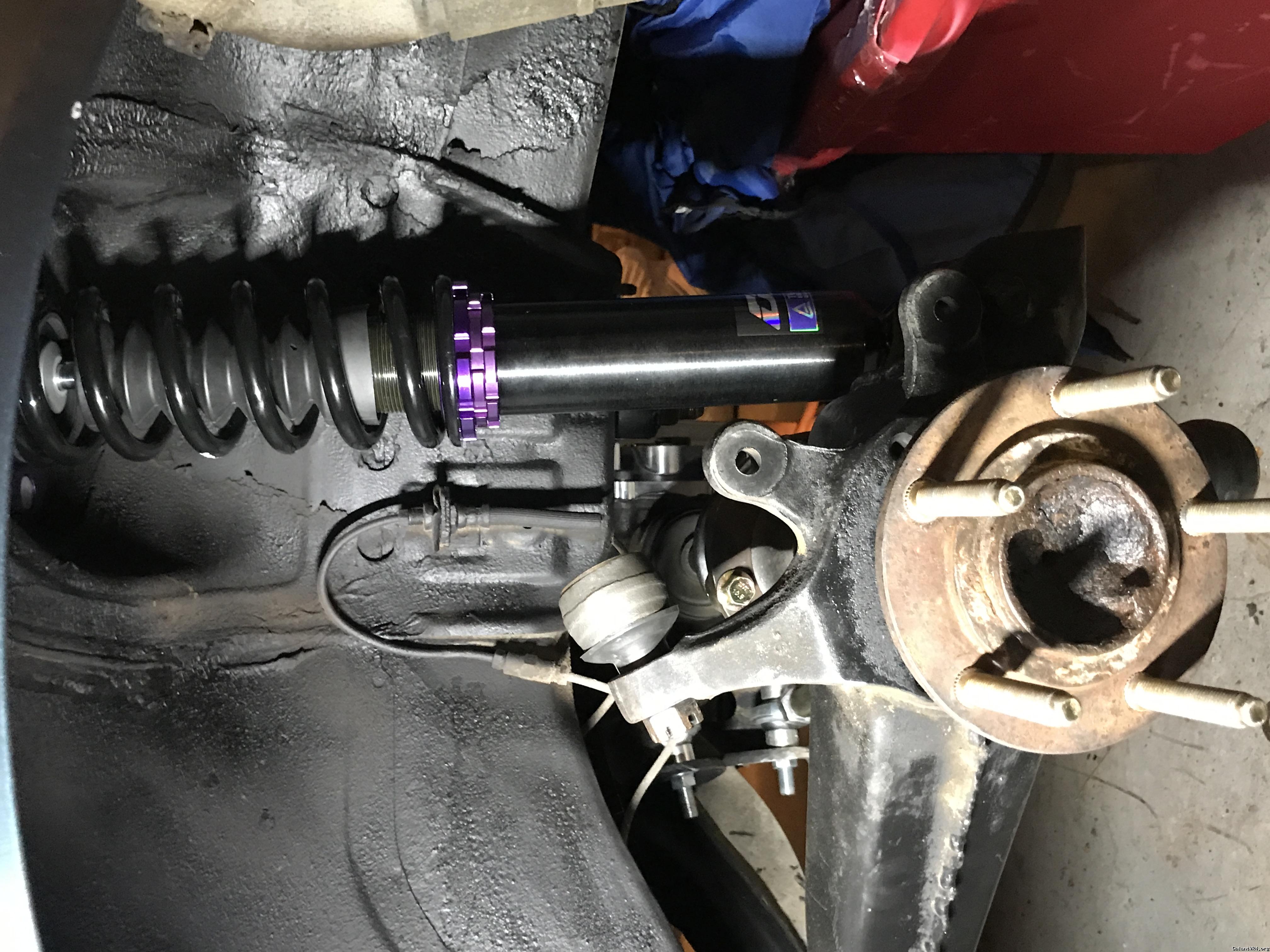

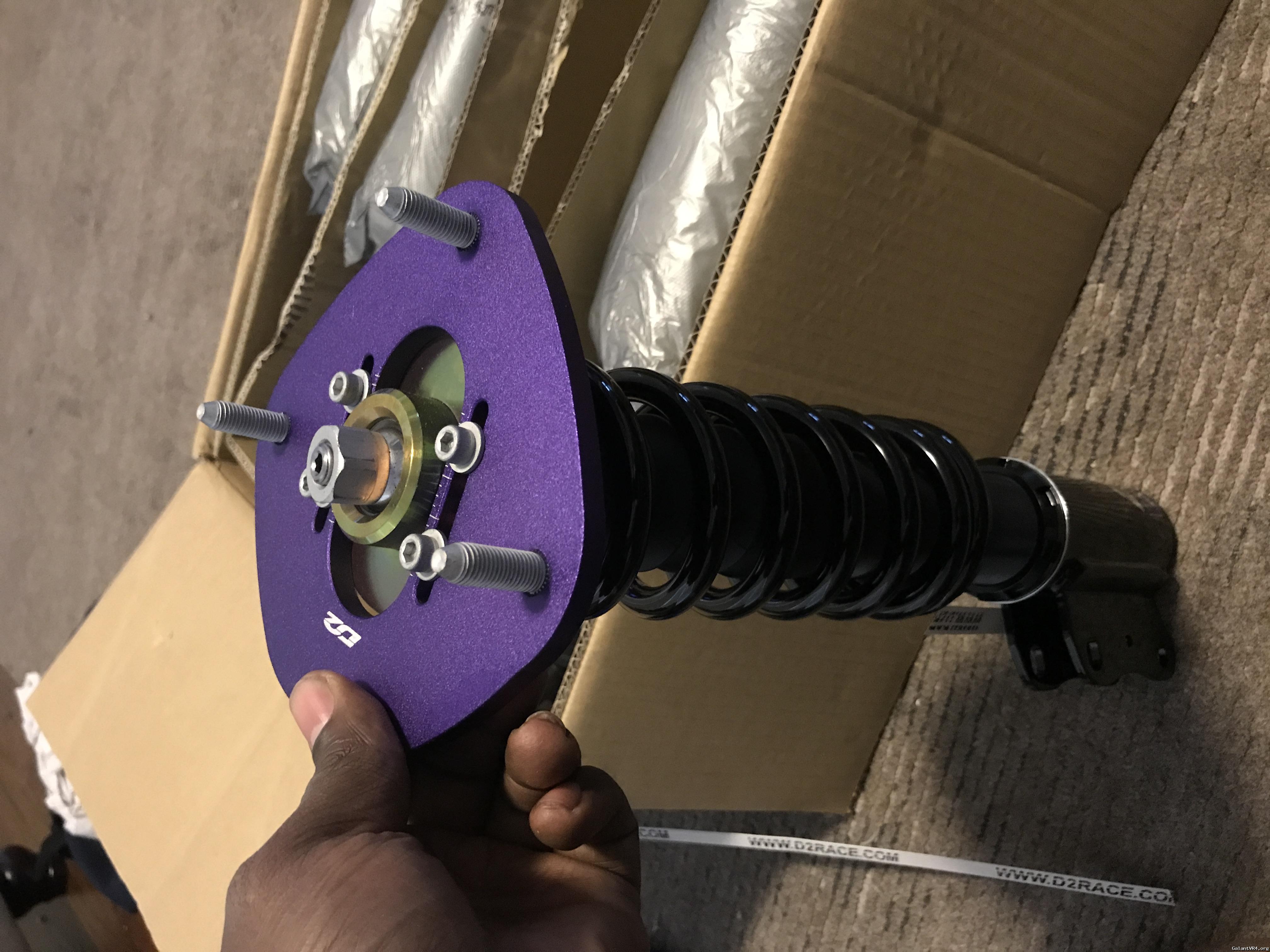

Coil overs came in today. Hopfully in the next two weeks I will drop the car to get the Fab work done, and then save for the computer /ubbthreads/images/graemlins/rofl.gif
