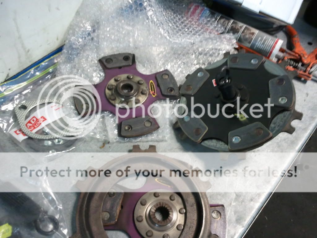

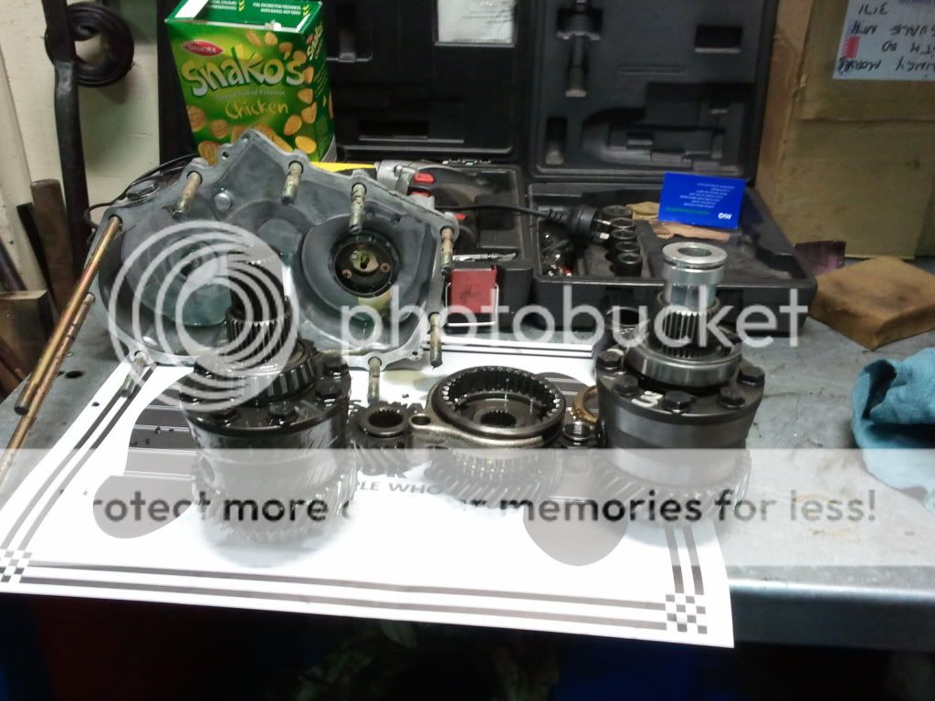

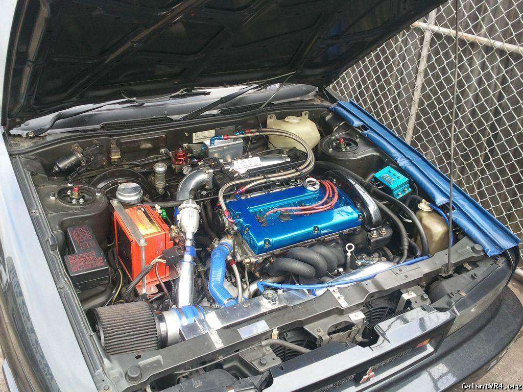

Twin plate discs swapped over for thinner ones.
The previous discs were XTREME discs which were not the designed discs to go into this twinplate setup. They were 8mm thick whereas the Direct Clutch discs were 6mm. Changing the discs over actually changed the noise when on the clutch (quieter now) and also stopped the 1st gear crunch which I'm guessing was caused by clutch drag.

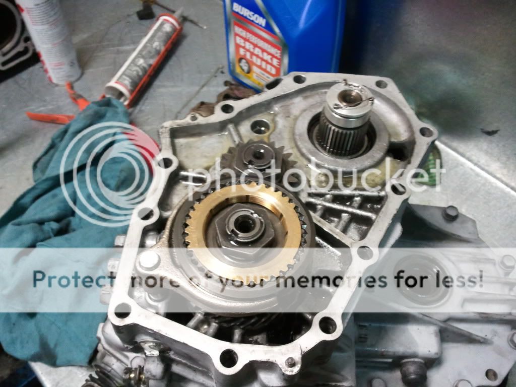

I also pulled out the stock 2 spider setup while the box was out and installed the TRE centre spool.
This takes out one weaklink in the stock VR4 box.

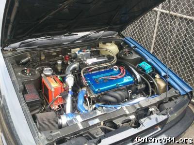

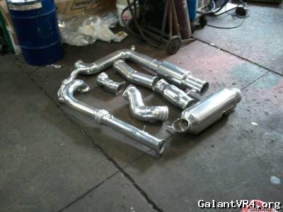

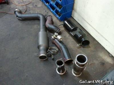

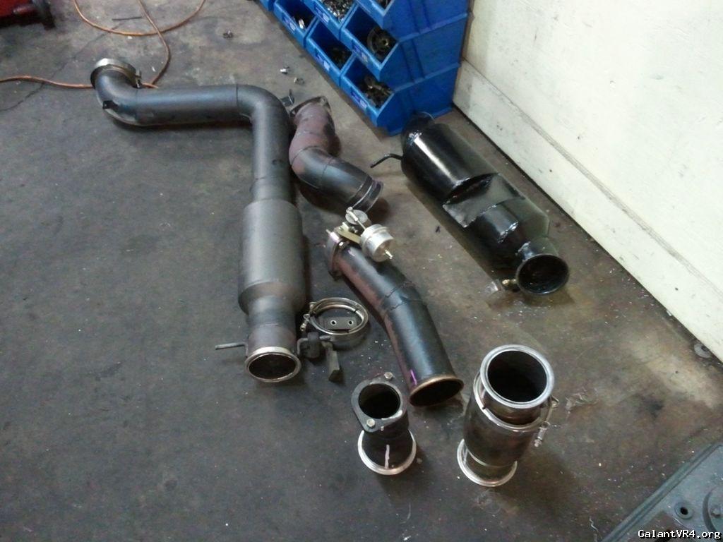

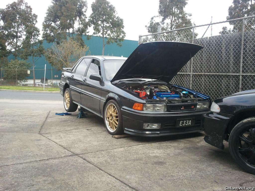

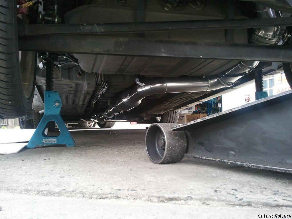

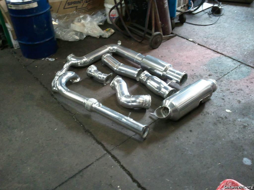

Exhaust before:

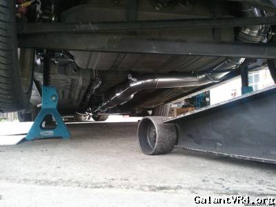

Exhaust after:

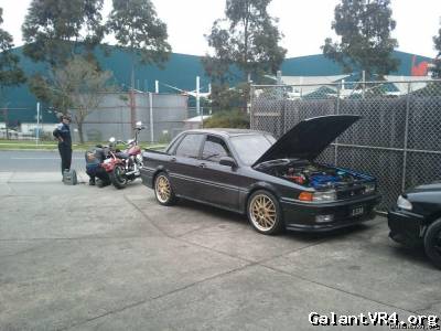

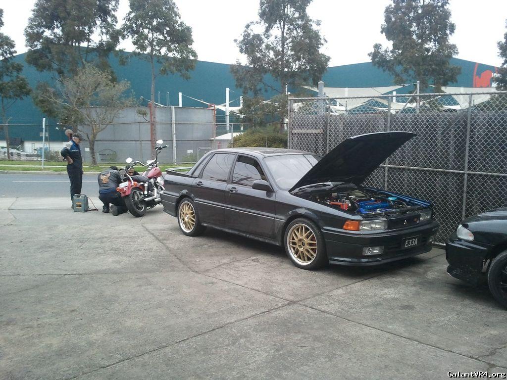

Playing with the exhaust (muffler / vbands etc etc) outside of Springy Motors
The boys playing with the Harley (missfiring V-2)

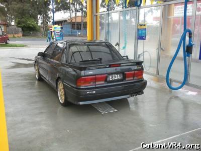

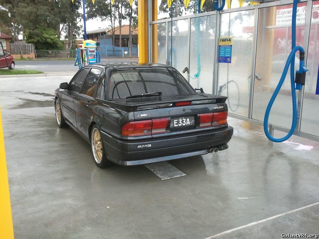

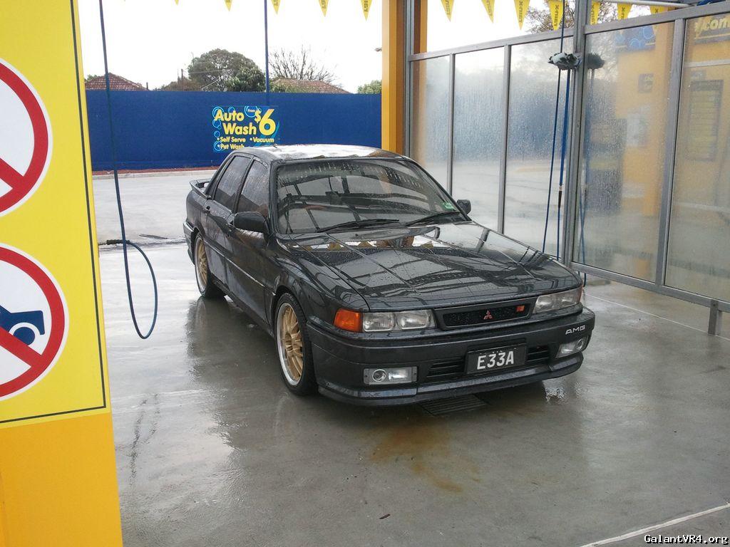

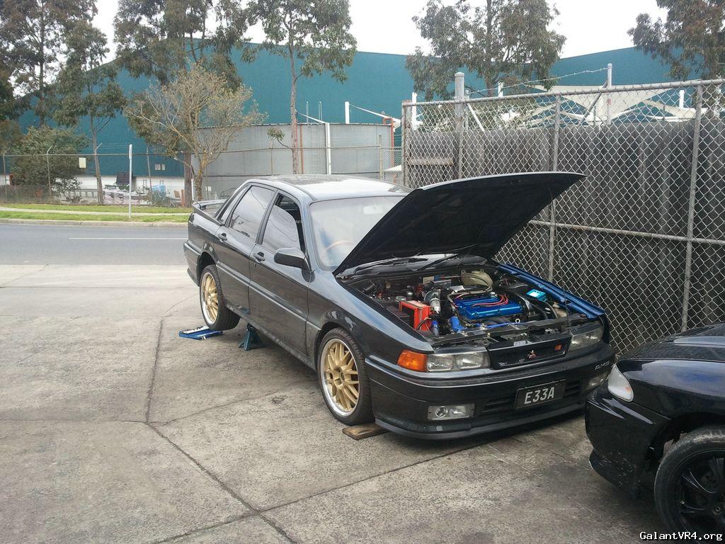

I took the car for a quick rinse at the local car wash.

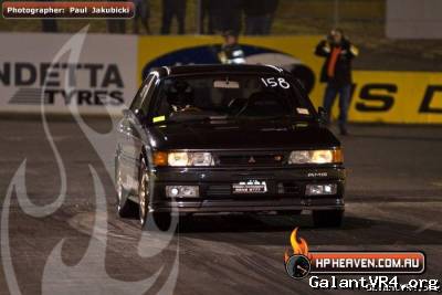

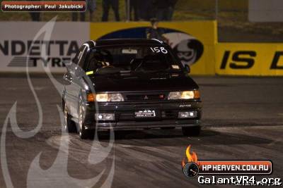

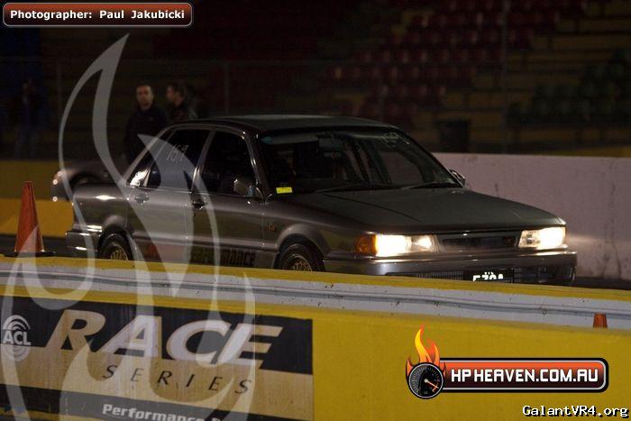

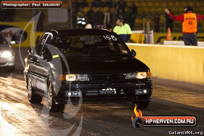

My brother took the car out and managed a flat 14 second pass...lol
The thing was wheelspinning all the way down the track.
It ran a 14 @ 111mph with a 2.8 60 ft time.
Still on street tires and poor suspension settings (forgot to play with the suspension because the vr4 broke)
Hopefully will have it out again sometime and aim to get into the 12's at least.
It is making 277kw's at the front wheels with 20 psi of boost.
