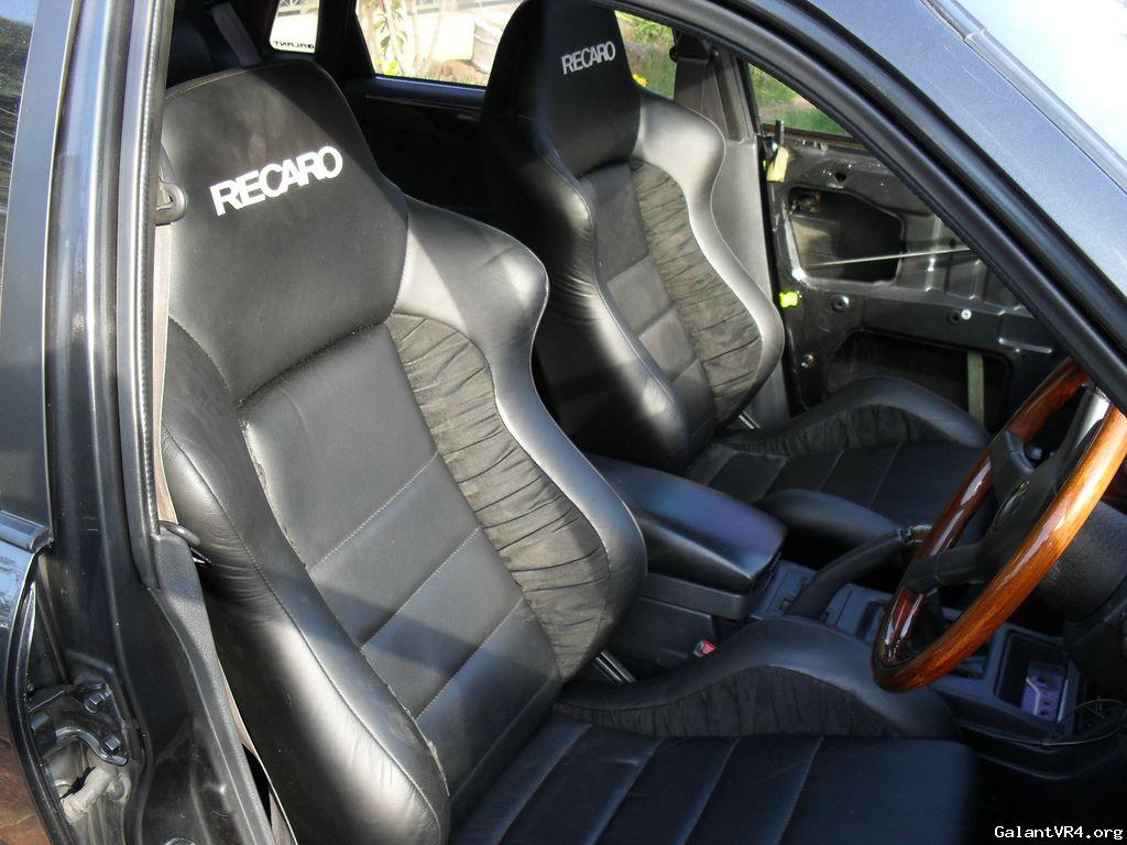

Hi Guys,
I just thought I'd post up some quick pictures for you guys.
I'll do a better write up when I get some time.
Enjoy the pics!
Very nice install. Allthough I'm Sure a few of us are looking at those AMG seats drooling /ubbthreads/images/graemlins/jawdrop.gif
bazeng
Feb 6, 2003
2,520
Melbourne, Australia
I'm not 100% sure what they came out of, but they are retrimmed front and rear seats out of another VR4 that I purchased (white one).
The AMG seats are getting retrimmed to original specs again because they are all cracked and then I'll keep them in storage for if I ever return the car back to stock.

Love this photo.
Also great choice of wheels, are those OZ's? I always dreamed of doing a big AMG style wheel on a real 6g AMG.
Interior looks plush /ubbthreads/images/graemlins/cool.gif

Alot of car to buy just for the box Baz, what are the plans for the white one?
Iv seen that interior in the flesh at jambo very nice pick up mate.

The interior is in the AMG.

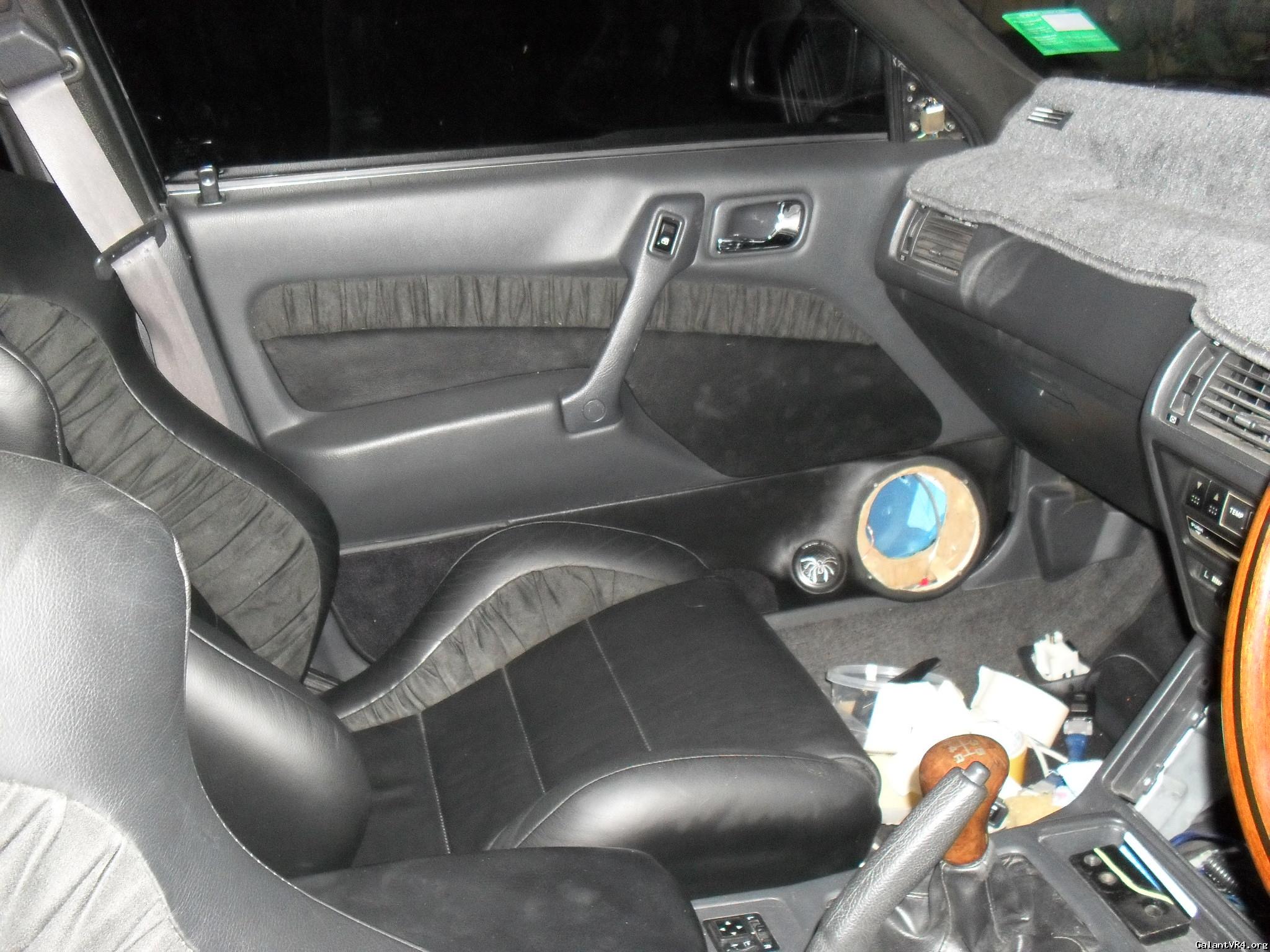

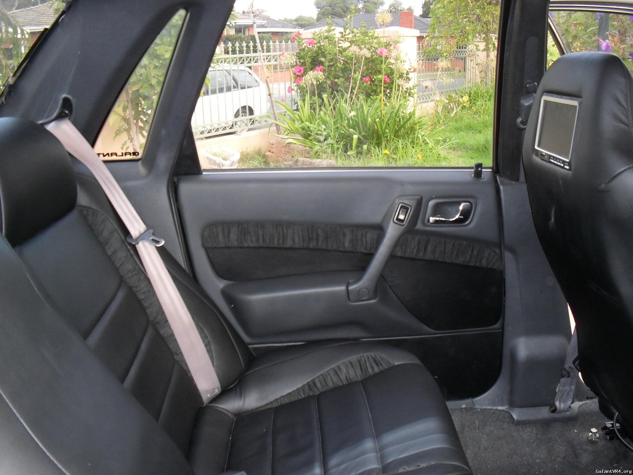

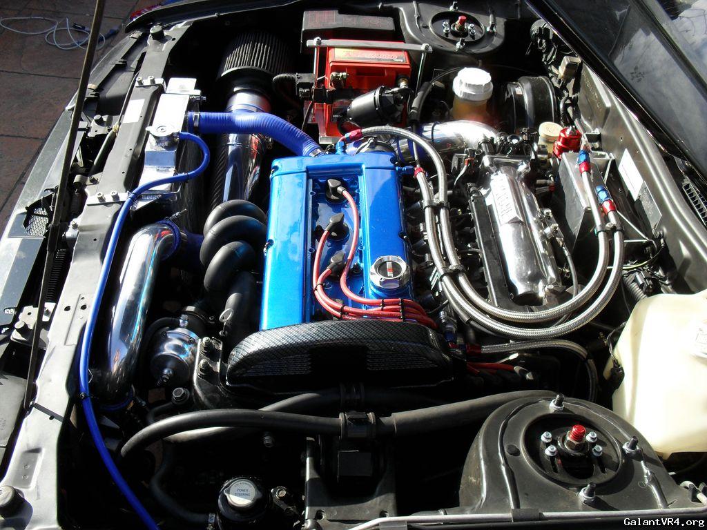

More pics of the interior

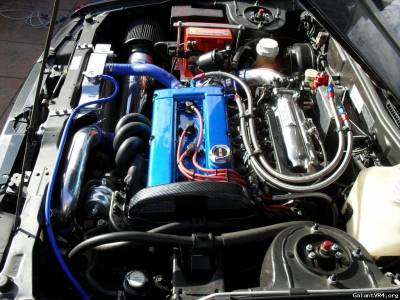

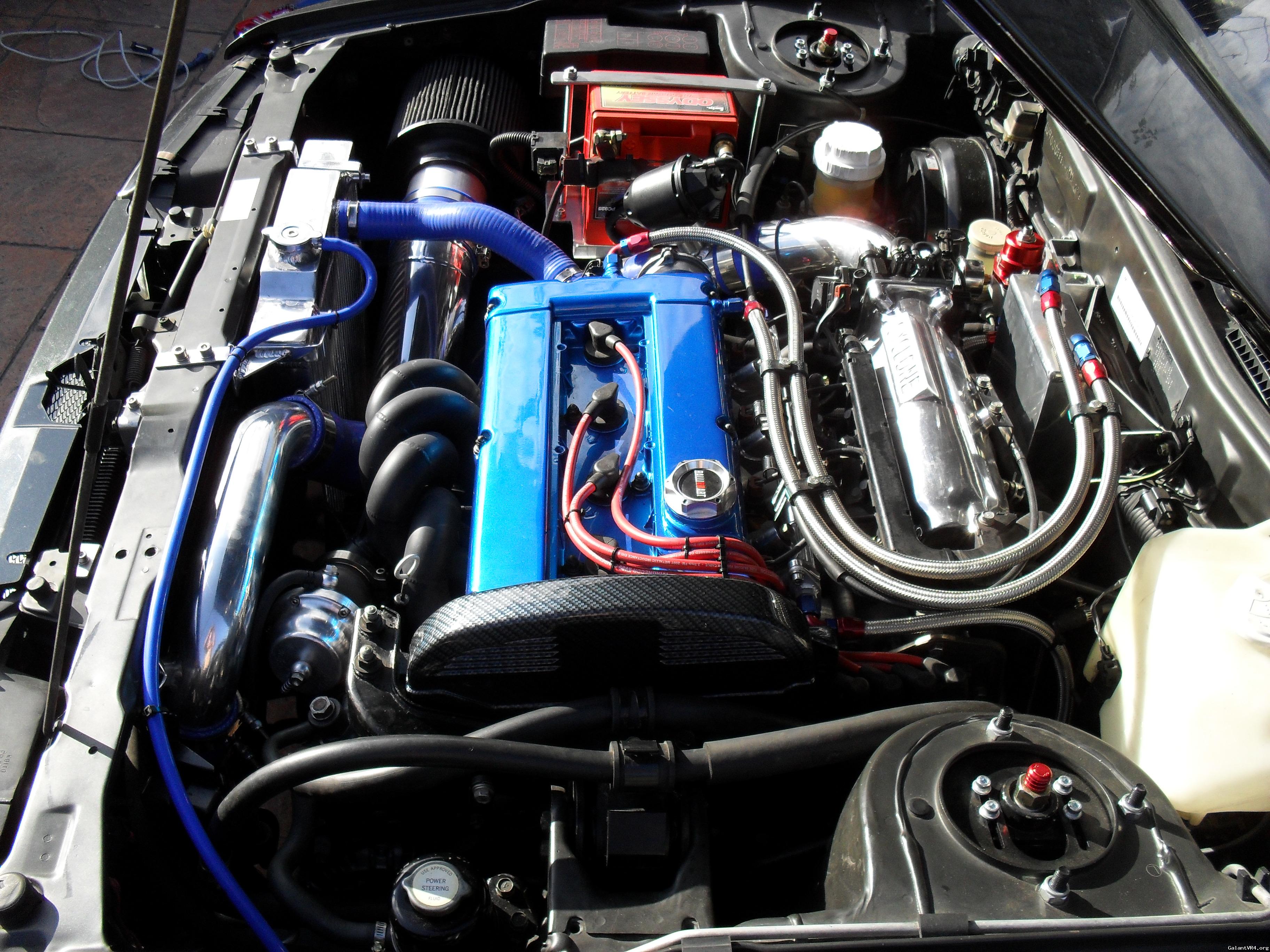

Pic of the engine
Bazeng & Springy Motors built 2.3L stroker - Eagle / Wiseco / Hyundai crank
Custom spec - GT3082
Mild head with Crower cams (264 equiv) - stock valves - crower springs / Ti retainers
AMG intake manifold with stock AUS SPEC VR4 T/B.
MOTEC M4 - self made plugin loom
3"dump pipe to cat. 4" cat to muffler
Civic radiator (not overheating!!! works quite well!!)
ARE 600mmx300mm intercooler
HKS timing belt
Stock ignition system

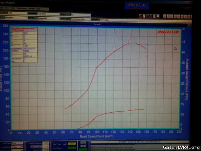

It made 220kw's at the front wheels with only 10psi of boost!! Run in tune.
The gearbox is a VR4 RS box with a viscous locker to run in FWD mode.
It has hotbits D2 coilovers all round.
Camaro big brakes up front.
Stock rear with slotted rotors.
All luxuries retained!
Aiming for 11's in this baby. 12's would be fine also!
Pics of the car:
Dyno Graph - run in tune

If you look close at the parking garage shot you will see me with a pair of screw drivers and a pry bar waiting for the lights to dim so I can steal those sides. Cars are looking sweet brother love the Recaros.

Those recaros have screens cut into them too? qqq

1. Front speakers spacers (I don't want to cut the doors to fit the new speakers)
2. Headunit - Some sort of DVD player thing. I'm so out of touch with car AUDIO + some sort of sub woofer and amp in the rear
