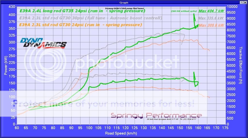

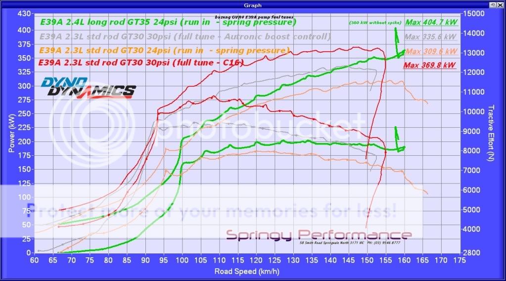

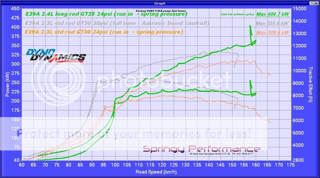

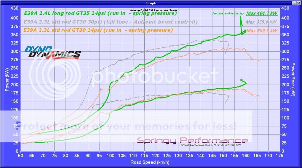

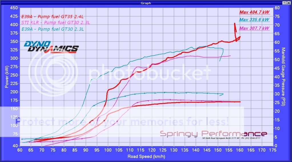

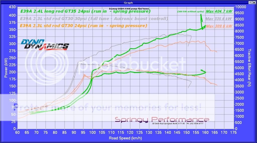

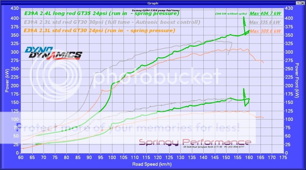

Hey guys,
I got bored after work so dropped by Springy Motors for a play on the DYNO COMPUTER.
Enjoy some different specs of my various 4g builds.

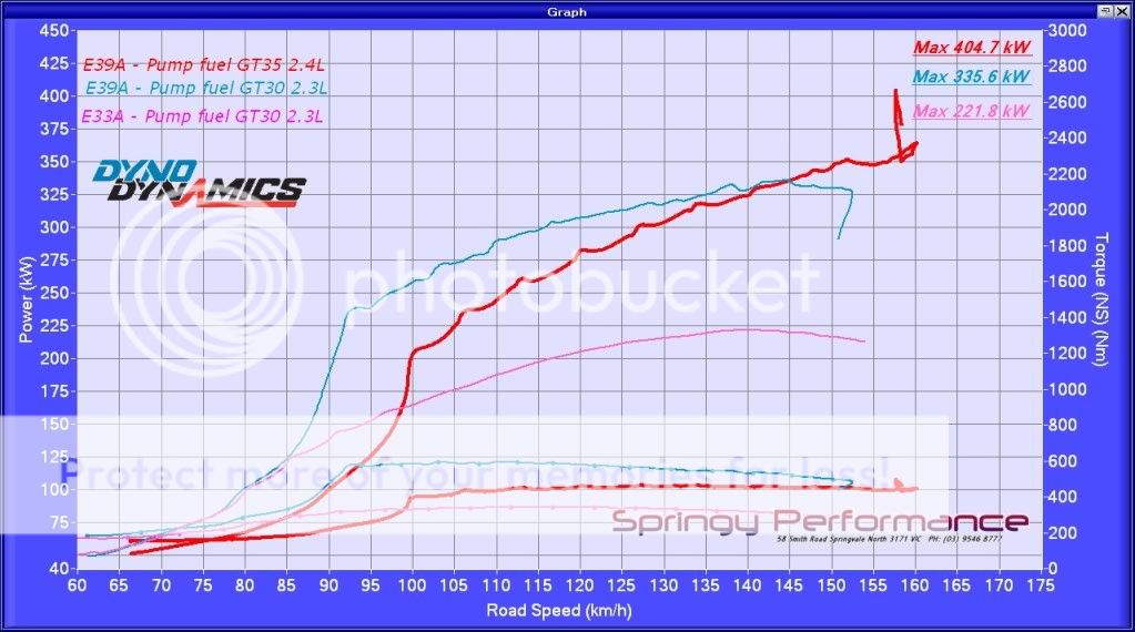

E39A 2.4L (my current setup air to air)
E39A 2.3L (my old setup water to air)
E33A 2.3L (my old setup with stockish head and AMG intake manifold)
STIKLR (you guys know that car)
I've had enough dyno play with my car. Time to not break and start racing.
link

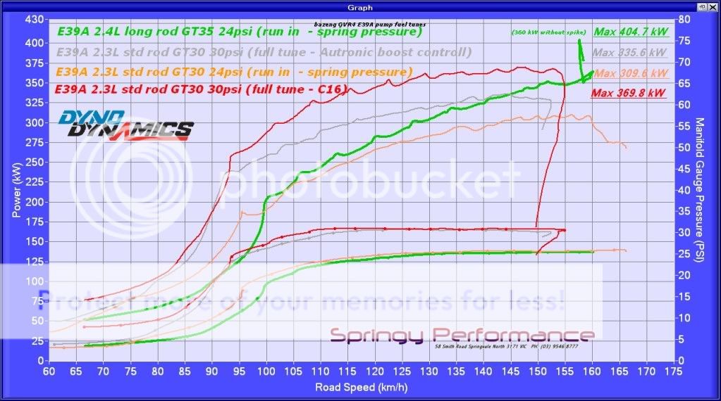

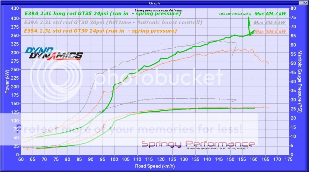

What I found interesting was the difference with an ELECTRIC BOOST CONTROLLER vs SPRING PRESSURE on the waste gate.
Also, my old GT30 setup has a much better power band than the new GT35 setup BUT that is based on a full tune vs run in tune. If you compare run in vs run in tune, the 2.4L is better.
Also C16 makes a massive difference doesn't it!! I've got a log that did 400kw's but that isn't really fair coz the block cracked on that run!
STI KLR has run high 11's with his setup and wheel spin, hopefully the VR4 can do better once its out there.
The AMG power curve looks promising! It spools up very well and with more boost, it should easily pump out 300kw's at the wheels on about 20psi (fingers crossed).
What do you guys think?

Great figures Barry but what is the limiting factor between the E33A with the AMG intake manifold compared to the VR4. Both 2.3 litres on a GT30 and pump fuel but over 100KW difference in power?

Any idea what that AMG Cyclone manifold is good for, I'm thinking of using one for a mild street build as I told you. Do you think it would be good for say 280 kilowatts?
bazeng
Feb 6, 2003
2,520
Melbourne, Australia
Easy.
The manifold itself is larger than the AUS SPEC / US SPEC single runner ones.
They have a massive plenum and long runners (twin).
I'll let you know how it goes with 20psi of boost.
