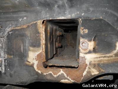

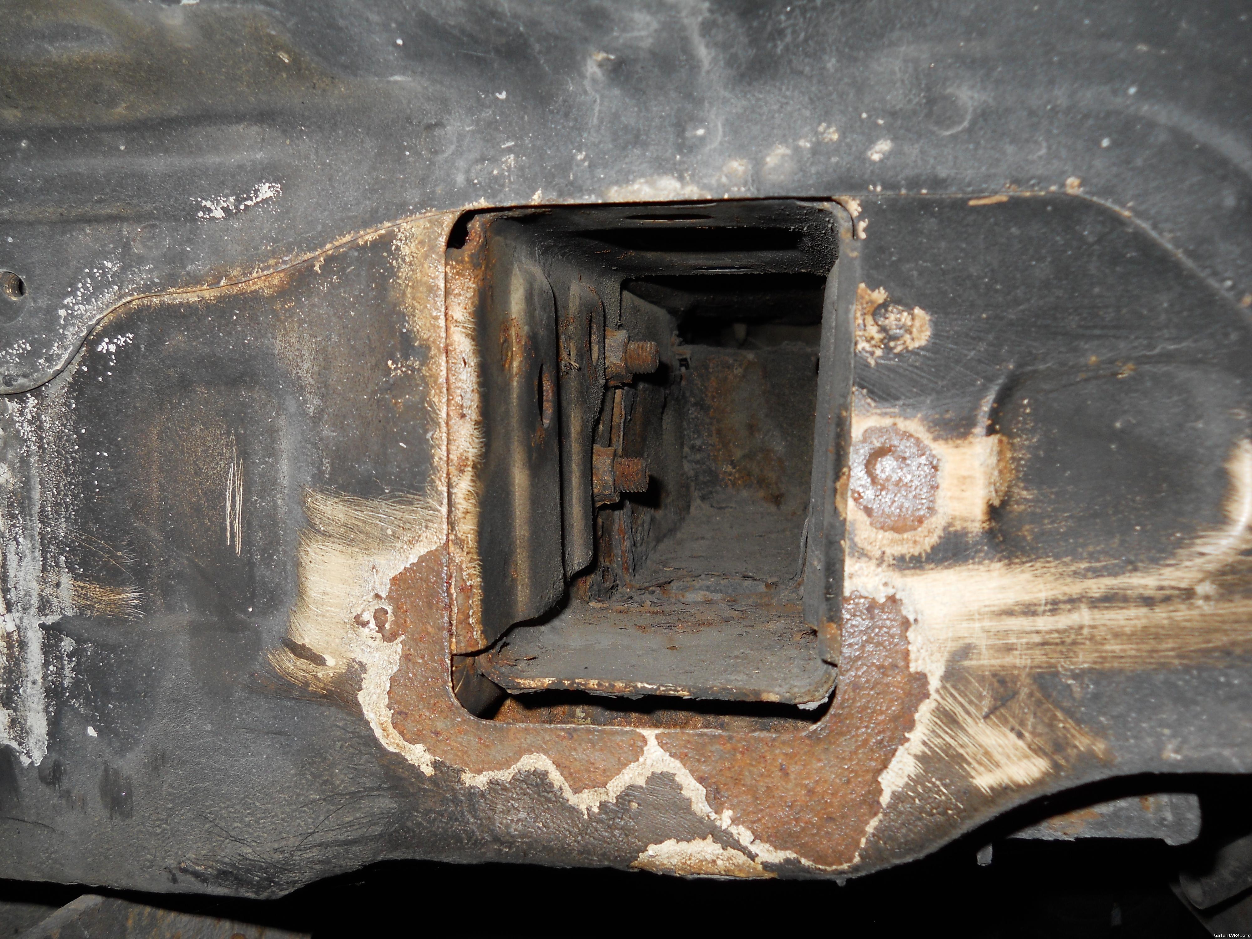

The E39A Galants sold in sweden were equipped with the JDM bumpers, so these towbars were made primary for a JDM bumper equipped E39A Galant. But that's actually not an issue for us who have the US bumpers! I had this towbar on my GVR-4 with US bumpers and there wasn't any issue at all! /ubbthreads/images/graemlins/smile.gif Also, it is bolted to the chassi in excisting holes from the factory, not the bumper or it's reiforcement bar.

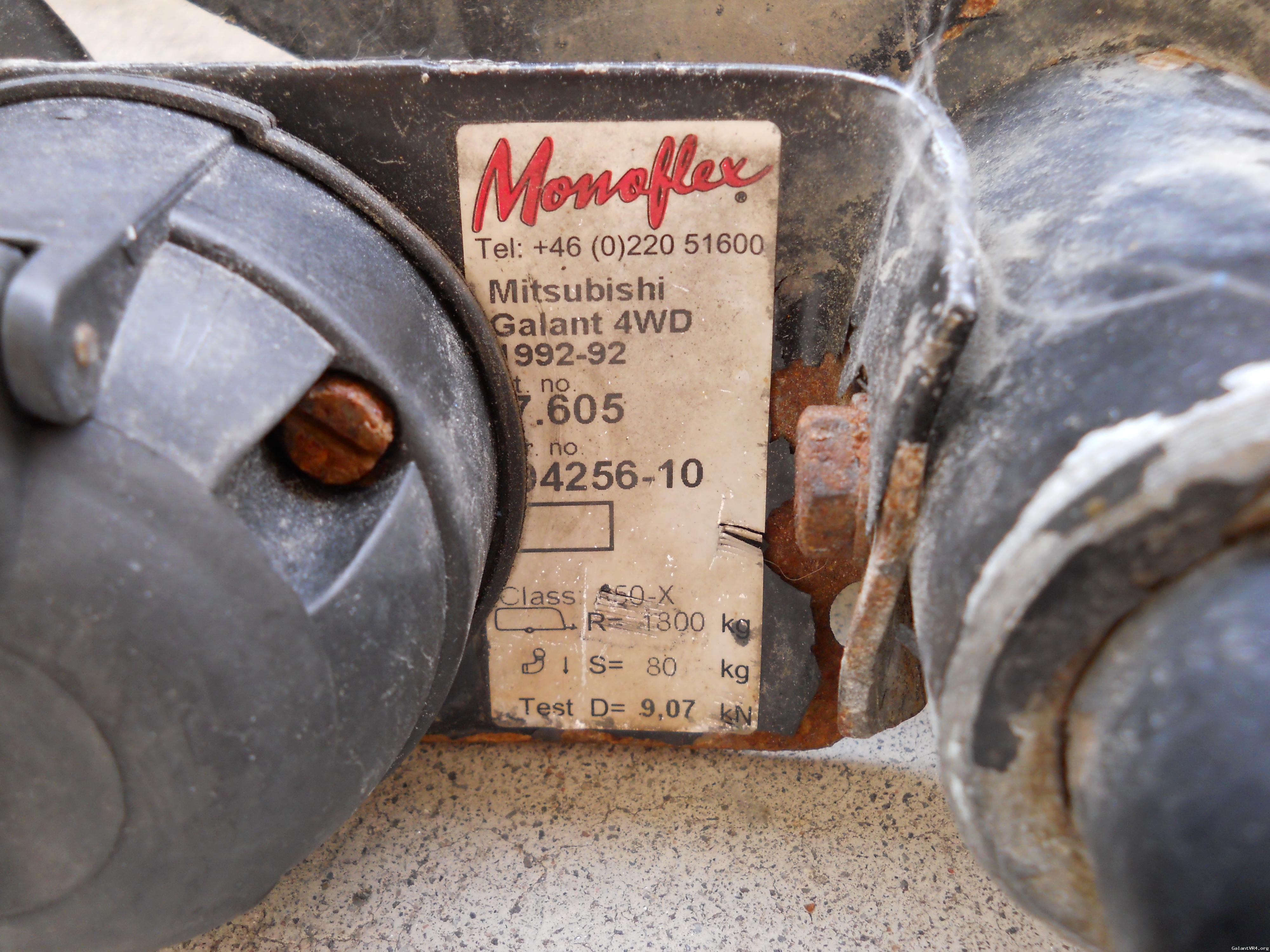

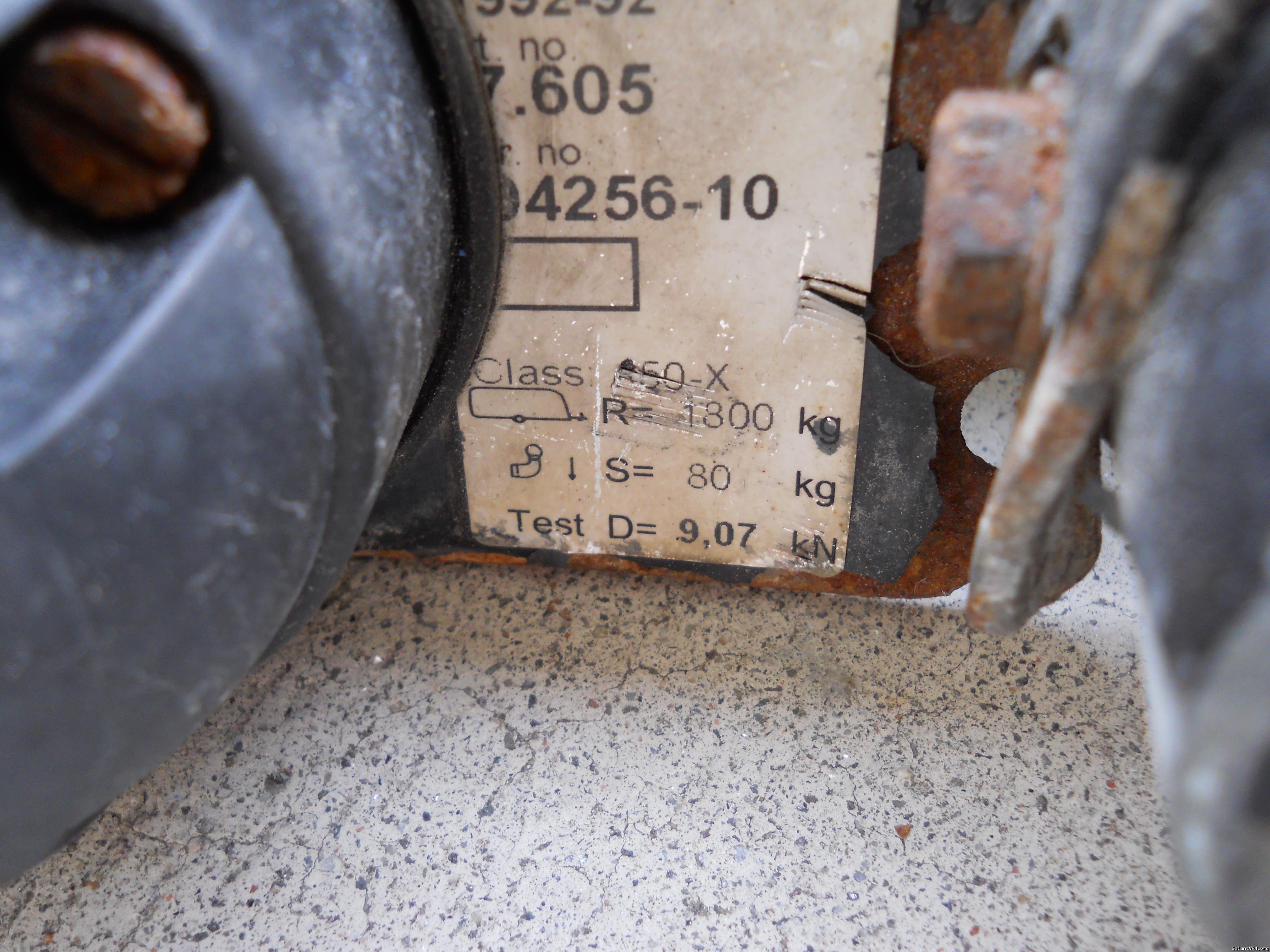

The good: Direkt bolt-on to the chassi, no need to cut anything! It pulls alot of wheight, 1800 kg or ~3900 lbs!

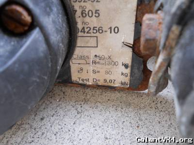

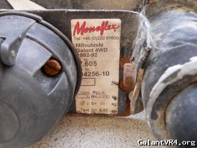

Proof of the wheight specs:
I also have the install manual in PDF where it verifies the wheight specs!

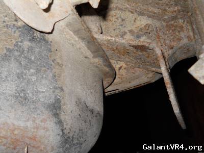

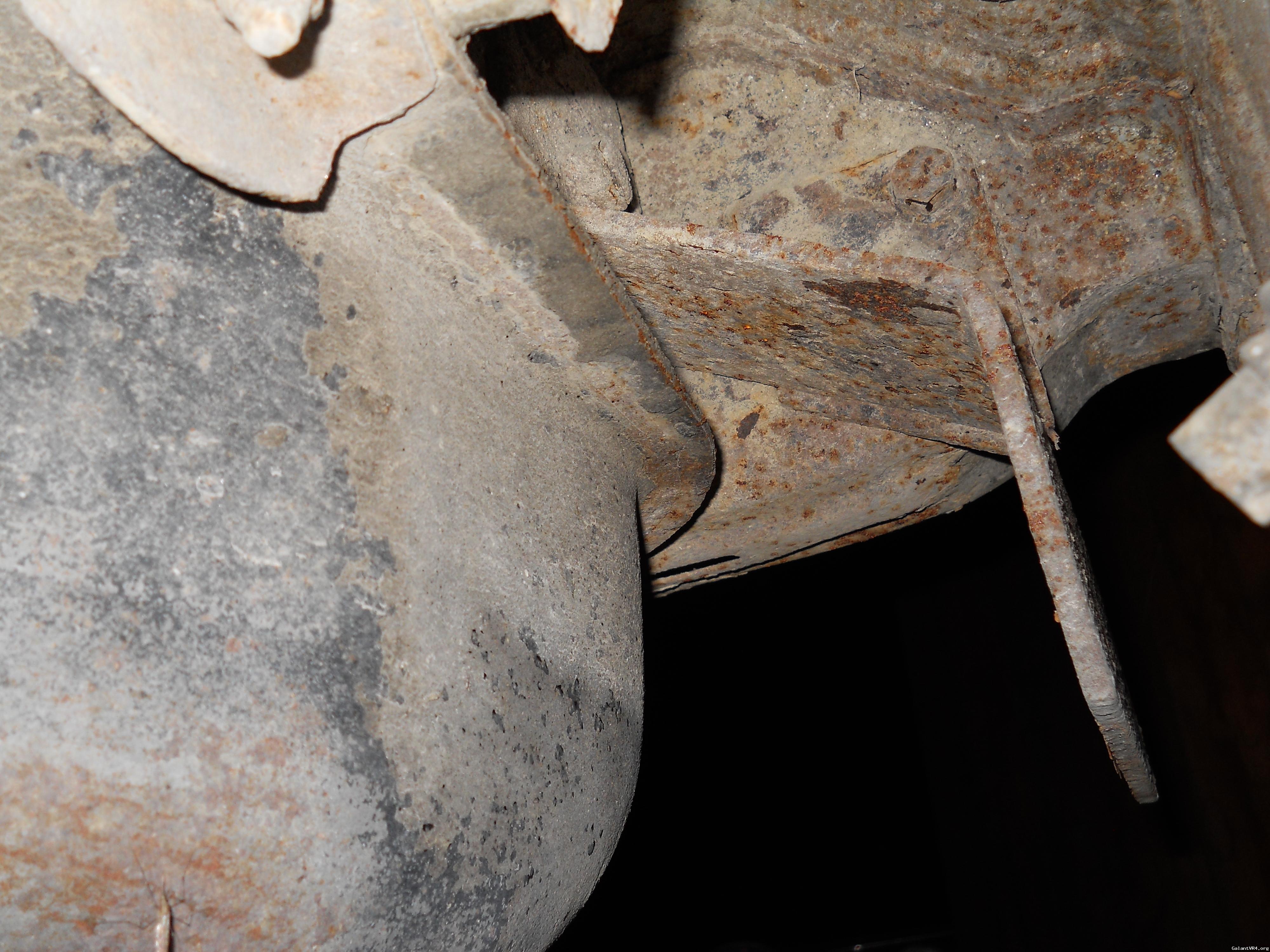

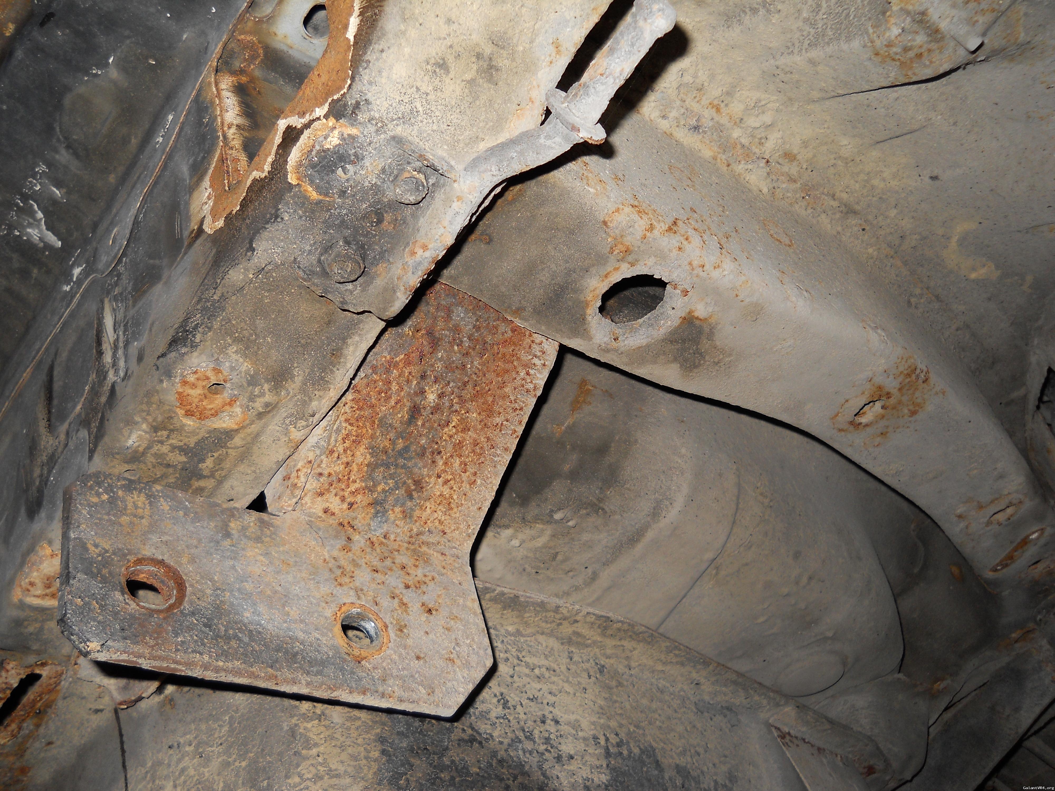

Right side angled fastener:
Angled fasteners uses factory bolt holes (each side uses 4 bolts to the chassi)

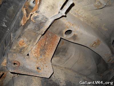

Left side angled fastener:

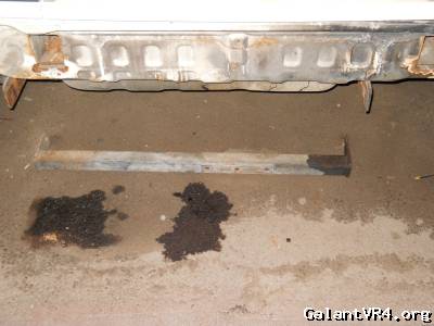

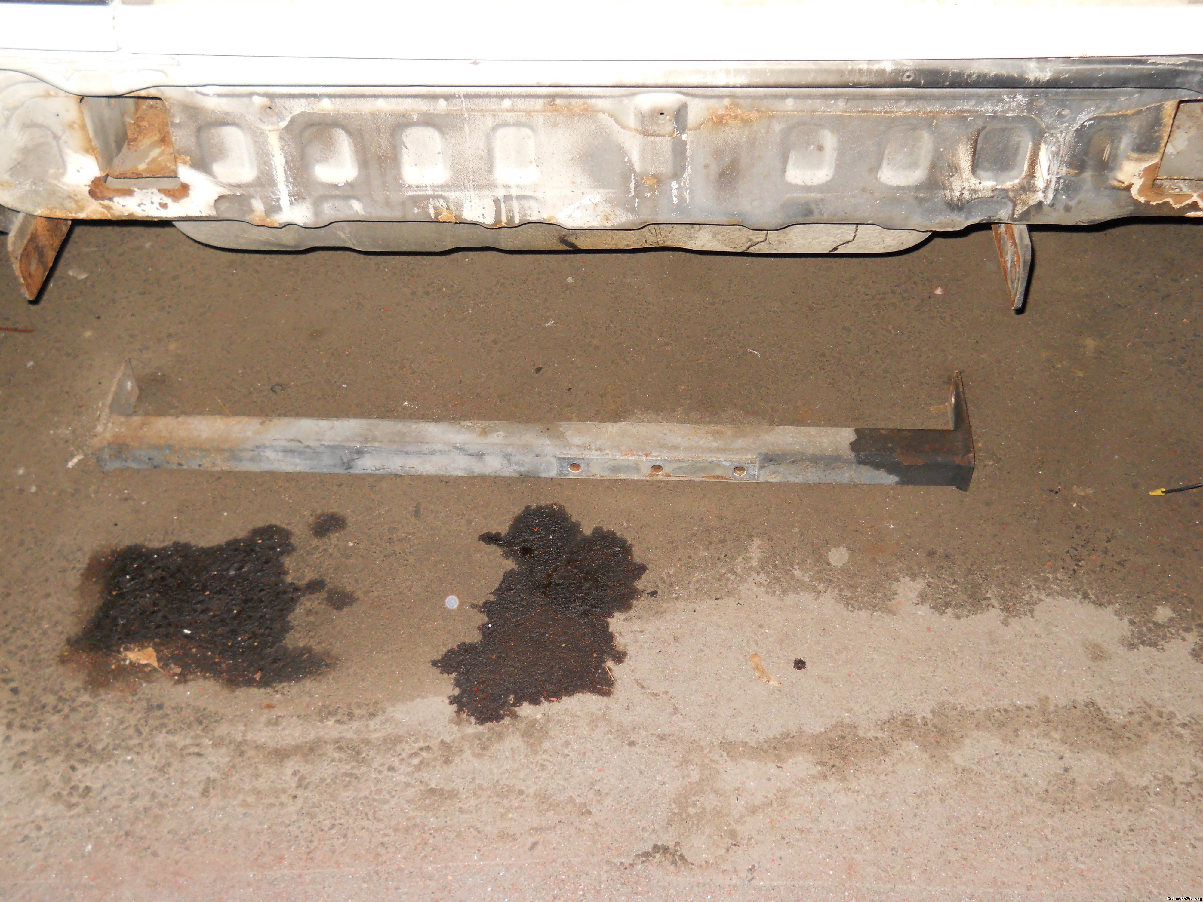

Bar that goes between the angled fasteners:
These parts might not be alot, but maybe it's a start for someone to make a custom towbar??
