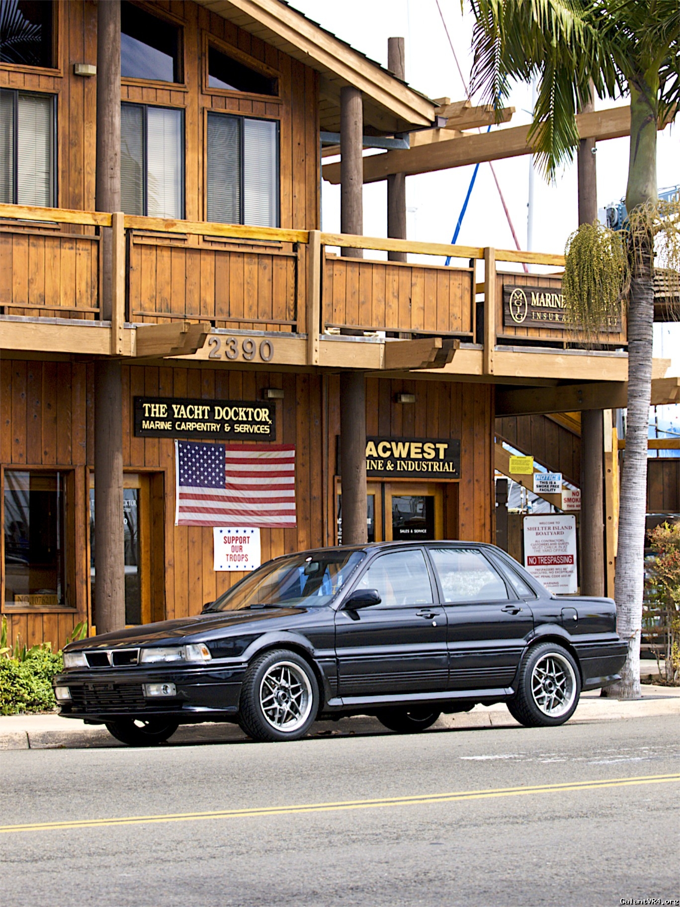

Here's how she stands right now, with the Evo Sus.
