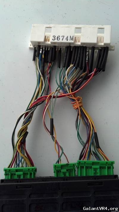

Any intrest for plug and play Evo 8 to 1g set up .. w/pic
QnzMostWanted
Jul 10, 2011
66
Orlando, FL
8th gen ecus cant be used, as the pinouts are different and will require alot more work to tune, this is a plug and play option for those who want it, jumper harness, obd2 port, flash port and ecu, with a deleted immobilizer, tuned to stock evo specs, if u want something different, then u would have to get it tuned, this is gonna be a turn key setup, once running, u can scale ur injectors to suit and tune the car at any respected evo tuner or urself

So i am almost done with the first one and it was such a PIA DAMMM /ubbthreads/images/graemlins/banghead.gif, Anyway i still have to test it, add the OBD2, seal/solder the connectors and add the Braided Sleeving

This is a plug n' play harness to use a Evo 8 ecu in your car and all their tuning software.
