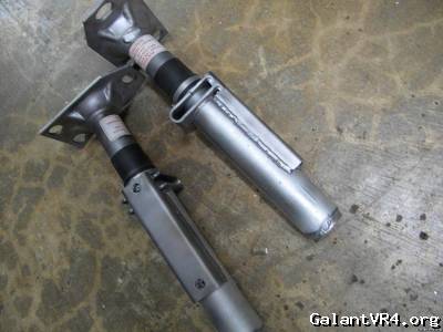

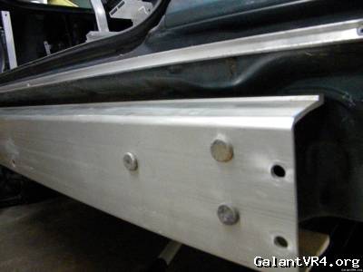

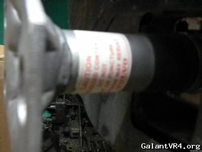

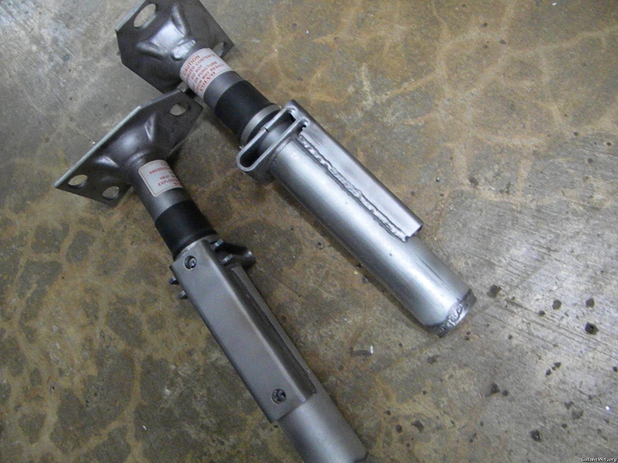

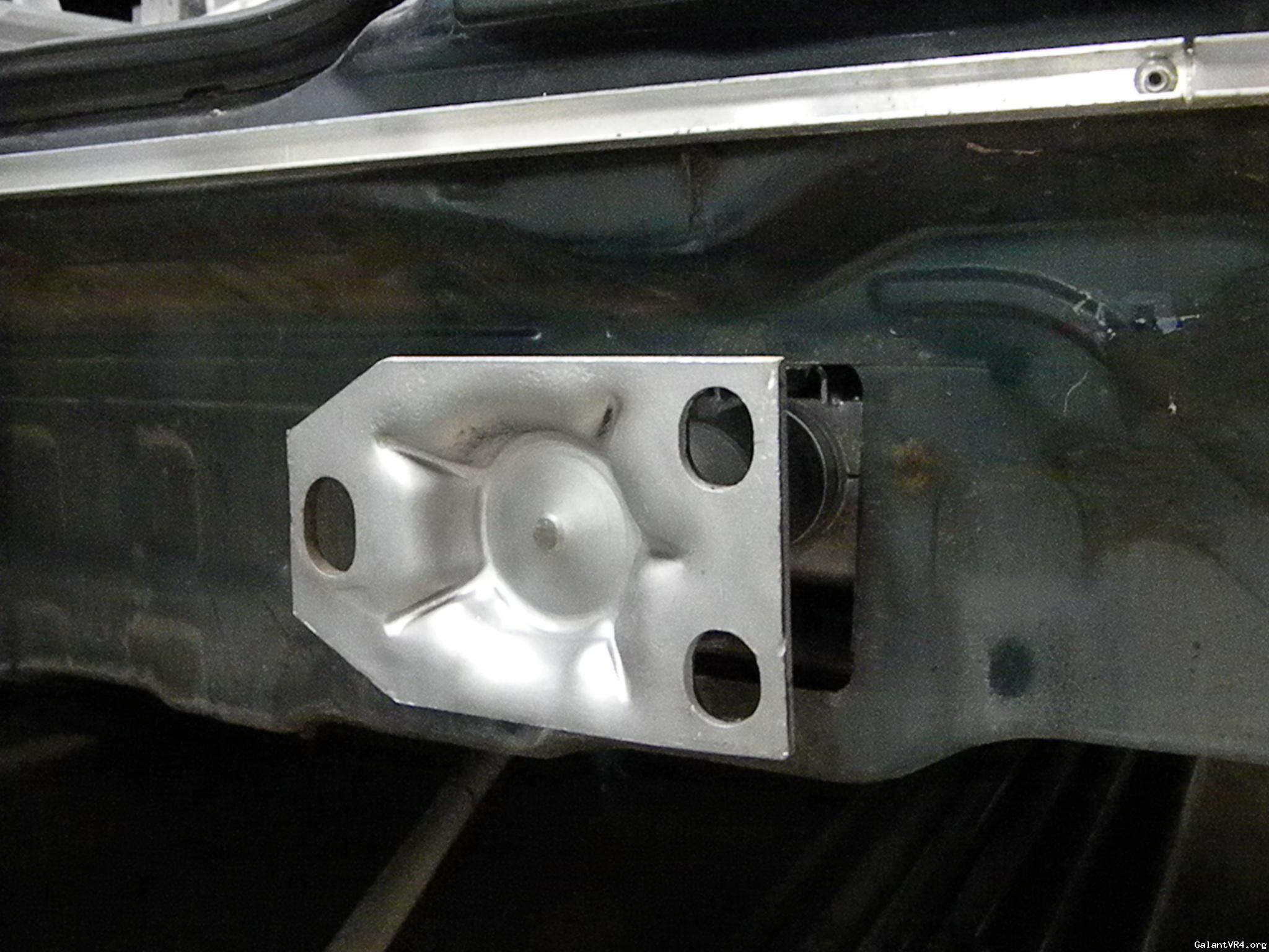

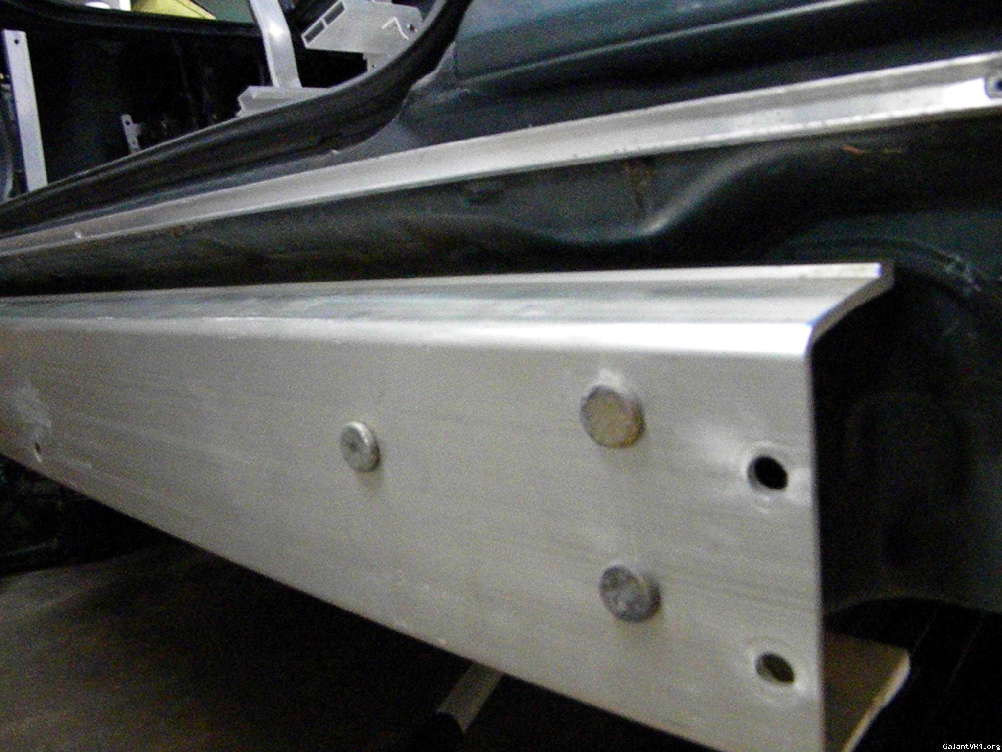

Volvo bumper core and Volvo shock dampeners total weight of everything 22 lbs

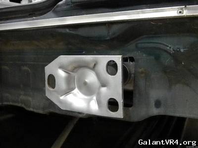

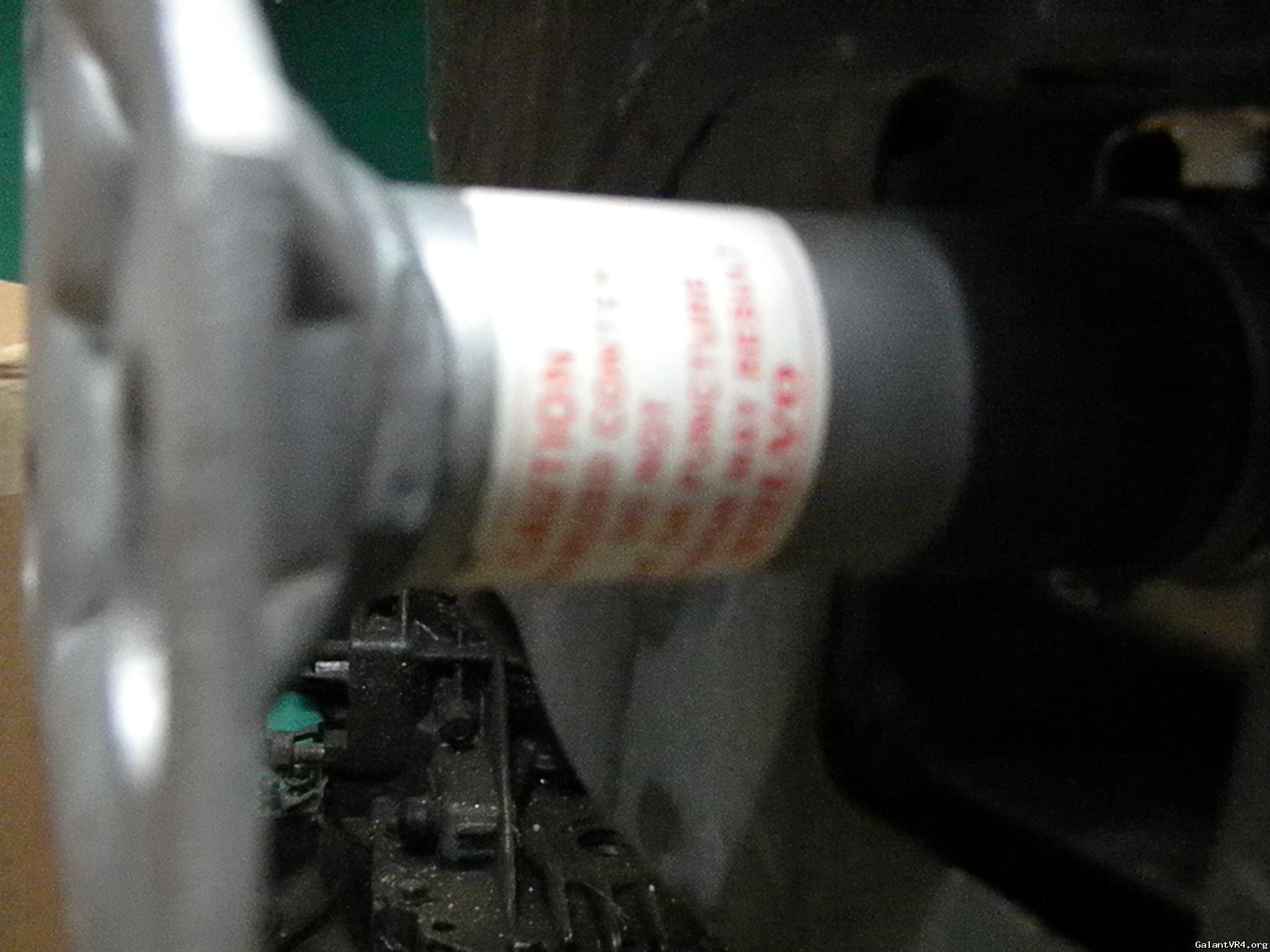

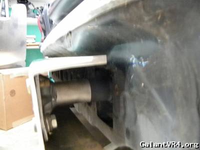

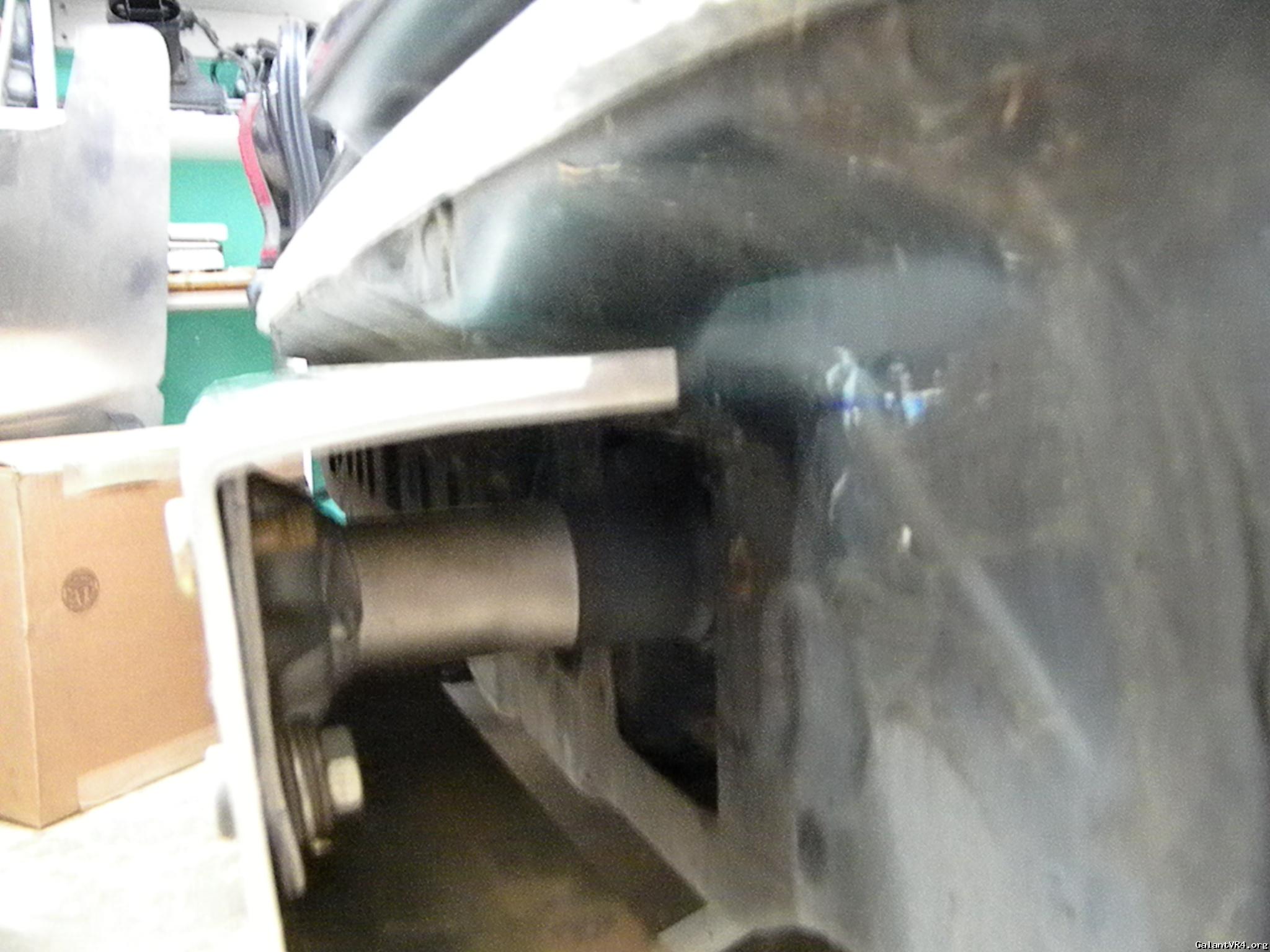

Cut the tops off the extra factory mounts I had then tigged them to a piece of exhaust pipe then slid them over the Volvo shocks and welded the front to the extra piece of metal that was there from the factory that I milled off and welded the rear of the tube to the area where there's no fluid/slime/whatever they use inside that's under pressure. If you do this pay attention contents under pressure and welding could make a big mess when the thing explodes. After that cut the bumper down in lenght and lined it up on the mounts marked and drilled holes to size and pressed in the Volvo factory studs. Placed on the car to make sure it fit and took these pictures and no not for mine but from someone on here, by the way I suppose were now in stage 2 . /ubbthreads/images/graemlins/rofl.gif Sorry inside joke. /ubbthreads/images/graemlins/grin.gif

Yea welds could have been better but trying to direct the heat in the opposite direction away from the shock and cooling it off every 1/4 inch with an air nozzle was a pain but better than it blowing up.
