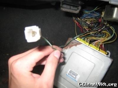

It is hard to say without seeing where you tapped the wire from. However when the o2 sensors go bad the usually go to the rich side (way rich). Did you use the factory narrowband o2 tap by the ECU? It is green with a white stripe and has a white insulated spade connector on it.

Use this wire. It is at the ECU.
^^^This

Did you try connecting it to the wire that GVR4_1057 showed you in his picture? That is the best way to do it since you won't have to splice into anything. Mitsu provides you with a perfect spot to connect that gauge, why not use it?

yea maybe ill try it.... its kinda hard to see it though.... i dont know if i make any sense but if any of you guys have a more pix of that wire it would be nice.... thnx

It's connected to the O2 sensor signal wire (pin 4 on the ECU, white wire). Just follow that back to the crimp connection and you should find it. It's green w/ white stripe.
It may help if you pull the ECU out. Also, it may be wrapped up with the wires. That pic was taken after I had finished rewiring my harness, and I decided to leave that section loose.

Take the plastic shrouding off around where the passenger's foot would be both by the ecu and by the air vents...just poke around with your hand to the left of the ecu location, about where the passengers right foot would be directly under, but behind the glove box (just push the glove box sides in and let it hang, much easier to get there). It was the only wire hanging by itself when I looked.
