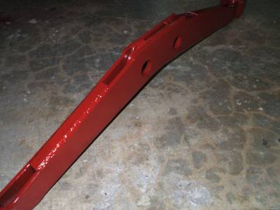

I have been warned about Summit rear end mustache bar, well they were right:
I now need to find new one. Does anyone have a lead on a Summit at a junk yard.
I also need to replace the bushings. I wonder if the 1g bushing will work here?

Leon,
Years ago Curtis made a rear moustache bar for a VR4 by welding two stock bars together and using one set of bushings. He also stitched the two bars together by welding bracing material in the edges so that both bars were tied together at numerous points. I appreciate it might be hard to find two bars but it might be worth doing having seen that picture. In fact maybe you could beat that twisted bar until it was almost straight and use it to brace the new bar?

Paul,
I am thinking about re-enforcing the factory bar, but I would rather not (nearly) double its weight, as Curtis did. I think that adding an "I-beam" section on the top and possibly on the bottom should do the trick.
Plus, the van has SUPER SOFT end bushings! That was one of the major contributing factors to the failure! I definitely need to upgrade them! Does anyone know who carried urethane bushings for the 1G bar? I am hopoing they are close enough to work on the van...

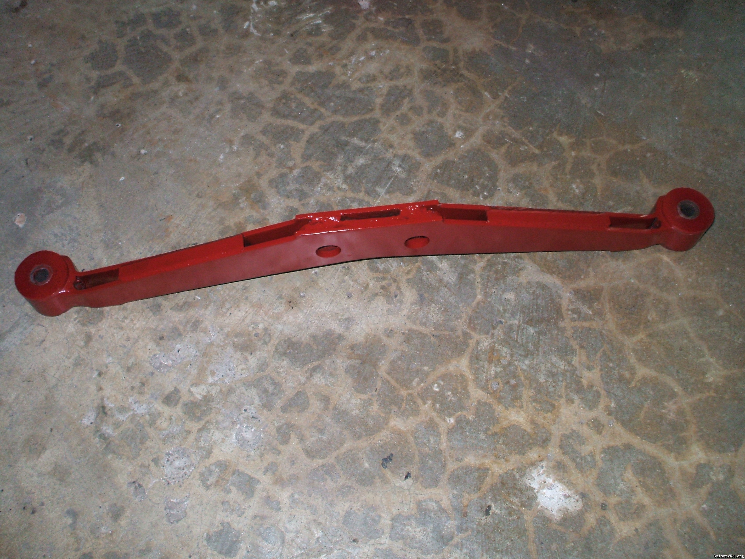

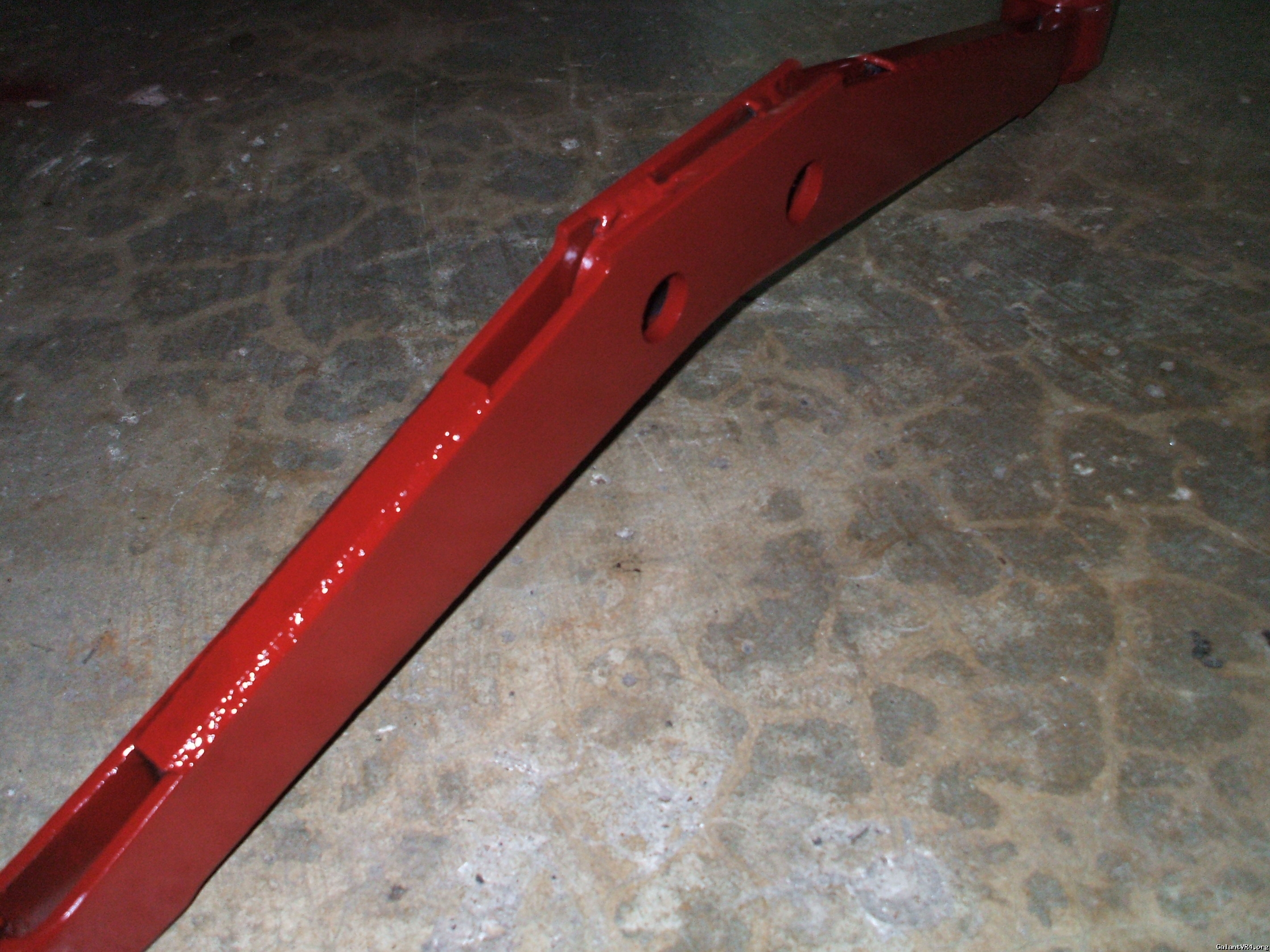

Drew, as I later found out, DSM bushings would not fit Summit bar <img src="/ubbthreads/images/graemlins/frown.gif" alt="" />. So instead, I window welded them. Not as good new bushings, but better than before.
As for the bar, my friend Doug E. and I welded on some re-enforcements:
Weight went from 9lbs to 12bls, much lighter than a “double bar” <img src="/ubbthreads/images/graemlins/wink.gif" alt="" />.
