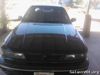

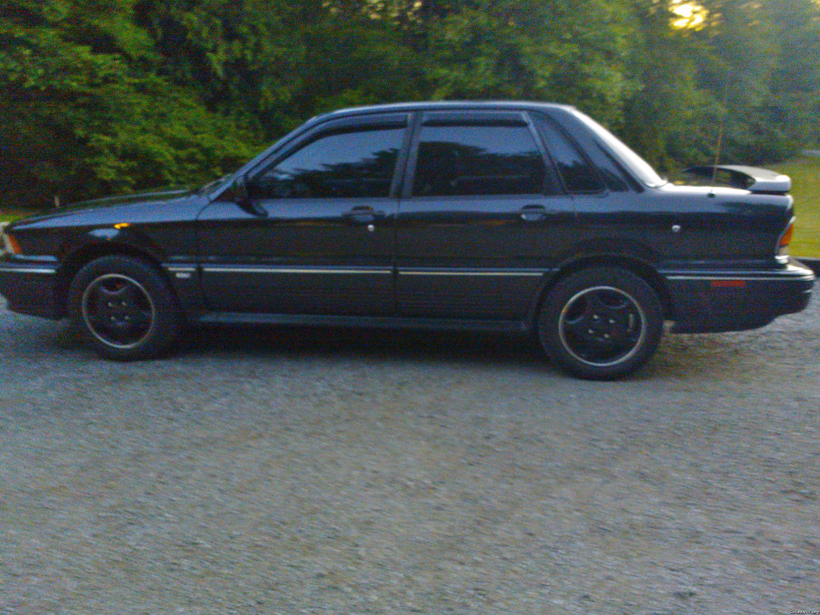

Here she is!

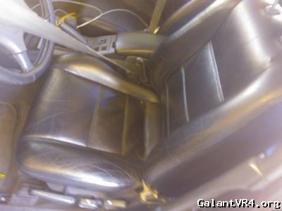

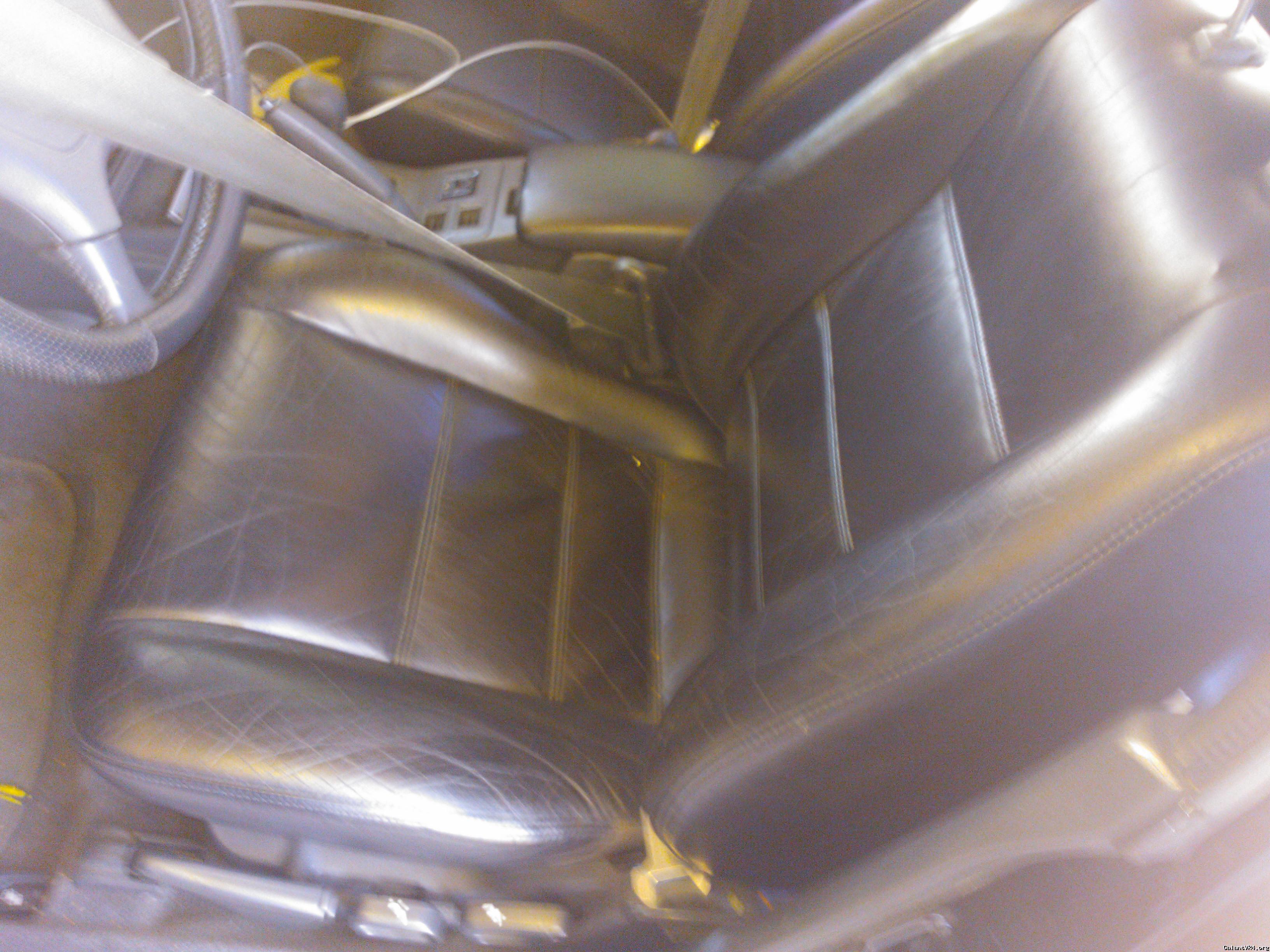

Leather seats all around are in awesome condition! I'm reworking the stereo and gauges right now. excuse that mess.

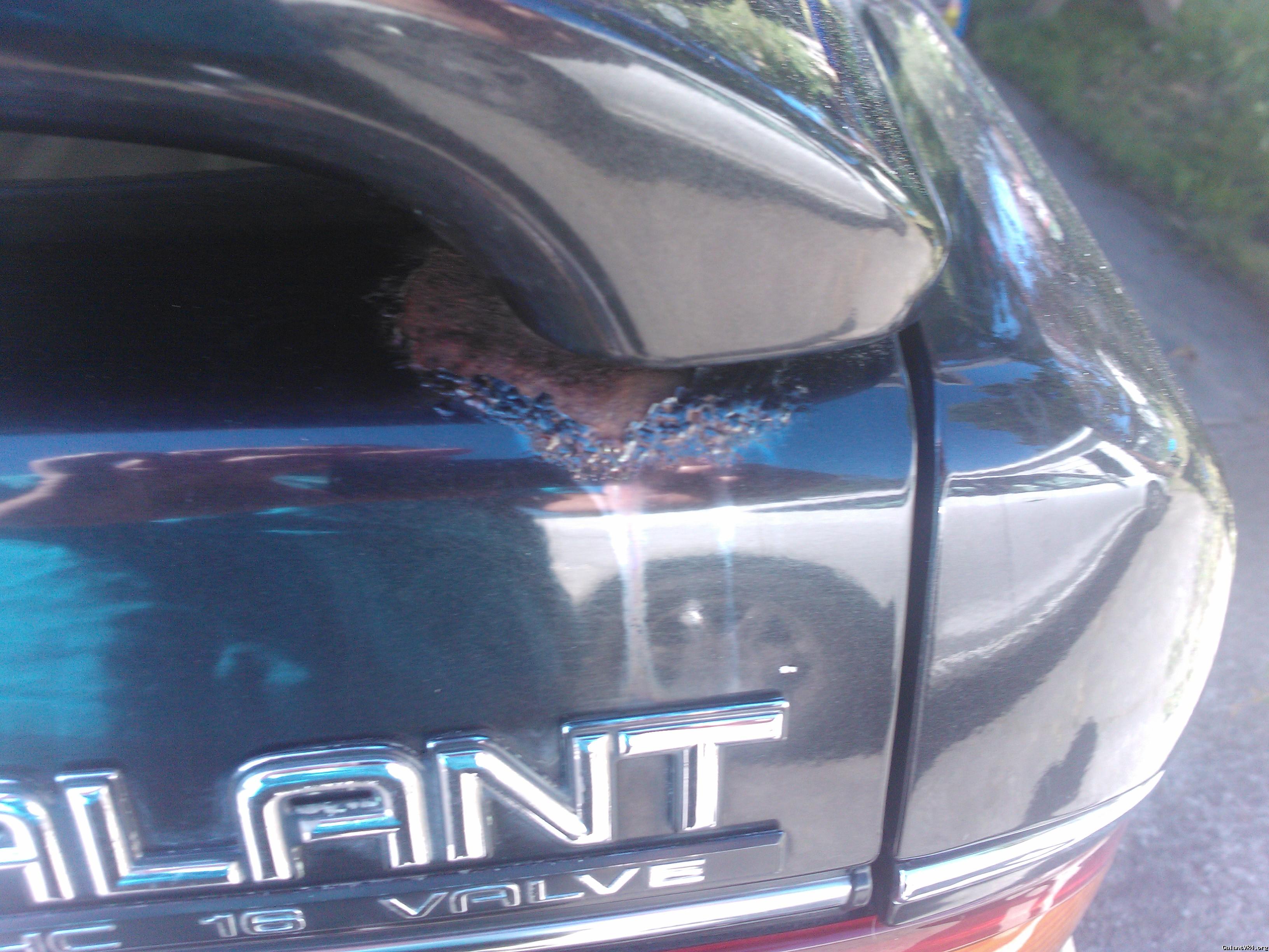

Little Rust on trunk, with luck my college's autobody program can fix that up.

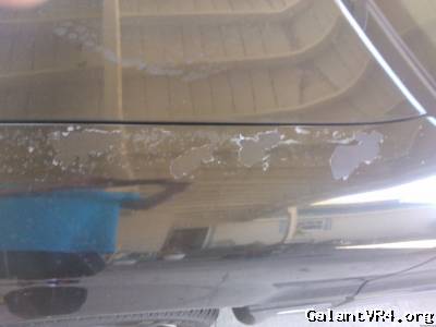

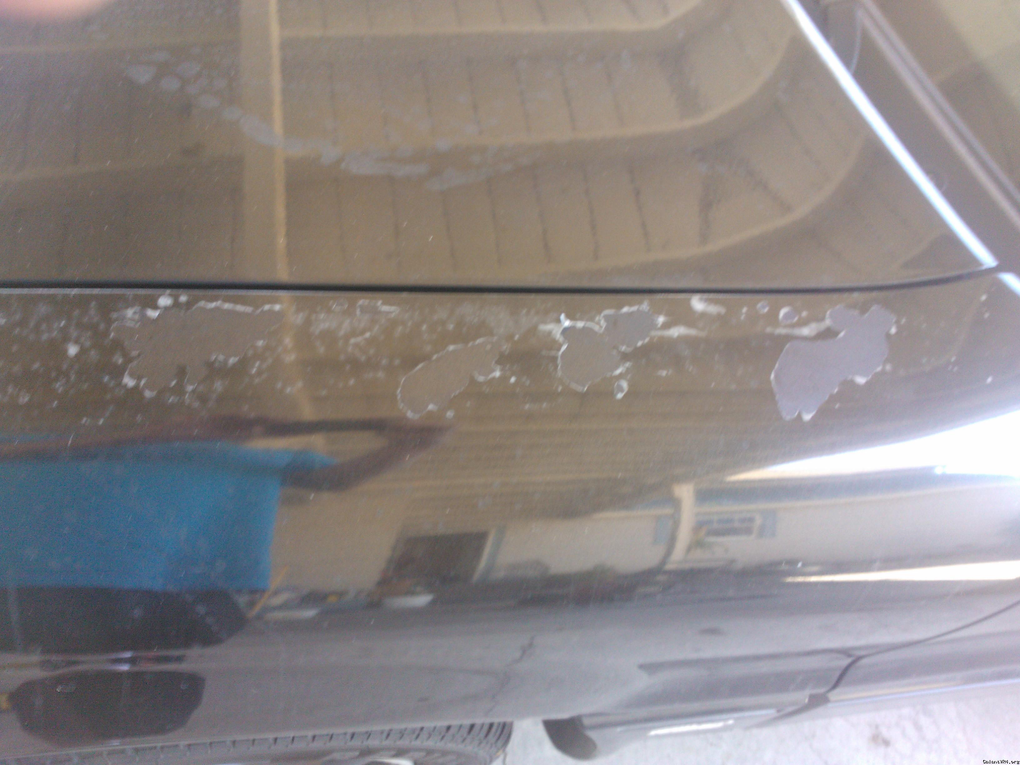

Believe it or not, this is the only clearcoat peel on the entire car! again, autobody might be able to fix that.

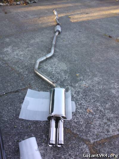

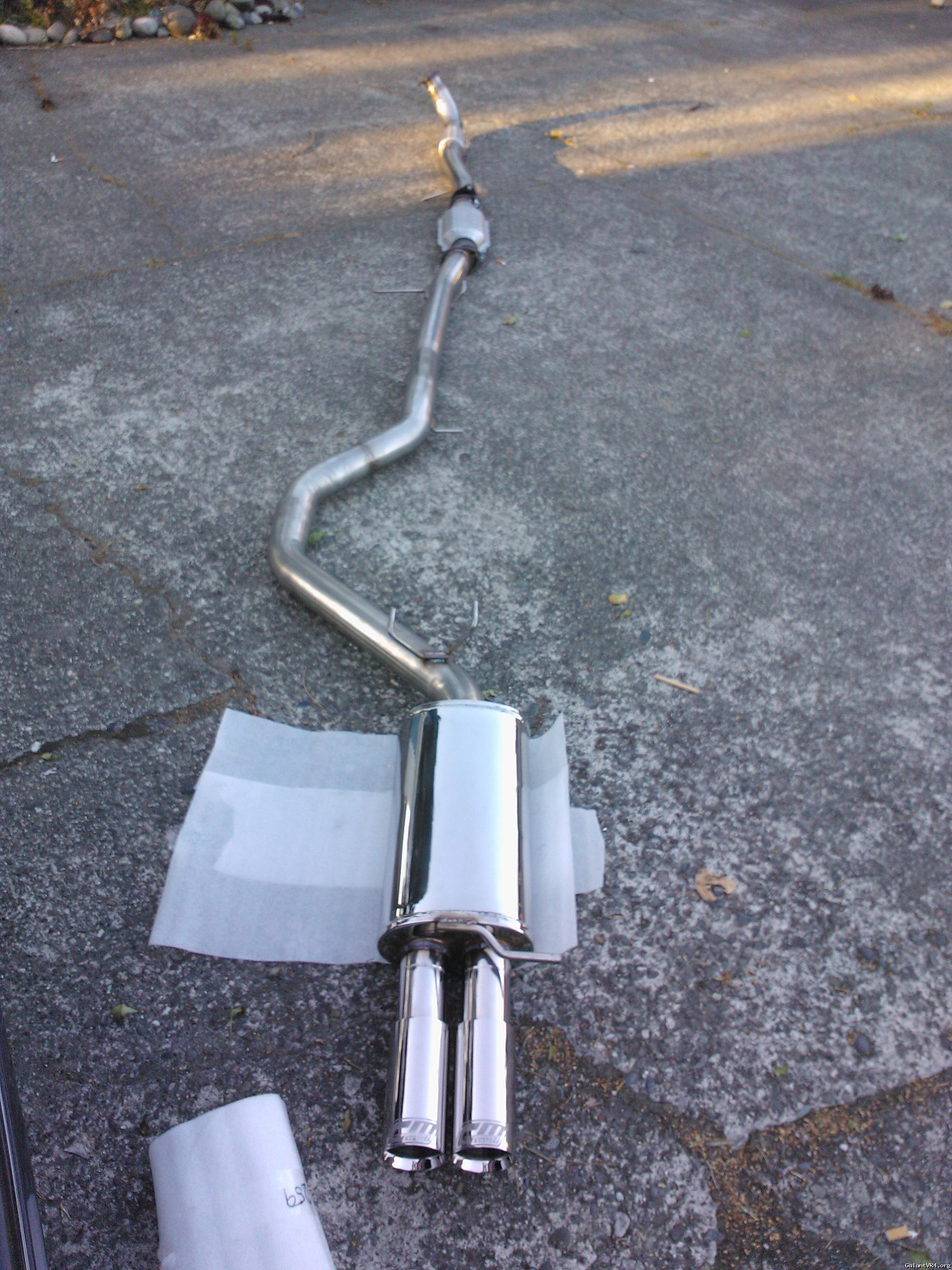

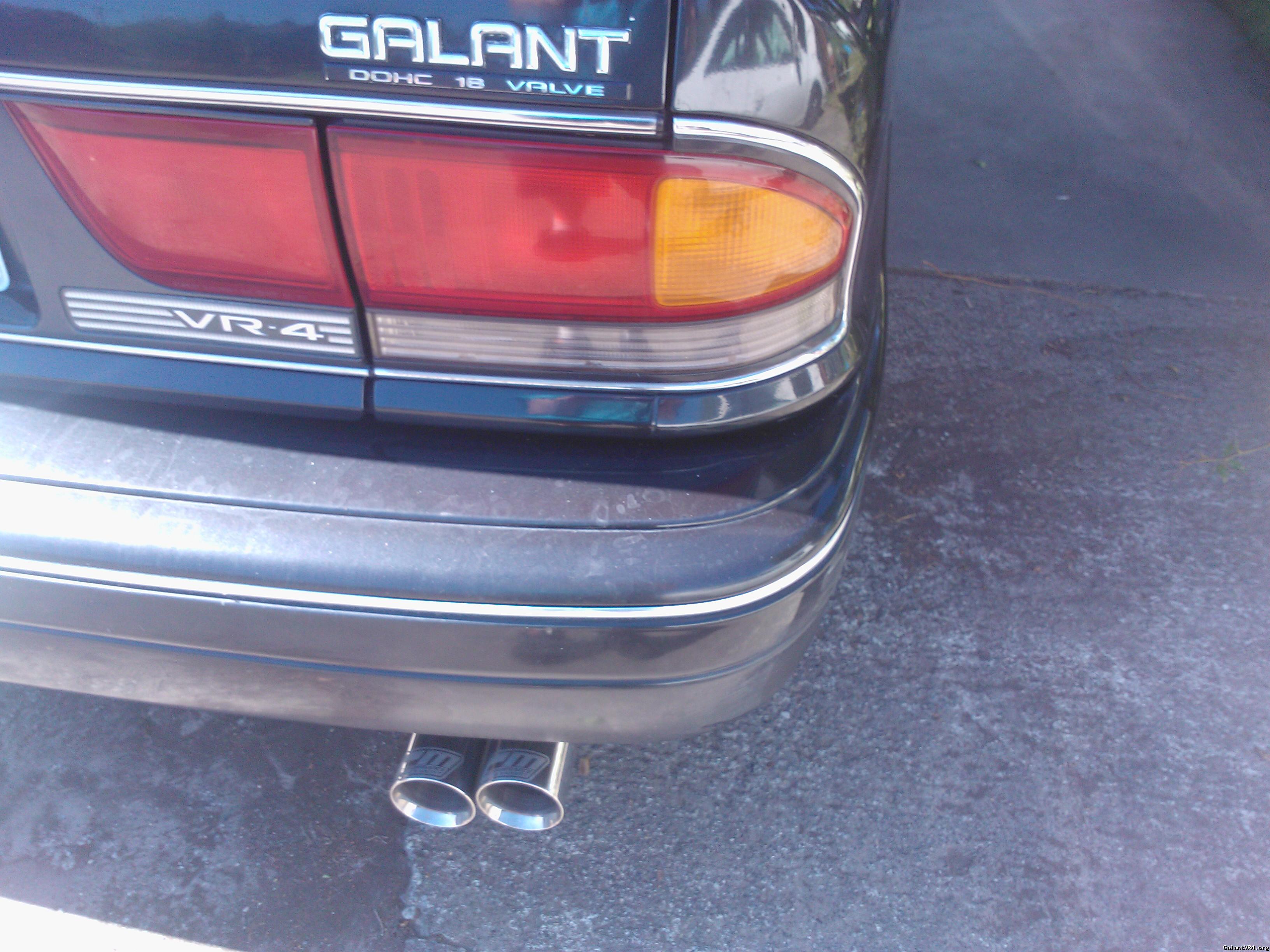

the CM turboback, nice and shiney!
here's it on the car, there's a slight angle, awaiting a better mount to fix that up.

Nice looking car. Great looking exhaust. I have the same one.

yeah, that exhaust was an adventure to put on by myself.
I kinda regret buying so fast. chose the downpipe that fits the stock O2 housing (2.5in i believe).
after ordering the exhaust, got a FP 3in O2 for next to nothing. /ubbthreads/images/graemlins/mad.gif

the cock-eyed angle is really bugging me. I have a few other items to patch up, then I'll work on that. maybe get a muffler shop to tighten the bolts up after 200mi of driving.

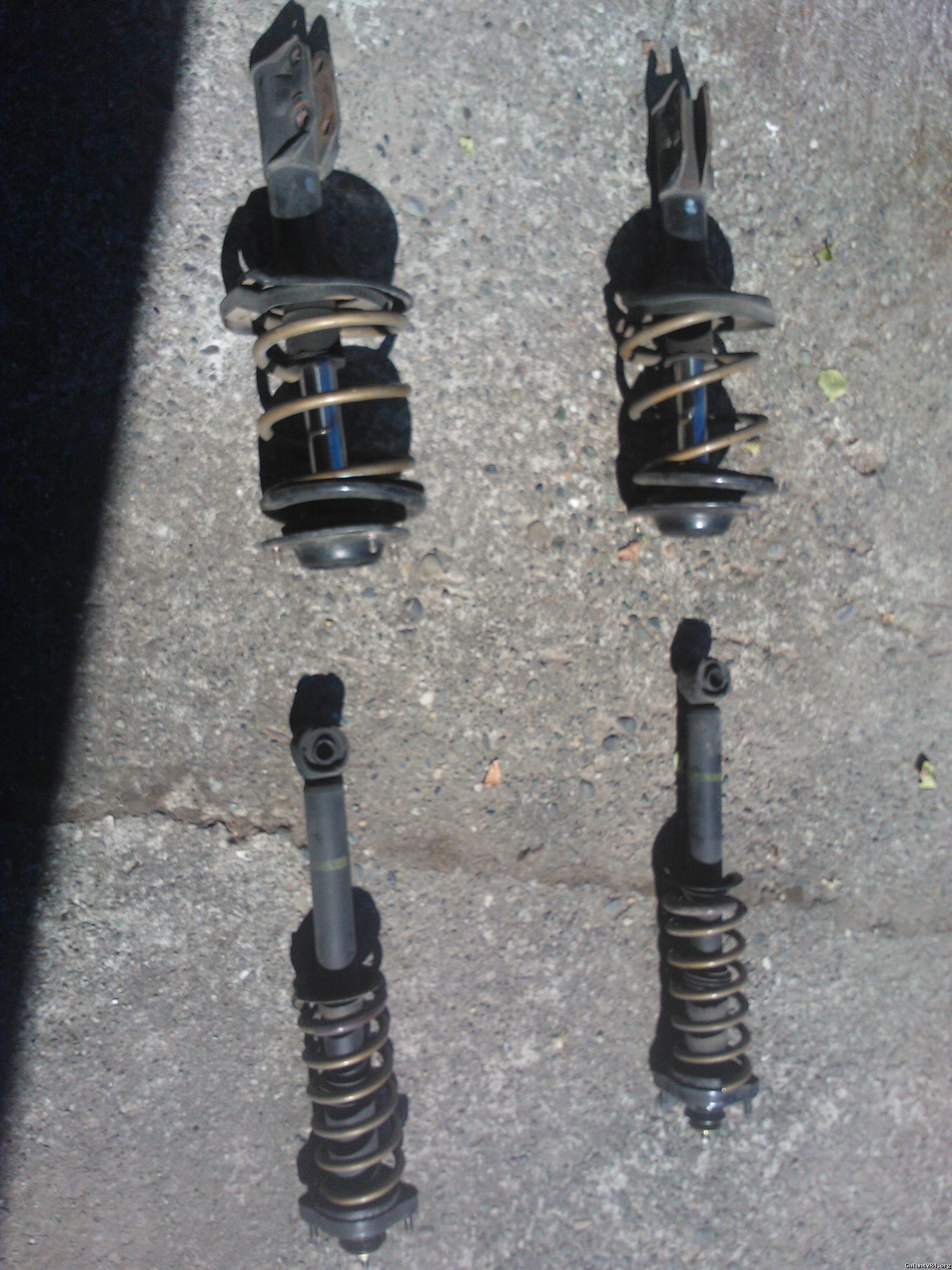

just got these in. evo8 suspension someone hacked up to fit 1g dsm.
Need to make some spacers for the front ears to get those on. (front ear donations accepted!)

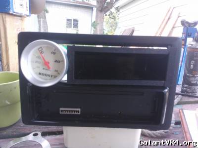

right now, working on console area. Lights for Enviro don't work, installing stereo, and a hacking up a pocket spacer. going to make guage/pocket area near stereo. not going as planned, so may trash that idea.

took to muffler shop, got the CM catback section set right and welded up.
Made some brackets for Evo8 suspension. Pondering what to do on setting the ABS lines.

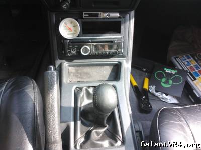

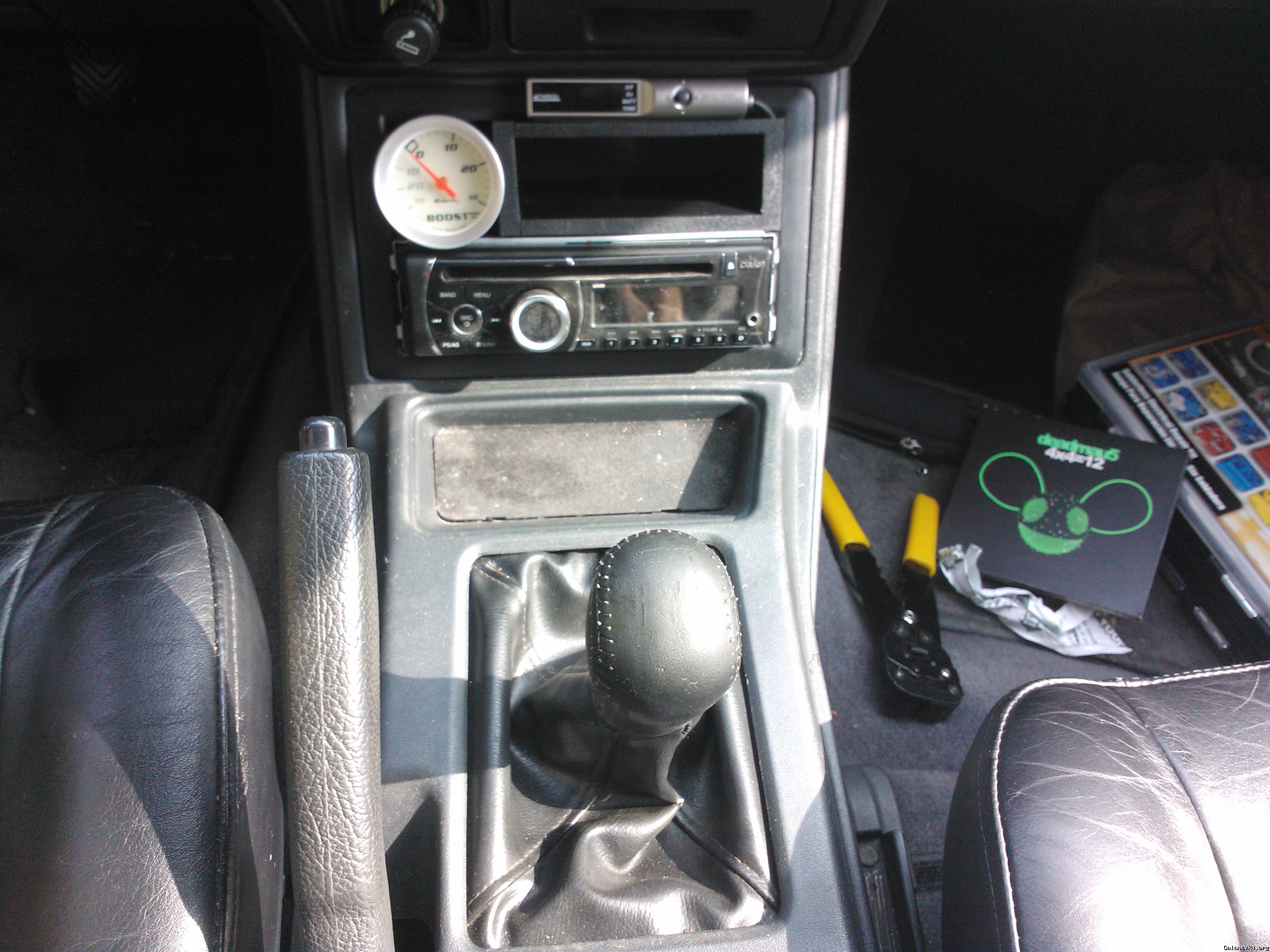

Fixed up the console area.

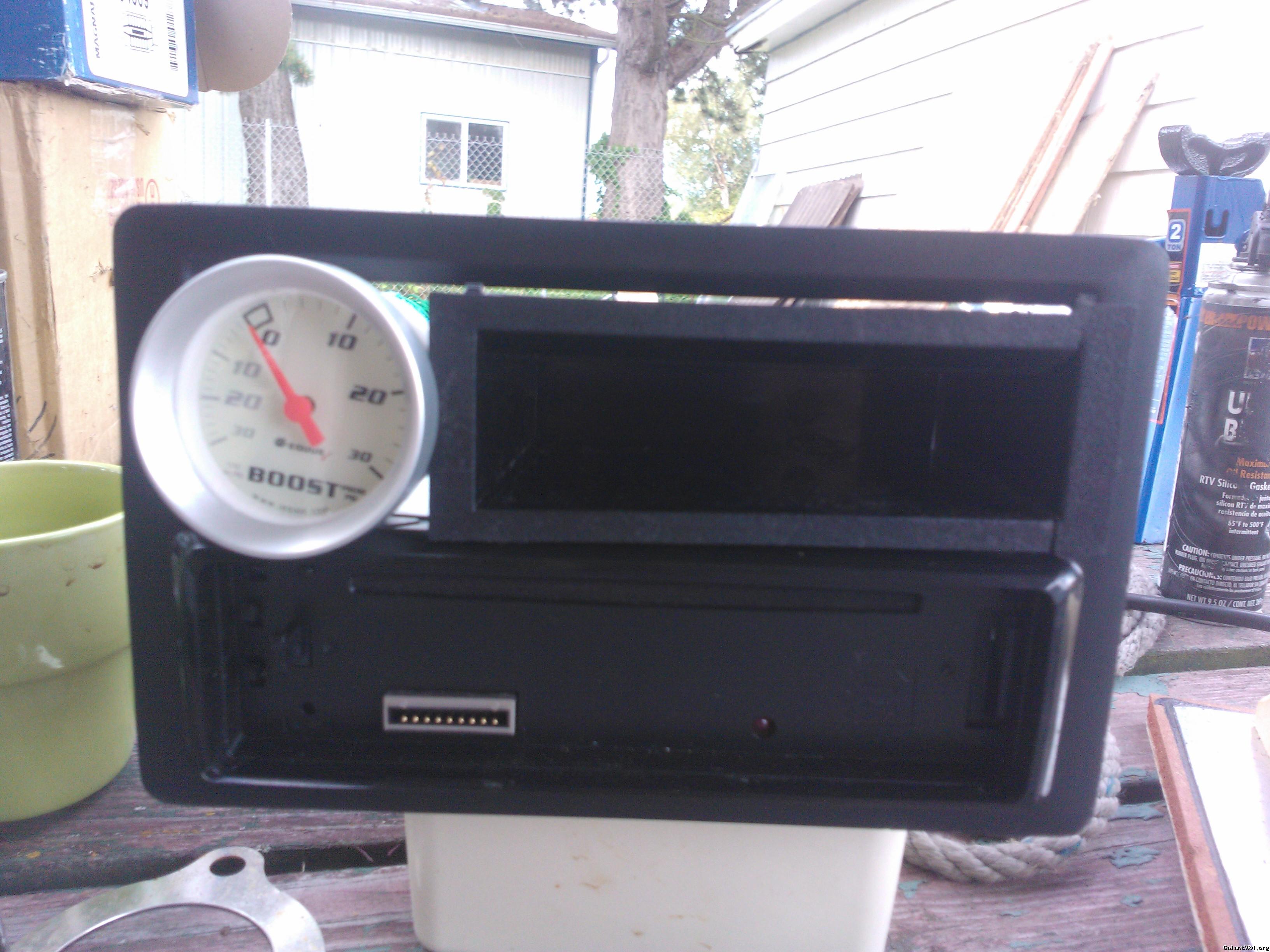

Added stereo, wires were a mess.... hacked up a space pocket to fit a no-name boost gauge. does the job for now.

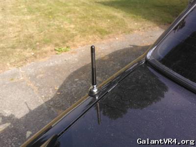

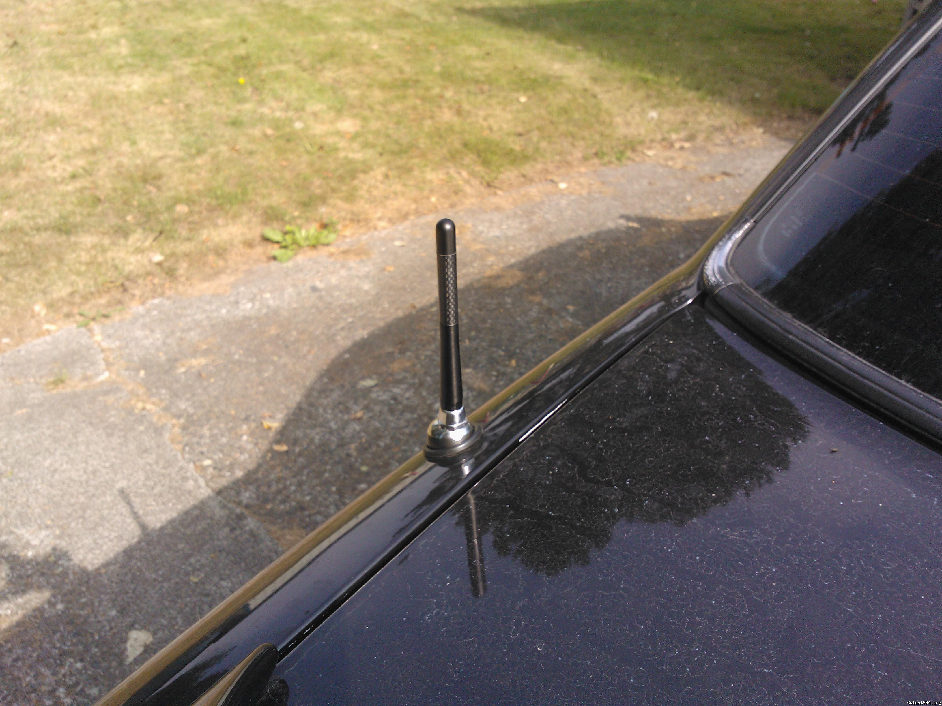

Stereo antenna was all sorts of crap. found a fake ralliart snub on ebay for $5. added in.

Took to a Muffler shop for a welding to the catback. looks more leveled out now.
Stereo area rewired, also fixed up a spacer pocket to include a no-name boost gauge.
Antenna was crap. found a fake ralliart snub. looks nicer.
made some ear spacers for the evo8 suspension, looking into brake line hold downs. we'll see.
