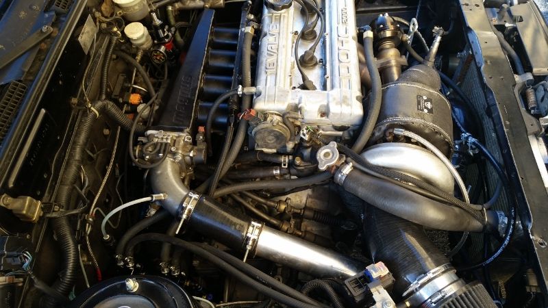

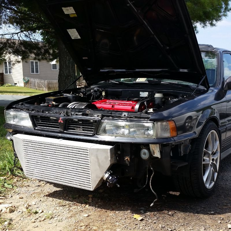

Thanks, not too shabby I suppose. My teeny weeny ETS street fmic is on the ragged edge currently with my conservative tune and 56lb a min. /ubbthreads/images/graemlins/blush.gif Just picked up a Kinetic short route core, this should be all the cooling the car needs and hopefully before the end of the season I will have a 6 second eighth mile slip. /ubbthreads/images/graemlins/cool.gif

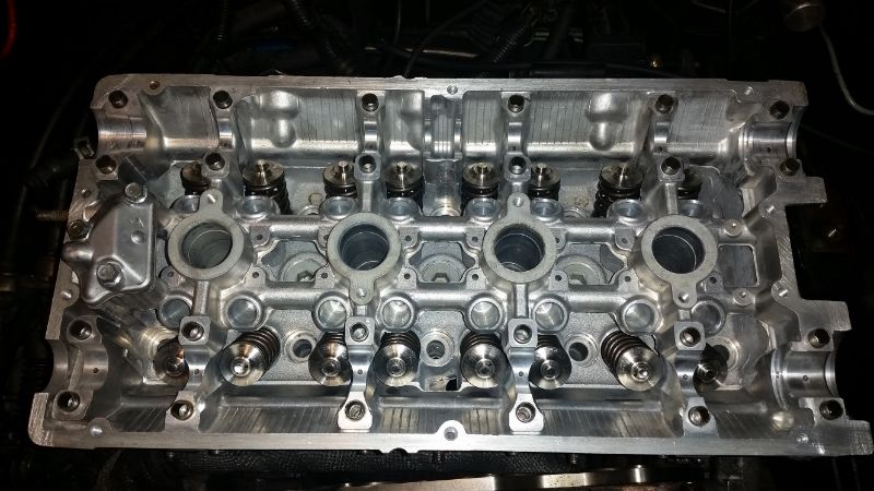

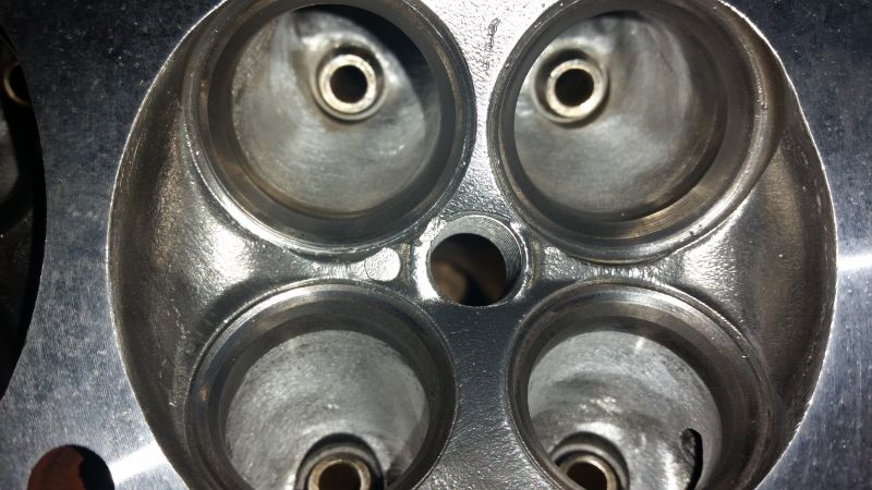

Well got the car tore down and fixed in two days which was filled with impressive non stop action to say least. I doesn't hurt that my x mas vacation started on the 17th and doesn't end till the 2nd either, so I was pretty much procrastinating the past week up till this Tuesday. /ubbthreads/images/graemlins/wink.gif When I pulled the head off I could see signs of fastener fatigue on a few of my standard ARP's (torqued twice) which led to me losing the hg prematurely I do believe. After tearing the head down I went ahead and had it milled once again, it only needed .003 off and was straight as an arrow. All sixteen valves were still in great shape with no signs of detonation so I went ahead and cleaned them up and hand lapped them back in. I decided to go ahead and run another Cometic MLS this time but with ARP L19's to keep the head down on the block where it belongs hopefully!

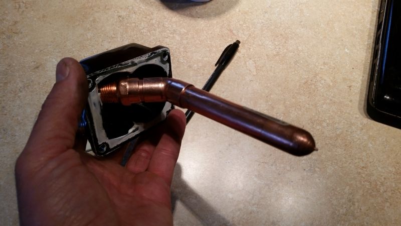

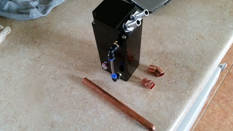

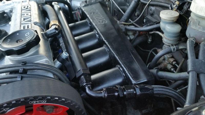

While the head was at the machine shop I decided to do something about my haggard gatorade catch can/bottle. So I went ahead and installed my modified ebay special catch cans that I converted into fully functional sealed cans. I tapped the inside of each can port (pipe thread is tapered) to accept a copper pipe fitting and slit tube on one side and not pictured a sintered brass filter on the outlet. This along with stainless steel scoring pad for extra media filtering. Sparing the details it turned out quite nice, extremely cheap and extremely functional. Just the way I like it.
In this pic I hadn't vacuum capped the tb ports yet and the pcv was still functional which is now looped to the other stock vc port.

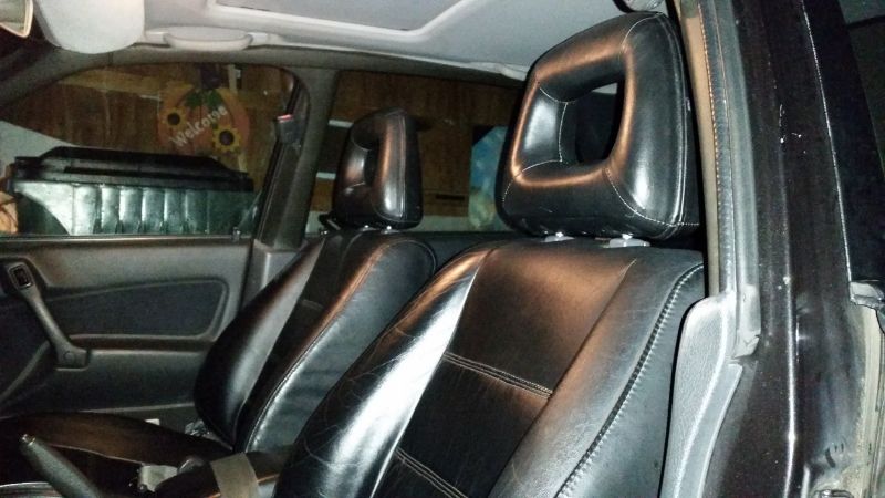

Lastly I picked up a set of Starquest headrests to replace the fugly bread loafs. They really alter the appearance of the seats and make them look some what sporty.

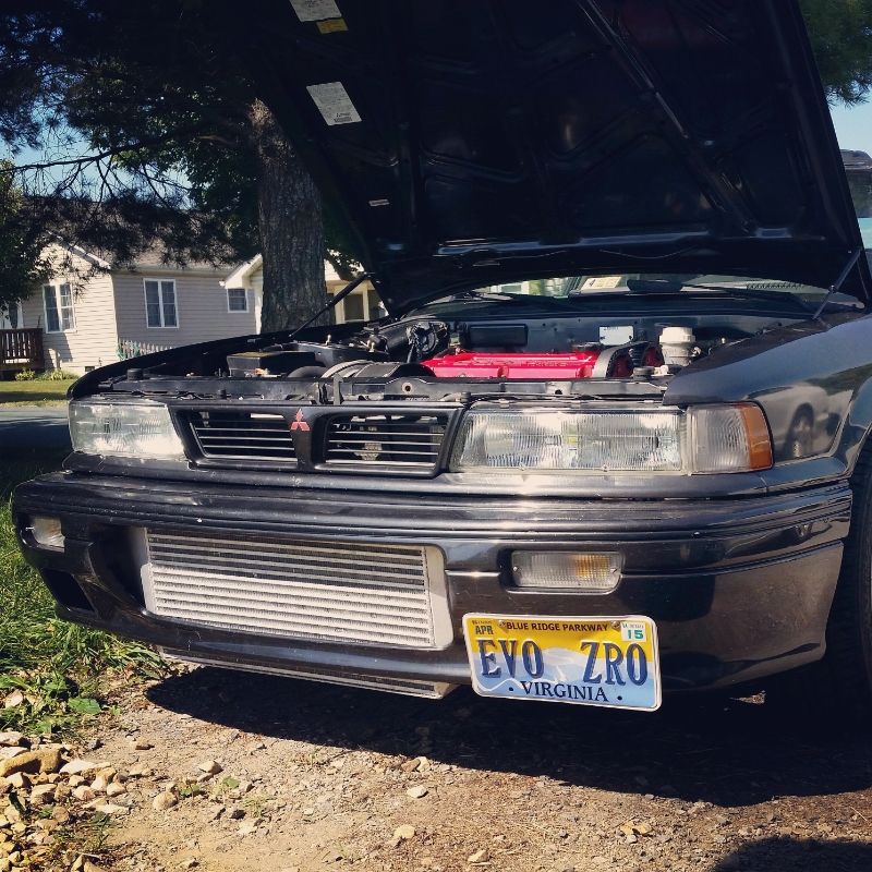

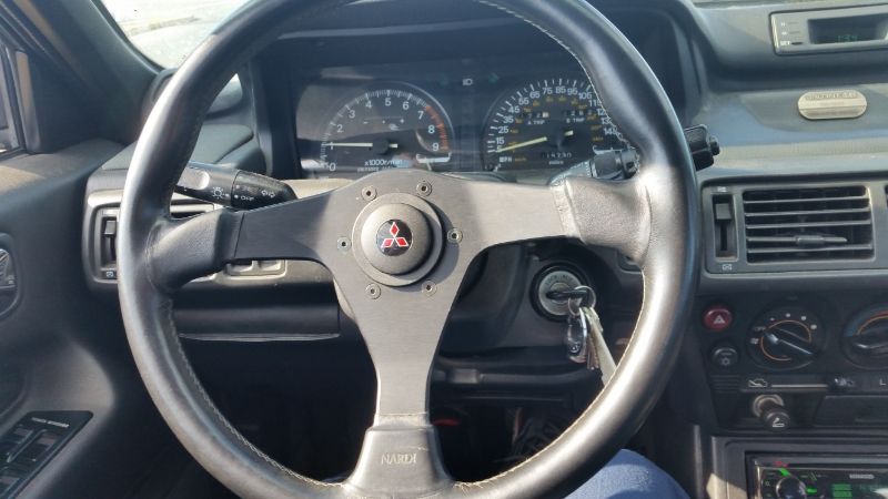

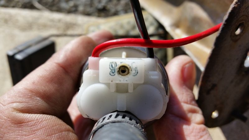

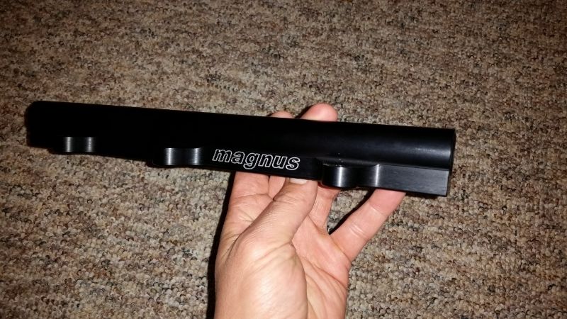

Couple updates, switched out the -6an feed for a full -8an feed and switched the return as well to -6an. Both lines start as bulk heads at the sending unit forward, I also added a Magnus fuel rail to free up some more flow. I noticed the tapped rail I had been using has the an fitting on the drivers side protruding over the #4 injector, not good. While I had the sending unit out I went ahead and drilled down to the relief valve and ran a screw in it, my idc's have been strangely high and I believe the 450 walbros low relief valve pressure may have been the culprit. I will be able to confirm this in the next few days when I get my fuel pressure sensor wired in. I also spiffed up the interior a bit with a Nardi wheel and personal hub and horn button. I threw in a sweet weighted shift knob too, it made the slightly notchy short throw smooth once again. I never mentioned that I switched the tiny ets street core out with a old school Kinetic Race core.
Needs a lip. /ubbthreads/images/graemlins/blush.gifops:

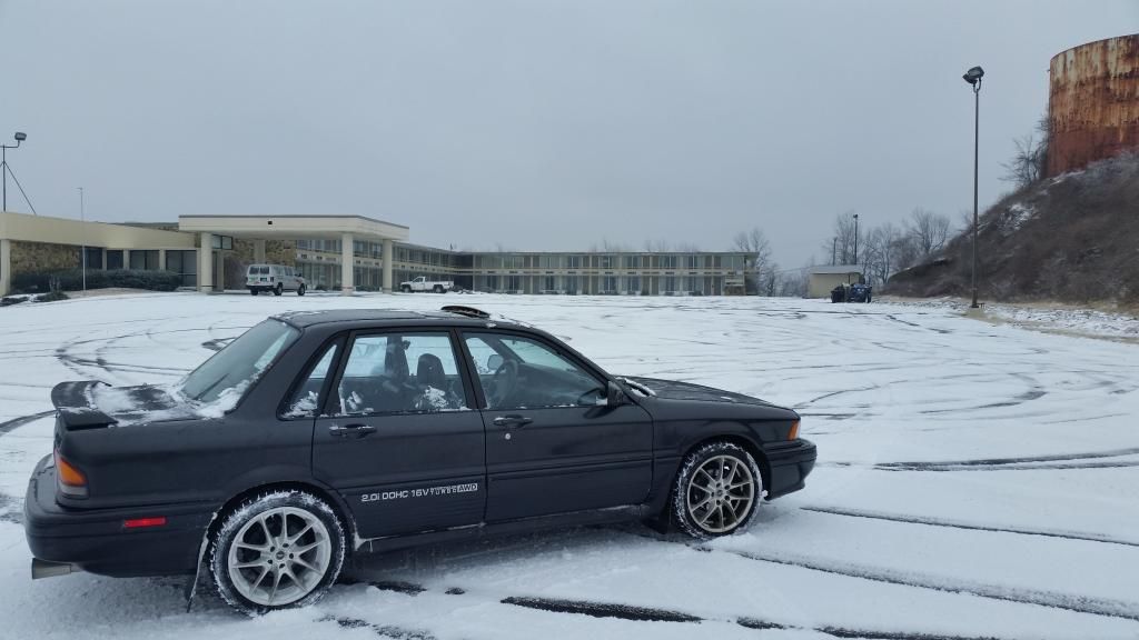

and some fun in the snow we had a week ago.

That Nardi wheel with the Mitsu horn button looks great.

Installed a new fuel pump strainer and rechecked all my fittings at the pump housing today. Strainer was noticeably dirty, I think what was on it came from the old stock return. I also got the fuel pressure sensor wired in and the fuel pressure was rock solid all the way to 35 pounds but the car still went a little lean. When I did a pull I noticed the car was rolling coal like a diesel up top but the wideband read 12.5 to 13.0, I am thinking the wideband sensor isn't working under load like it should. Gonna swap it out in the next few days and confirm my suspicion.

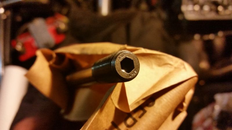

galant344
Sep 23, 2006
359
oakforest il.

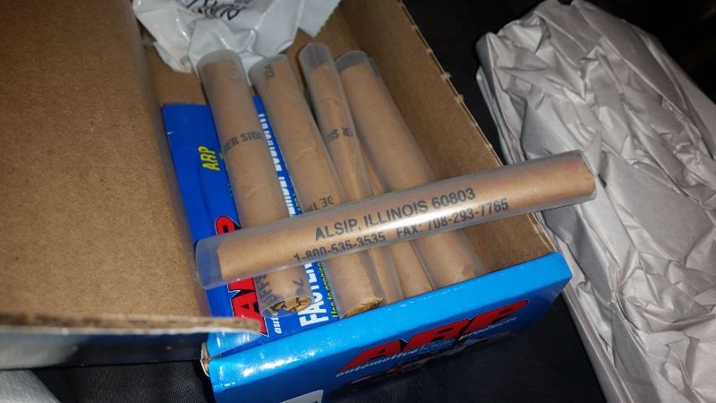

arp studs are from alsip il? thats like 10 min from my house? I wonder if that is just packing for the studs..... i've never seen that when i've opened a package of arp studs?
Fiascoxl
Jan 25, 2013
320
Stuarts Draft, Va
here's your answer... click
I googled the 1-800 number. /ubbthreads/images/graemlins/grin.gif
And info on where they are actually produced click

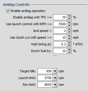

Wow that night launch is insane Joey, you need to tell me how to launch like that, was that anti-lag and two step together? And what rpm and boost level did you leave at?
Fiascoxl
Jan 25, 2013
320
Stuarts Draft, Va
Thanks, here are the settings I am using. I found a happy medium at the track with these settings, any higher and it spins too much and any lower it will bog down out the hole. These settings gave me just the right amount of traction I needed to run consistent 1.6 60ft's on cheapo tires. I will give a ton of credit to my South Bend Organic/Feramic disc and ACT 2600 pressure plate, the clutch slips just enough out the hole then quickly grabs hard.

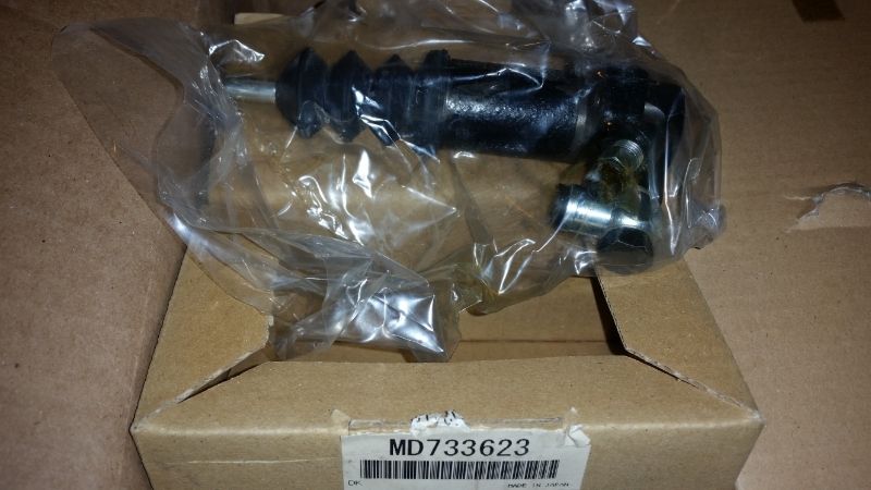

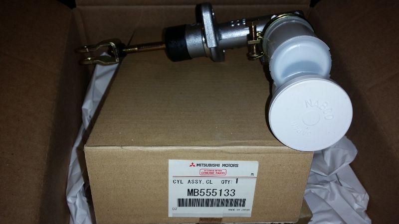

Recently developed a notchy engagement shifting into gear, I noticed my clutch master is seeping fluid very very slowly. So I went ahead and bought another OEM master and also picked up a OEM slave to go with it. I had changed the slave over the summer when it went out spontaneously and changed it on the side of the road with a parts store one I had nib for years and forgotten all about it. Hopefully this alleviates some of the shifting problem.

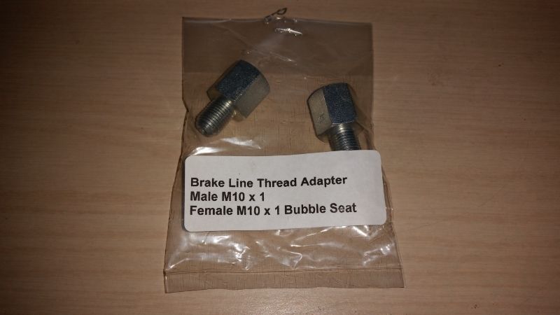

I also decided to do something about the piss poor brakes that are on it currently. I have decide to swap the brake master out for a bigger 1 1/16 3g unit, found some sweet adapters for the lines to go with it too. Since I was in need of rotors as well as pads I spent an little extra to buy Outlander caliper brackets to run the bigger Outalnder rotors up front. Not that they are necessary but I went with ABT slotted rotors, I have seen nothing but good reviews on them for being a low buck rotor so I decided to try them. The brake pads I chose for the front are Stoptech street performance pads and Power Stop Z26 pads for the rear. I still need to order some stainless brake lines and replace the brake fluid with Motul rbf600 before they go on.

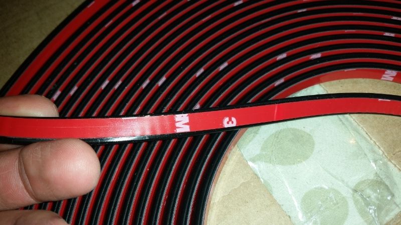

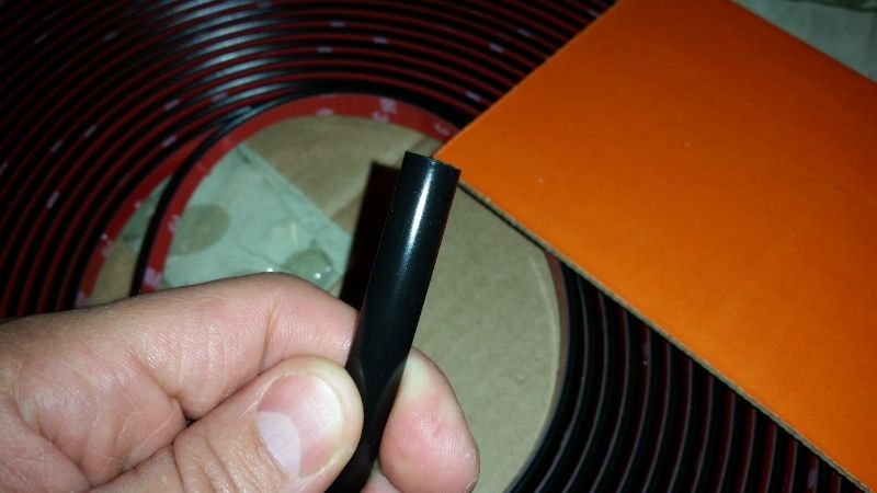

I seen a suggestion for replacement molding on another thread and found black molding in the equivalent size.
1g dsm master, need to swap out the reservoir.
got these on the cheap
these weren't as hard to find as people were saying.
Trim-Guard is the company
quality 3m adhesive
