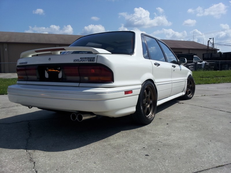

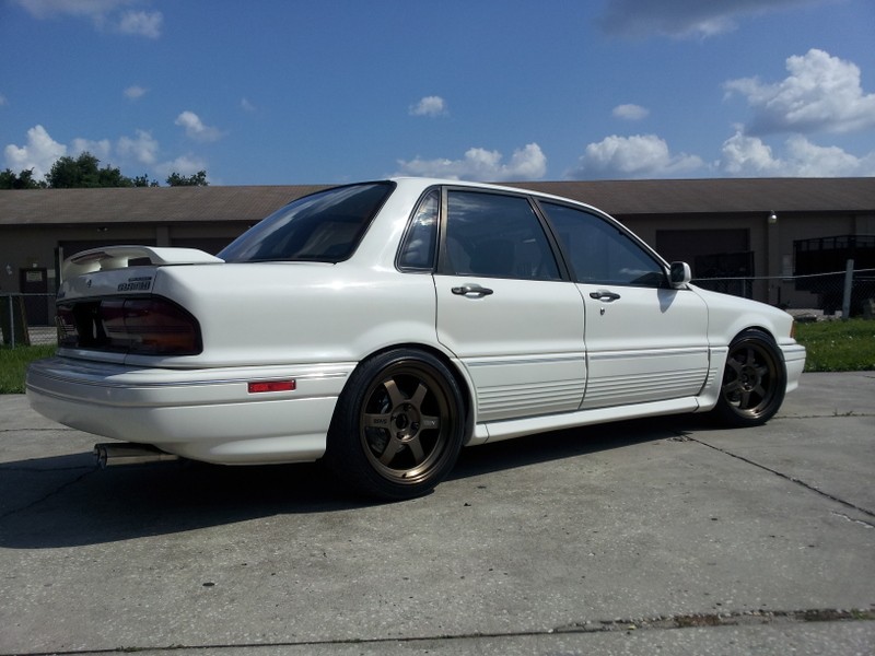

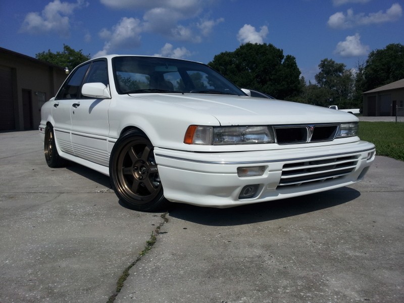

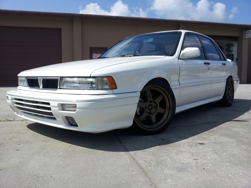

Cleaned the car today. Had a chance to take some pictures.

Thanks guys for kinds words. Been a great couple years doing the car. Plan on driving it some now. Getting some miles on her. Maybe take to some shows. I have a friend who wants to do a photo shoot of the car. I will post pictures when it is done.
