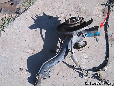

Of course,I try to show what I mean on photo that exist here,but if it needed I'll take a pic of my own trailing arms laying side by side.
I'm talking about lenght of that part of trailing arm which I marked by blue line.In stock trailing arm it's shorter by ~4 inch
Have you tried to fit it and run into issues?
By my measurements (bolt center of the lower rear shock attachment point to the center weld seam on the arm) it's about ~ 2" of difference, in this case, 2" of drop, maybe less, since my measures were kinda sloppy.

So.. since they are 2 inches longer, and evo 10 rear shocks are also 2 inches longer... Seeing where I'm heading?
But er.. don't the evo 10 rear shocks have a smaller mounting hole than even the GVR4 (which seems bizarre)... ?

Evo suspension has a different mounting set up, which is normally chopped off to fit a VR4. It could be an option to attach the lower mount from a GTO
That's what I should have done - and would have if I'd known the difference in size before having my Bilstein rears welded up.
It would've been MUCH easier to have 3000GT/GTO rear mounting points welded in place rather than all the grinding I ended up having to do. I'm still not done with this setup yet... getting close though.
