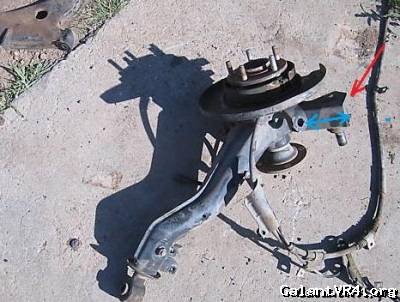

Hello,can you help me with advice? What shock absorbers did you install in your car when you installed 3kgt trailing arms?
Cause I have DSM 1g AWD and I want to put 3kgt rear trailing arms on it,when I compared my old trailing arms and new 3kgt trailing arms I noticed that construction has a bit difference in stud that holds shock absorber. In 3kgt trailing arm stud taller than DSM/Galant trailing arm by ~4 inch. I don't tried yet to install new subframe with this trailing arms on my car so I don't know how it will look assembled but I fear that if I assemble it with my stock shock absorbers it will be very high ride height on the rear axle. /ubbthreads/images/graemlins/confused.gif
Of course,I try to show what I mean on photo that exist here,but if it needed I'll take a pic of my own trailing arms laying side by side.
I'm talking about lenght of that part of trailing arm which I marked by blue line.In stock trailing arm it's shorter by ~4 inch
cheekychimp
Apr 19, 2004
7,333
East Sussex, U.K.
So yours looks like this but that section is 4 inches longer than the stock Galant VR4 arm OR on the trailing arm that you have, that section is 4 inches longer than the one in the photo you posted?
Yes,that section on 3kgt trailing arm is longer then stock one on GVR4/DSM 1g (I've searched in CAPS,our trailing arms have same part number,so I think they're identical)

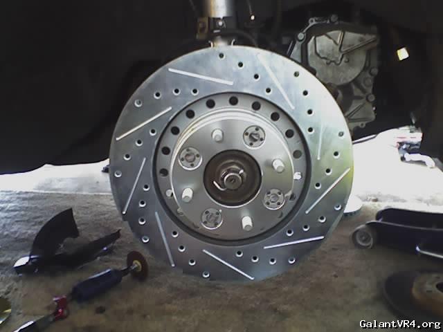

I got one side done. Need to replace wheel bearing on other side. Looks good with the 12.5" rotors. I had to space out 5/8" to clear the rims.
What rotors are those? Do they have just slotted rotors? I have all I need to install 3000GT brakes including the 5 lug rotors but I still have and want to keep 4 lugs.

Oh,thank you! Really I compared trailing arms up side down((( So,that problem is much easier but it still exists.Maybe there is possibility by making some spacers to get rear height equal to stock size? At now I have stock shock absorbers and three type of springs: stock Galant,stock Eclipse and Eibach lower springs. I'm thinking to install Eibach on front and Galant on rear^but I don't know how that solution will show itself cause I think front on short springs will be much softer than rear on high springs... /ubbthreads/images/graemlins/uhh.gif
