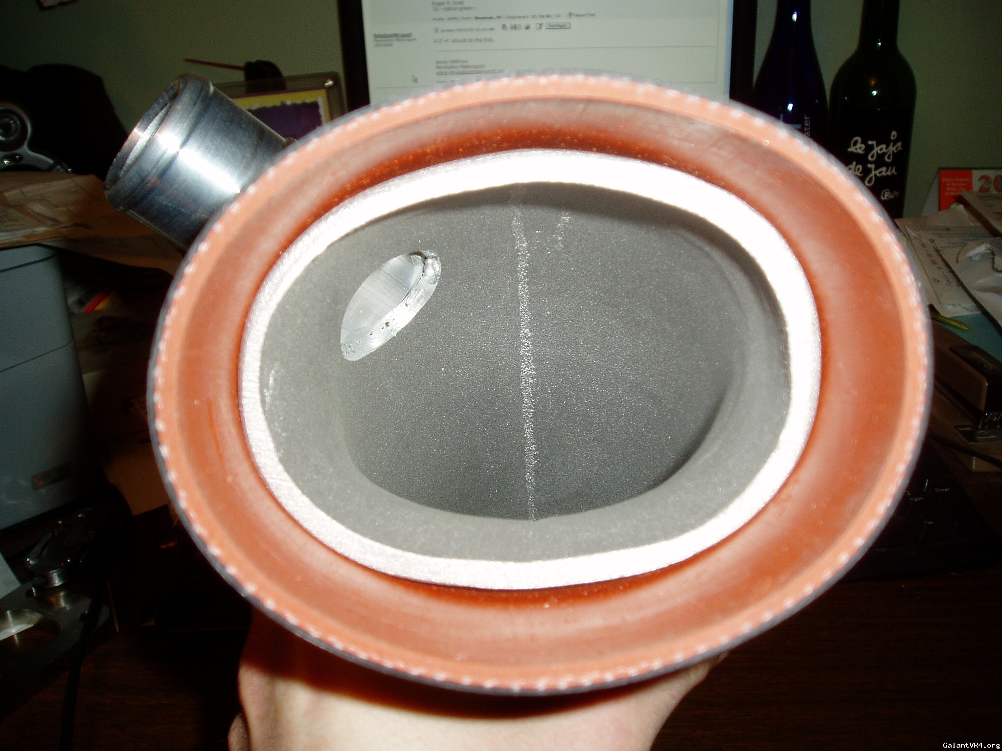

I've searched around a bit and couldnt seem to find what I was looking for.
Which coupler will I need to get the 2g MAS to fit the ETS intake (ie: 3" to 3.5", 3" to 4", ect)? I just need to know the diameter of the coupler on the 2g MAS side, mainly.

2g mas has an oval opening where as the ETS kit is for circular (1G or Evo/3G style) if I'm not mistaken. There may be a 2g variation on the ETS intake but I'm not aware of it. You'll probably want to get a different mas (Evo/3G) to avoid a headache.
A 3"-4" should do the trick.
This is a 4" coupler on the FP 4" intake that has an oval end like the 2G mas.

Thats what Im trying to work with, the oval to circular piping. Ive heard of people stretching a circular coupler over the 2g MAS, I just need to find out the diameter of the circular coupler that will fit over the 2g MAS.
Looks like Jesse has the info. Thanks, man! Where can this coupler be purchased from? Maybe ETS will have one when I go to pick up my FMIC this week.
Any other input is appreciated.

You can get just about any size coupler you want on ebay for a pretty decent price. I use a store called Silicone Intakes but there are many others. Just notice that the image Jesse posted was of an oval pipe for the oval 2G mas. You'll be using a straight pipe and a 2G mas so the coupler is going to have to deform a bit to make it work.
