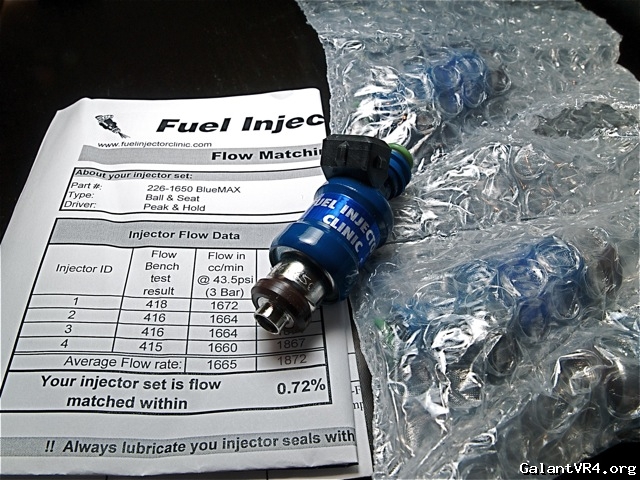

The reason I purchased 1650cc was so that I would have enough injector when I go fp3052 or 65. At the moment the car has a fully built motor and it's being fed by a fp18g. I agree, I should have gotten 1150 or 1250, but that 'buy big' syndrome got me. I just got back from tuning and it was a b*tch, even for the old Haltech to control them 1650's. I'll be spending the weekend trying to tame it, so we'll see. If anything, I might just have to put these up for sale and pick up some 1150 or 1250.
The car is running on e85 and with my 720's it maxed out around 17-19psi by 8500. 25psi, is what I'm aiming for initially with the bigger injectors, but hoping for 30psi or as much as the turbo will do.
I did push that turbo to 25psi on 100 octane race gas and it scared the sh*t out of me. So I can't wait to tune it for 25psi on e85 and hit the tracks again.
Crap, if 1150 or 1250 can do 30psi on e85 with this turbo, I might just have to get those. /ubbthreads/images/graemlins/banghead.gif

I agree, the 1650cc's are overkill for my current setup, but it's what I decided on and I'll just have to work with it. From the math, 1150's would've been perfect for my current setup.
I was able to tame the thing a bit. I dropped the fuel pressure from 43psi to 37psi, it's a bit more controllable now. Maybe I'll try lower.
