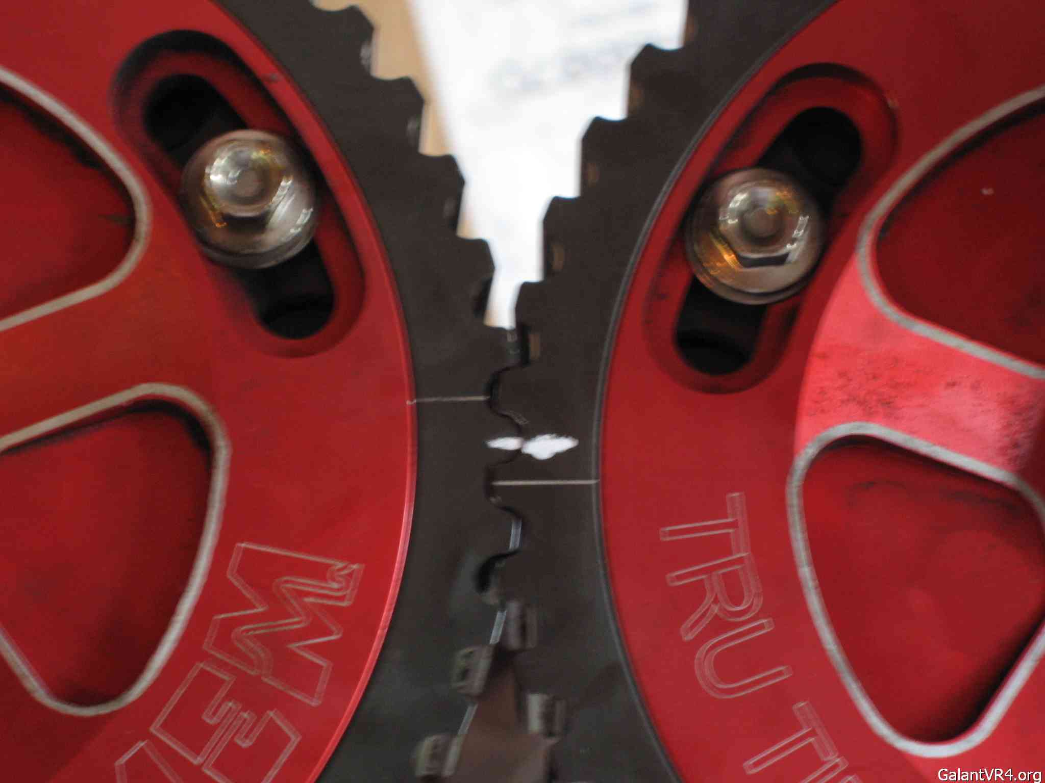

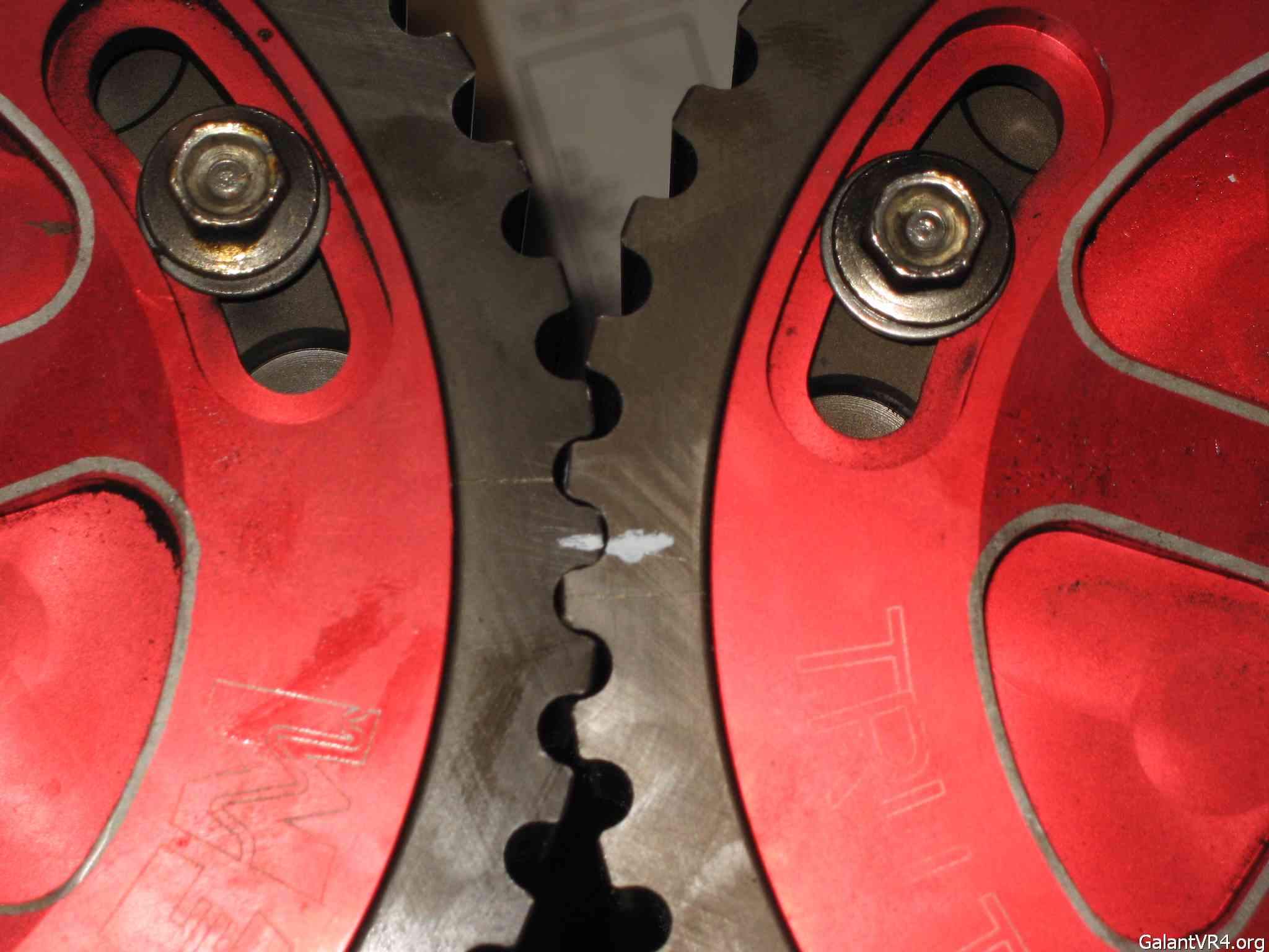

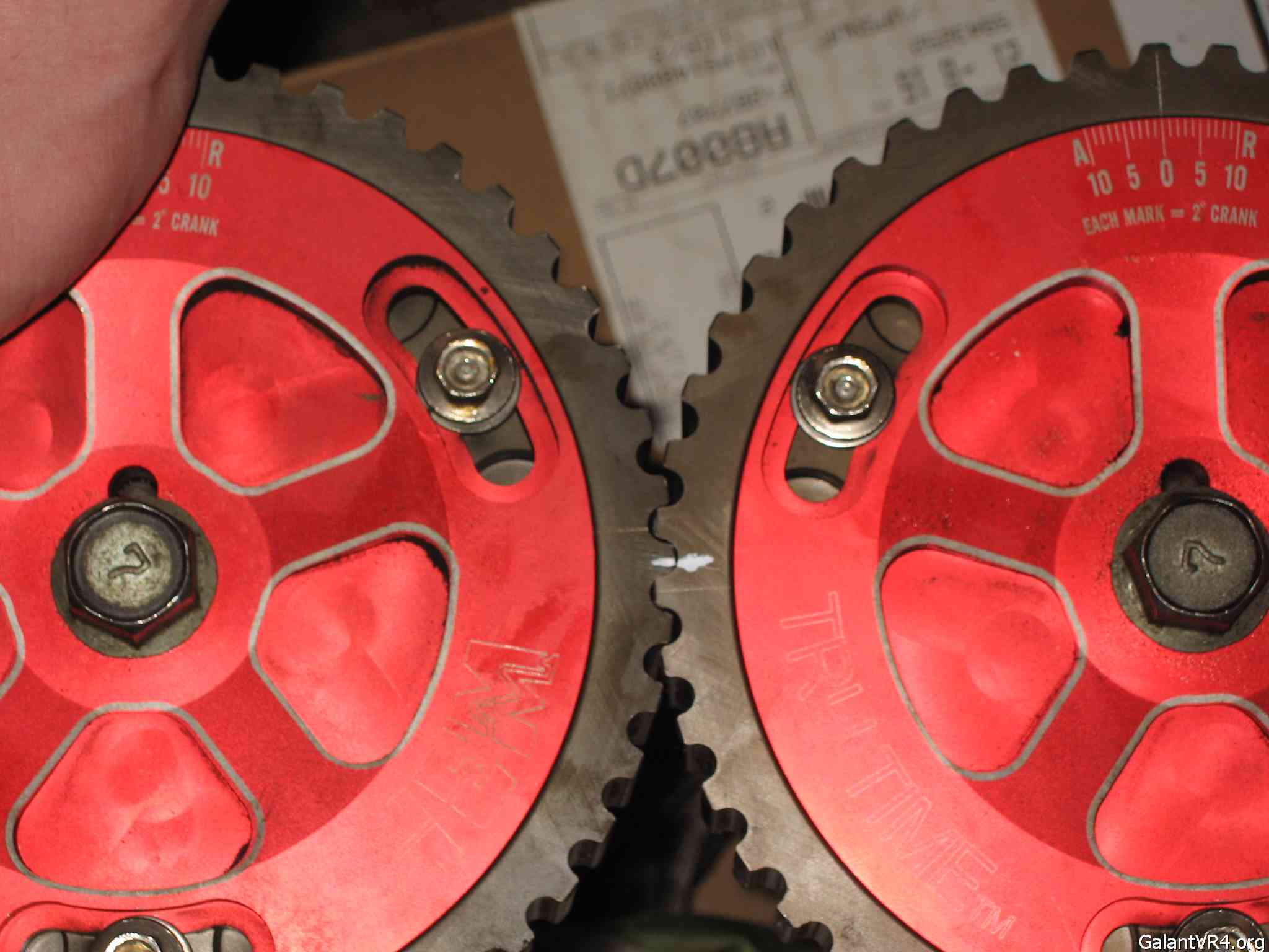

2.4 g4cs/4g64 with 4g63 cam gears Marking
so you turn one clock wise one tooth and the other counter clock wise a tooth...
Did you actually go and degree the cams, or is that just what ran best at 0* offset on the cam gears? Also did you have the head milled or the block decked?
bazeng
Feb 6, 2003
2,520
Melbourne, Australia
Just confirming that I too have recieved the exact same marks with a G4CS block, .051" cometic gasket with the block and head milled only slightly...
HKS cam gears..
