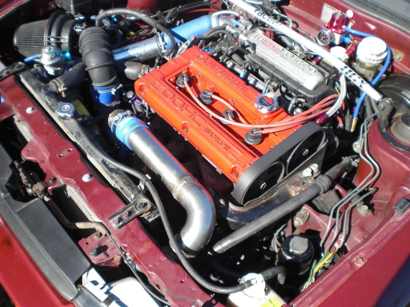

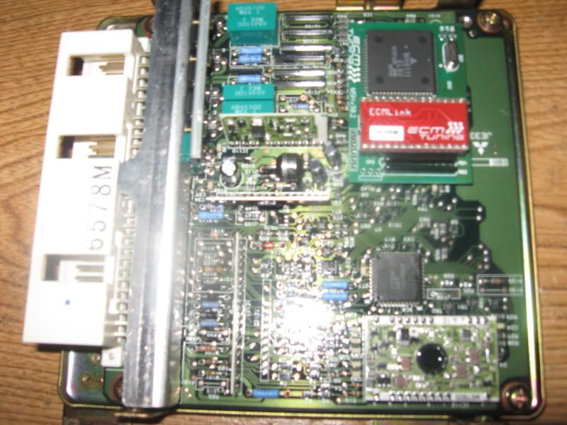

You will throw a CEL for the fuel pump but that is a known issue due to the wiring differences of the USDM and JDM cars. You can cancel that code in DSMLink V3 and then just forget about it. If you are running a Cyclone manifold you will either need to swap it out or find an alternative way to operate it since there is no Cyclone controller board in the 1G DSMs. You can operate it off boost using a boost actuator from a turbo or from one of the spare outputs from the DSMLink using a solenoid.
Other than that it works fine. I have a 1G DSM ECU in my other Galant running DSMLink V2.5
Paul.
