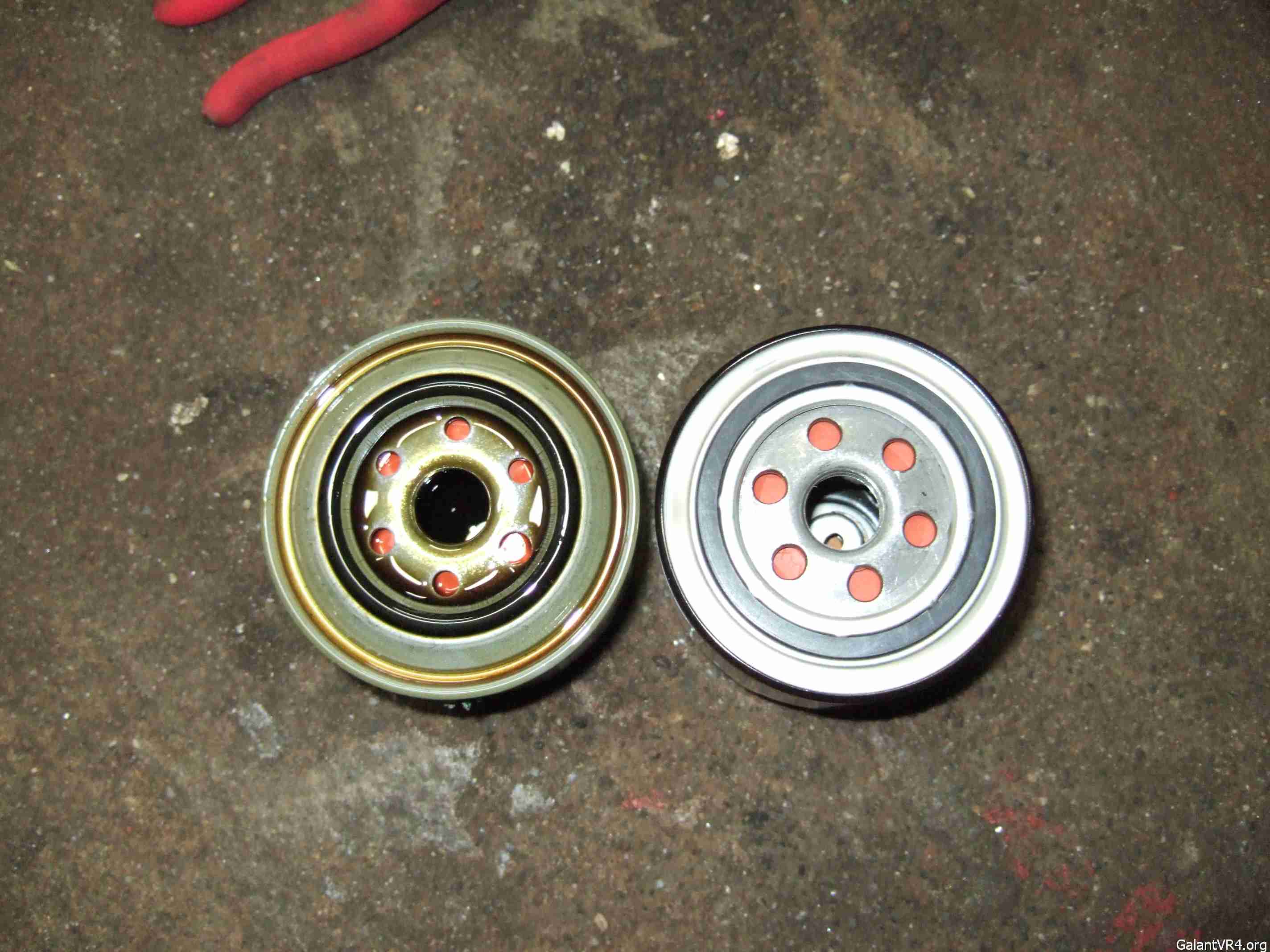

Did anyone one find that some filters don't work with this housing? I think the Mobil 1 filters' gasket is too small for the external cooler housing. Mine has been leaking slightly since I installed it a few weeks ago. I just picked up a NAPA Gold filter, and the gasket has a much larger diameter than the Mobil filters. Hopefully this will put a final end to my leaks.

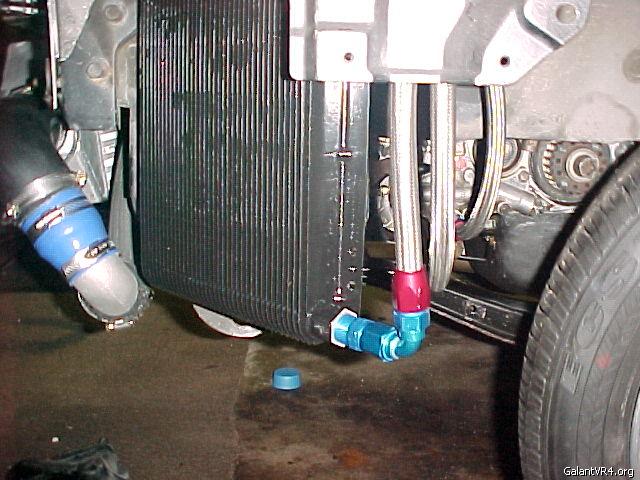

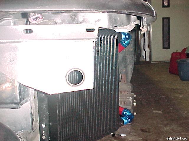

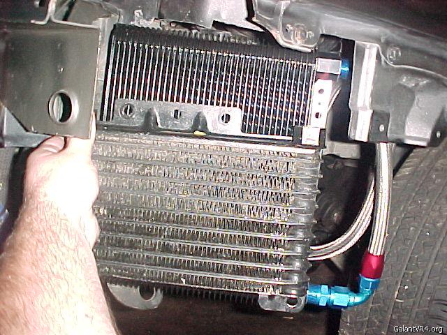

Could someone post some installation pics?
Well I took a few pics but all sucked except for this one. I only ended up getting it roughly mounted tonight, it has to come off so I can POR15 all the edges of the metal I cut away. Not sure if any of the AC components would be in the way to mount it here but you would need to have ABS eliminated for sure. I will be doing the lines tomorrow hopefully. They are going to be very short and will tuck behind the inner wheel well just barely. I will take some pics of them. Some may ask why I didn't mount it up front, well in short I didn't want to. There was an empty void where it's now mounted, the lines will be short, I can easily duct a nice air feed from the vacant fog light hole, and it's just where I wanted it. /ubbthreads/images/graemlins/smile.gif
Polish
Jan 10, 2005
8,936
NE, IN

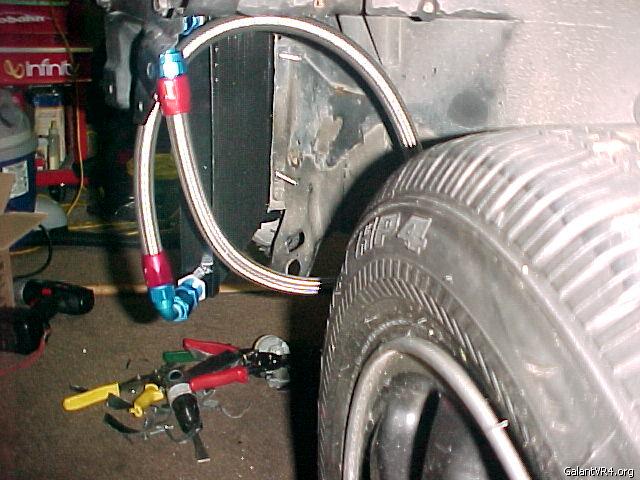

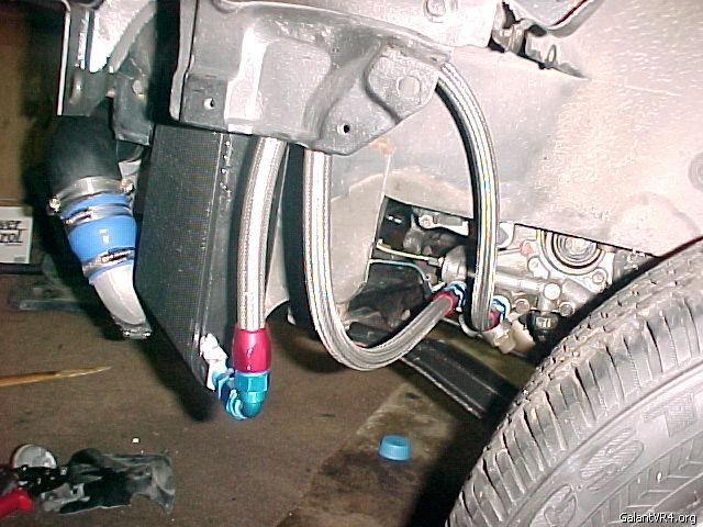

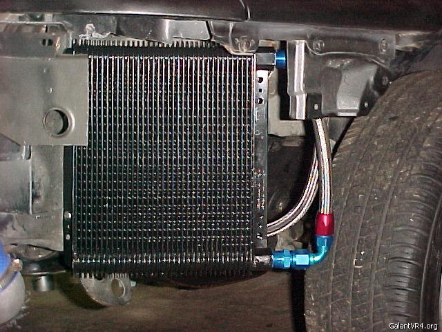

Here some more pics. Lines done. Also a Pic comparing a stock 90 oil cooler to the B&M Unit.
I por15'ed the bare metal where I cut and cleaned up the cuts you see with die grinder. It gets mounted permanently tomorrow when the paints dry. Though it will look more or less the same.

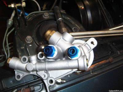

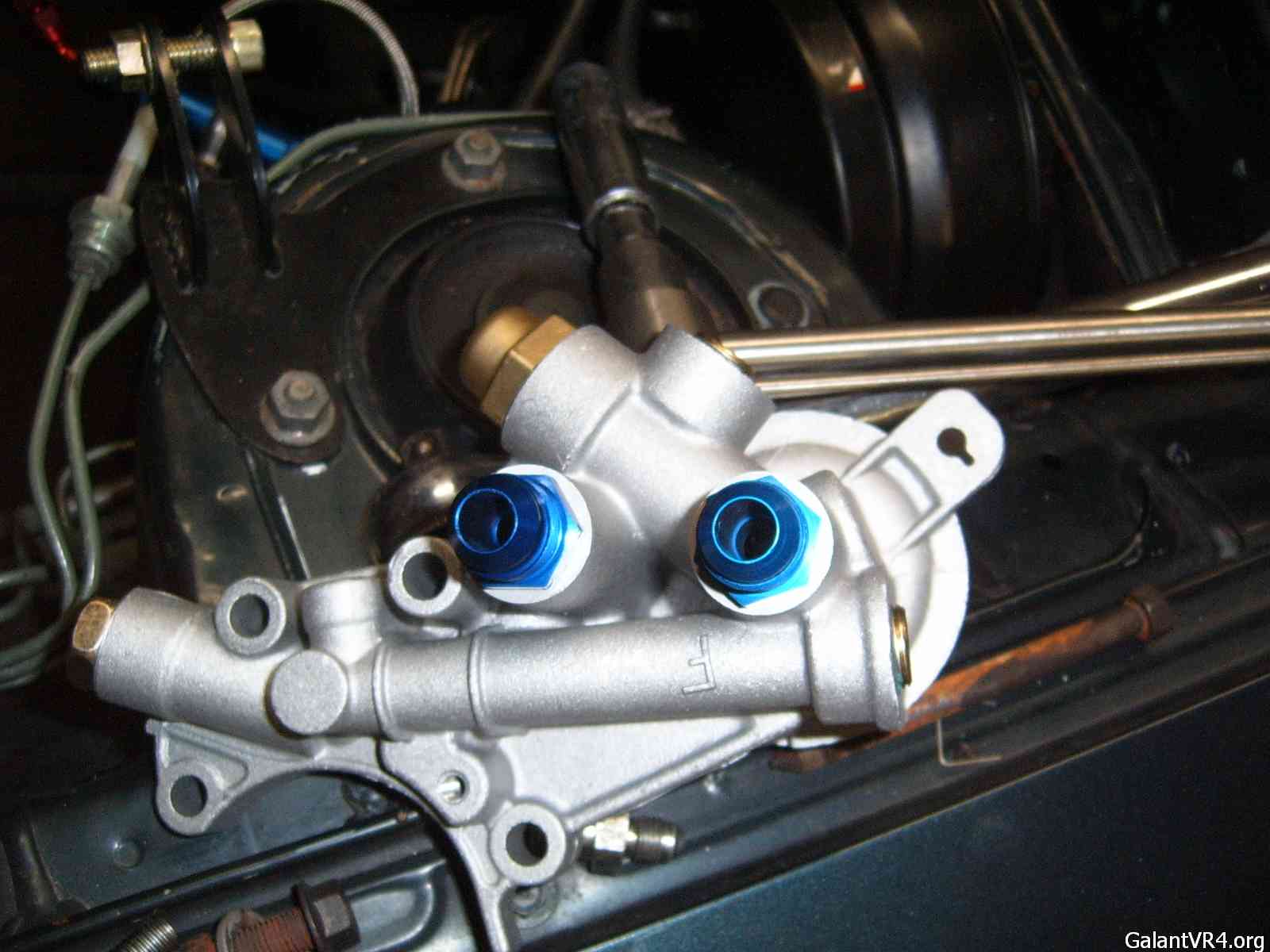

I got this today new from mitsu. It was $65 for the housing and two 16mm to 1.5, -8 fittings. Still waiting for the 13 row mocal cooler tomorrow.
