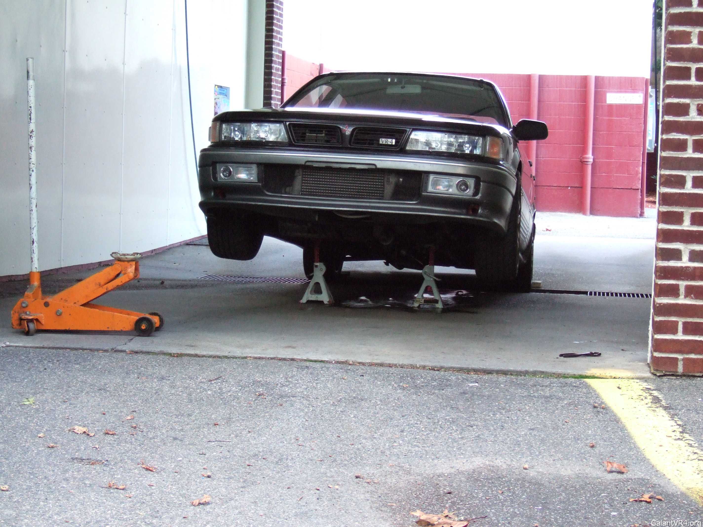

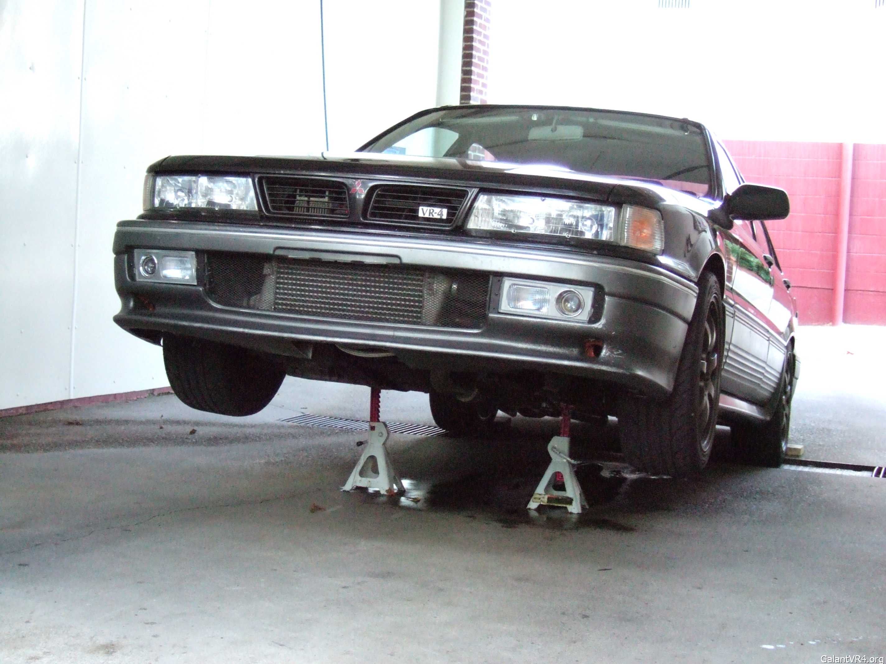

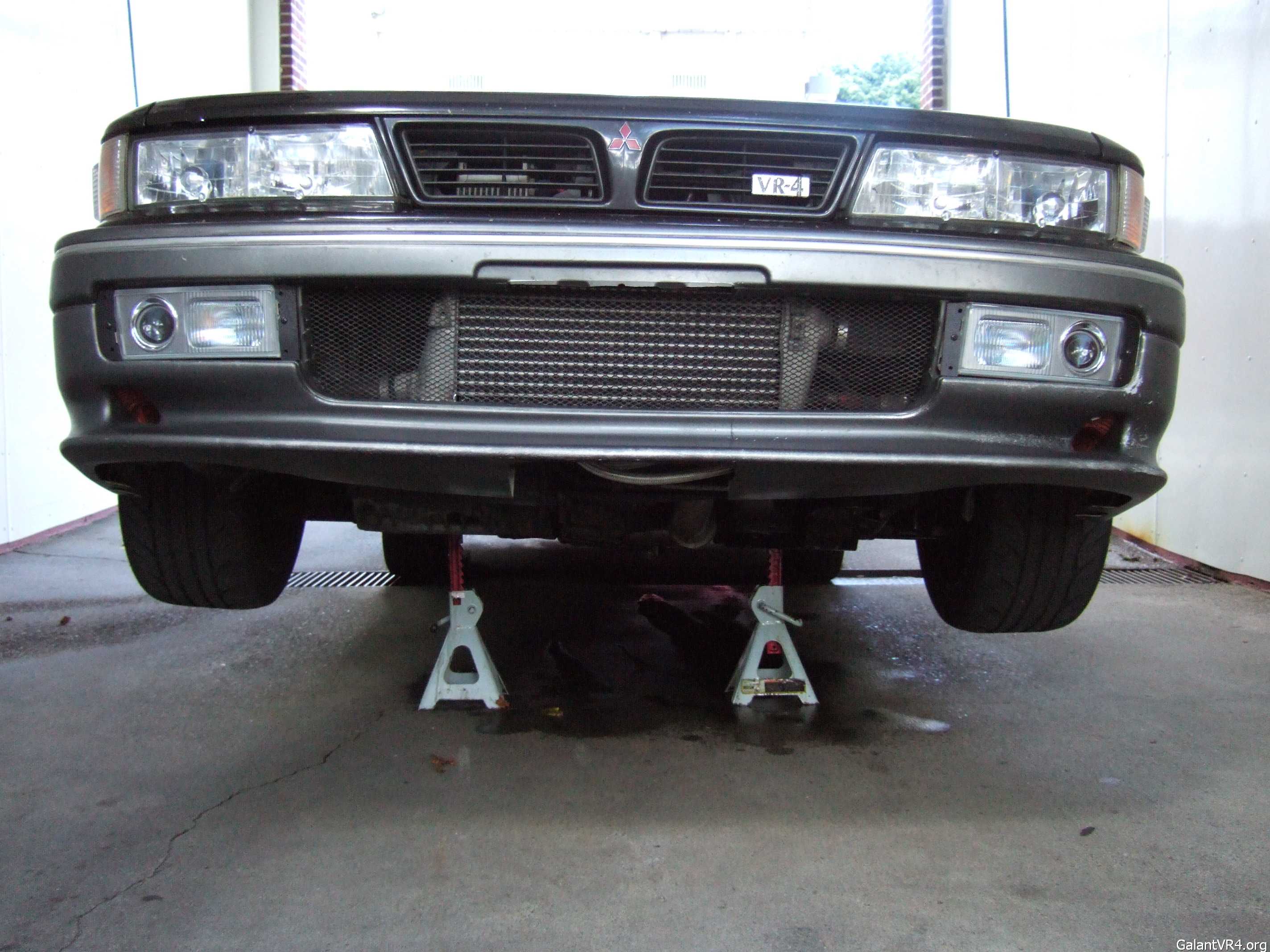

Well, I'm going on 3 entire days now with NO OIL LEAKS! All it took was another filter housing /ubbthreads/images/graemlins/uhh.gif This is the first time in many months that the car is not dripping any fluids on my garage floor. And I've only used up half of the 40lb bag of kitty litter /ubbthreads/images/graemlins/bawling.gif
I'm going to hose the entire undercarriage down (while up on jackstands) with 2-3 cans of degreaser tonight in a local self service wash bay.
JB
Aug 15, 2004
5,836
MA
Your gonna throw your car up on jackstands at the self service car wash? (powerwasher) /ubbthreads/images/graemlins/ooo.gif
Never seen that done yet... /ubbthreads/images/graemlins/rofl.gif /ubbthreads/images/graemlins/applause.gif
Polish
Jan 10, 2005
8,936
NE, IN
Thats not bad idea for those who don't own a power washer.
Cy, take a picture of the other customers as they drive by with the WTF looks on their faces. /ubbthreads/images/graemlins/rofl.gif
Ha Ha, I knew I wasn't the only one who thought of this. You should see the look on the carwash guy's face /ubbthreads/images/graemlins/rofl.gif But hey, the sign says nothing about jacking your car up in the bay /ubbthreads/images/graemlins/rofl.gif /ubbthreads/images/graemlins/rofl.gif

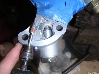

Finished. I used copious amounts of WD40 throughout the process. Pretty easy once you get the correct bit. This one for my Dremel was nice and small, so it fit into the factory hole and slowly enlarged it from there.
CP, or any others that have done this, I see that you wrapped half of the housing with tape to keep metal bits out of the other areas but what kind of solvent did you end up cleaning it with after you were done porting it? Just wd40?
Can I remove that bolt that is at the bottom in this photo? I want to make sure I get all the debris out before I bolt it on and run oil through the motor.
Also, thanks for posting pictures guys.
ktmrider
Sep 10, 2007
3,128
Tempe, AZ
Yup, pull the bolt and the plunger and spring drop right out. Best way to douche everything out.
