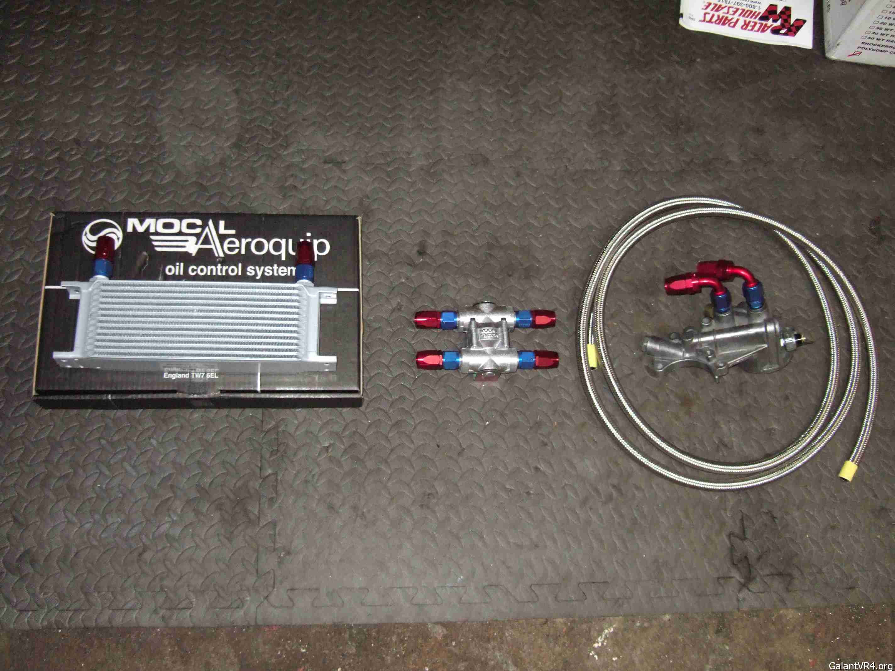

All my parts have arrived. It's a Mocal 13 row cooler, with a Mocal 180* thermostat. I drive this car in the winter, and I don't want the oil to take forever to come up to operating temp if it was circulating through the cooler while warming up. The thermostat opens up at 180* to let oil circulate through the cooler.
I think I'm going to get two more 90* bends to use for the cooler connections. The plan is to mount this thing on the passenger side in front of the radiator, above the intercooler and behind the grill. Does it matter if the cooler is mounted above or below the filter housing (thinking about gravity and oil flow)?
I got everything from Summit for somewhere around $200+. However I got the metric>AN filter housing connections and washers from Machv.

Seriously though, don't worry about location for the cooler. Gravity means nothing when you have +100psi pressure.

I don't like the condition of the 1990 oil coolers that circulate throughout our community, so I went with this NEW one. The thermostat sounded like a good idea, and will aid with quick engine warm-up during the winter. Does it matter where the thermostat is located (closer to the filter housing or closer to the cooler)?
you don't have to worry about position, rather. Location is pretty important, I mean, you do want air to cross the thing.
Cy,
Your setup is v. similar to what I did, but w/o the thermostat. I went with a Setrab similar to the Mocal, about same size or maybe a couple rows wider. It is mounted vertically exactly where you planned. I made a couple aluminum L brackets from some aluminum angle and bolted the cooler in place top and bottom, ran lines along the bottom of the radiator. Cooler is higher than the filter but it may not all drain when changing because the lines angle down a bit to/from the filter housing. I don'w worry about it because I change the oil more often than necessary, so whatever dirty oil remains gets diluted with a lot of fresh oil. Above or below should not matter in operation if that was what you were concerned about. Static head would be around 0.37 psig/ft elevation difference, i.e. negligible resistance to flow under pump pressure.
