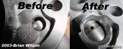

dont forget to port the valve relief port!
i was getting 100+psi cold start and WOT before the porting
now i get 60 - 70psi cold start!
works like a chime!..
